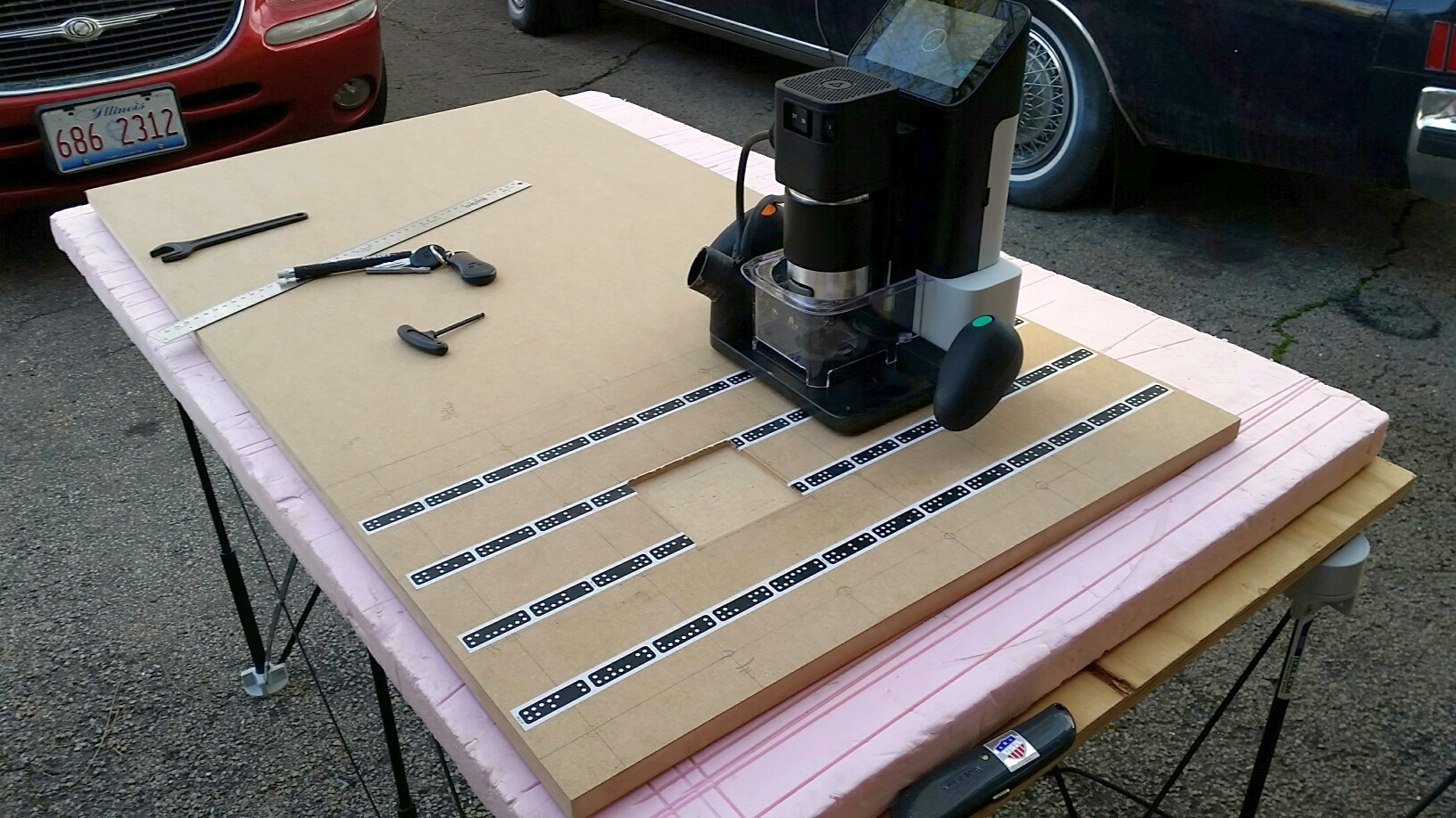

While I have had it for a while I just haven't found the time to actually do a project with it. This one is not a big deal, just a 96mm x 96mm x 1/4" deep cut out at this point. I'll be adding some more features over the next while as time permits.
I love routers and this one is something else. Yes there is a learning curve but I also love to learn new things so away I go. I have several projects lined up but since this one is not really a critical one I can learn without fear of mucking it up to badly. So far it has been about perfect as I imagined it would be.

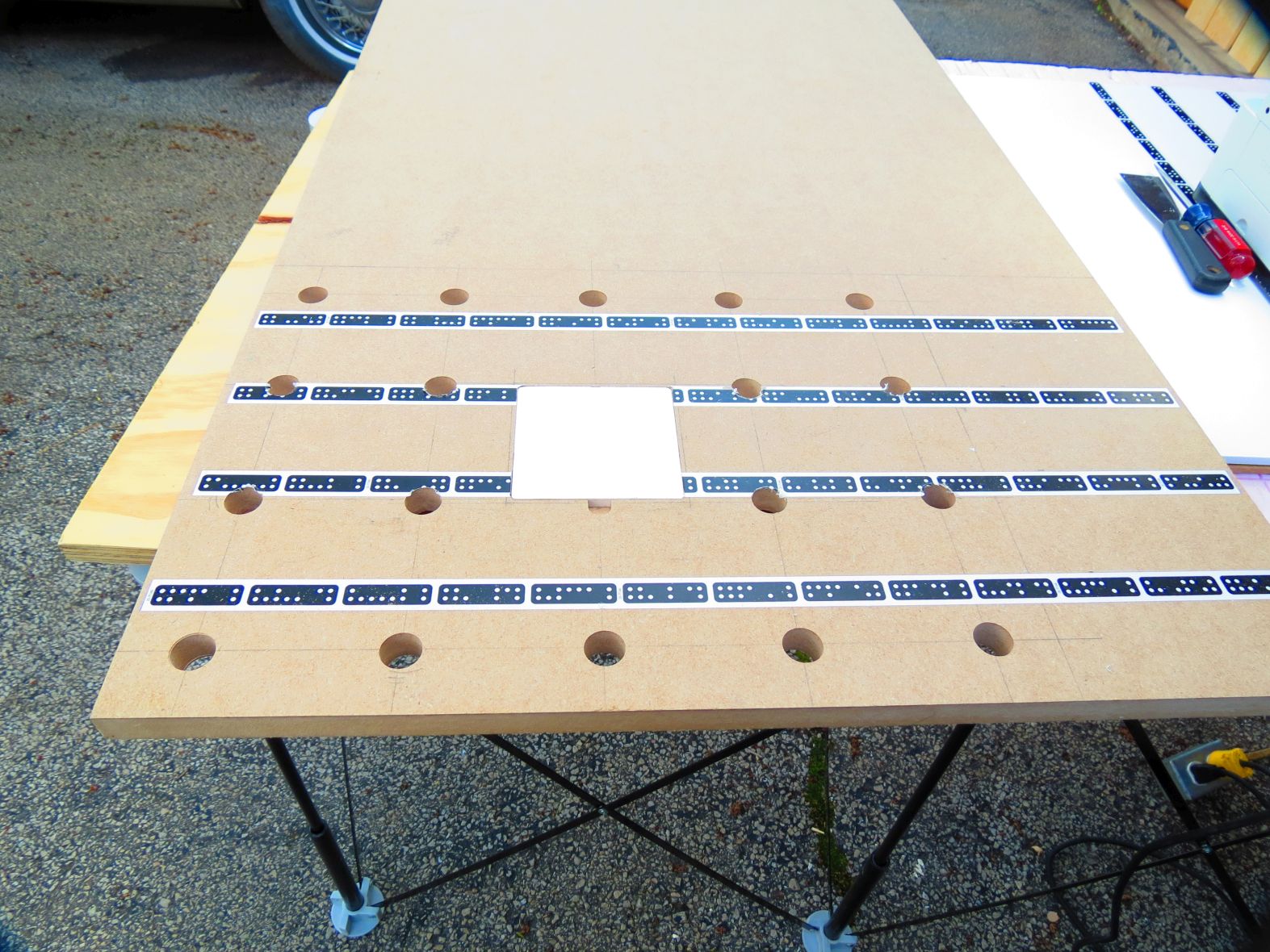

Got to spend some time this afternoon on my project. Keep in mind I'm using just the onboard tools and no cad software at this point. Today I wanted to add the 20mm holes and then cut the plugs for the center insert.
The tool has the ability to create a grid by touching off three places, two along one access and one along another axis. Then you can have points to reference to, in my case 1mm. So the layout I did on the machine will be done to a 1mm reference. I expect there to be some error in the pattern but since this has a life as a drill press top I'm expecting to use the holes for clamping elements and the like so if it is not quite up to MFT standards that is fine.

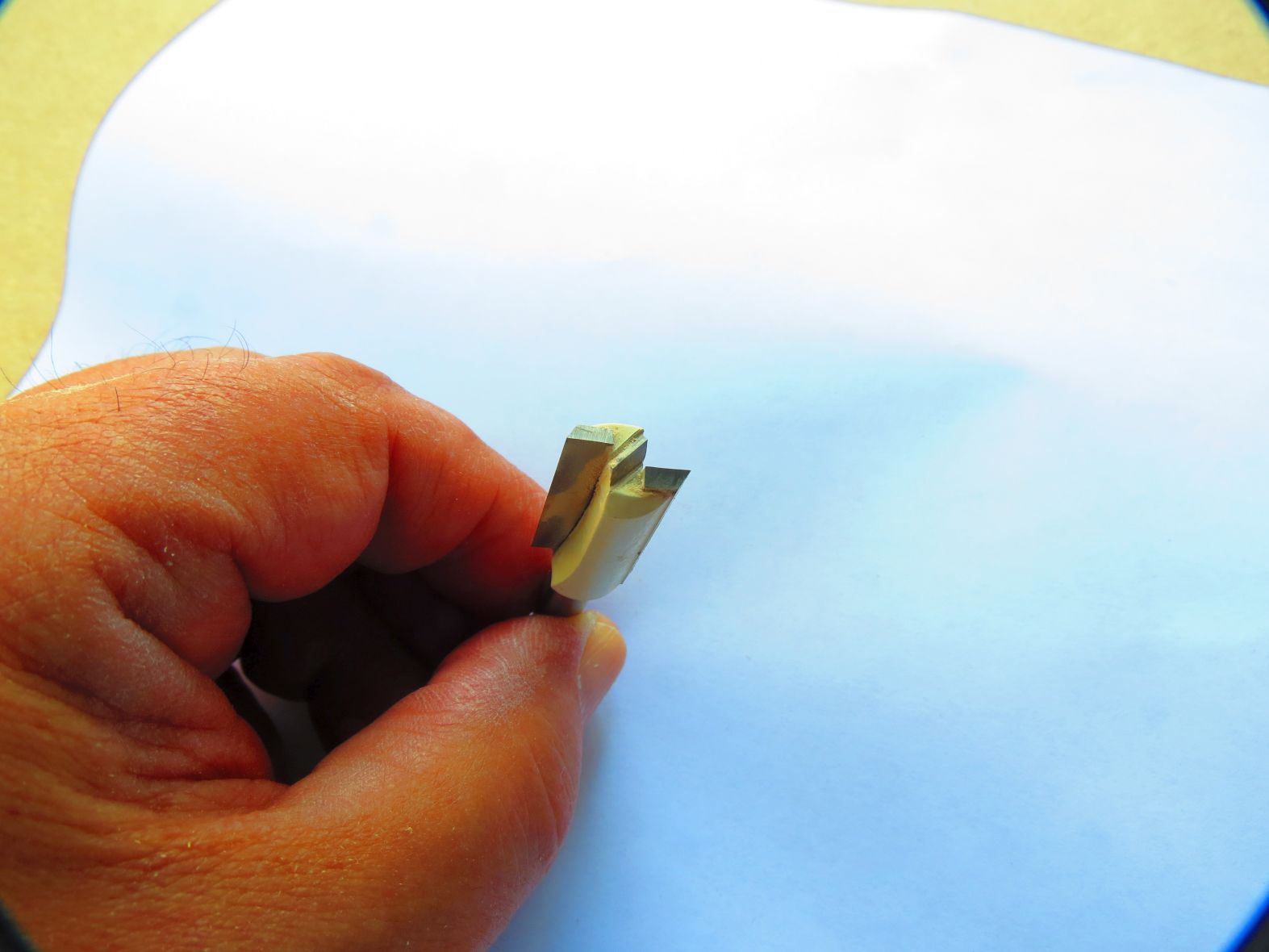

The bit you need to use to take advantage of the Helix Mode is a plunge bit that will work within the corrective area of the SO. In my case I had a 1/2" bit with the plunge tip. This is what it looks like:

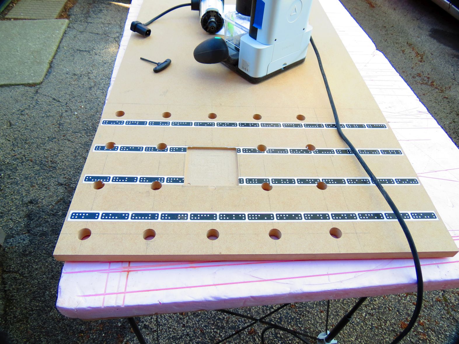

The top is now all "drilled" and looks like this:

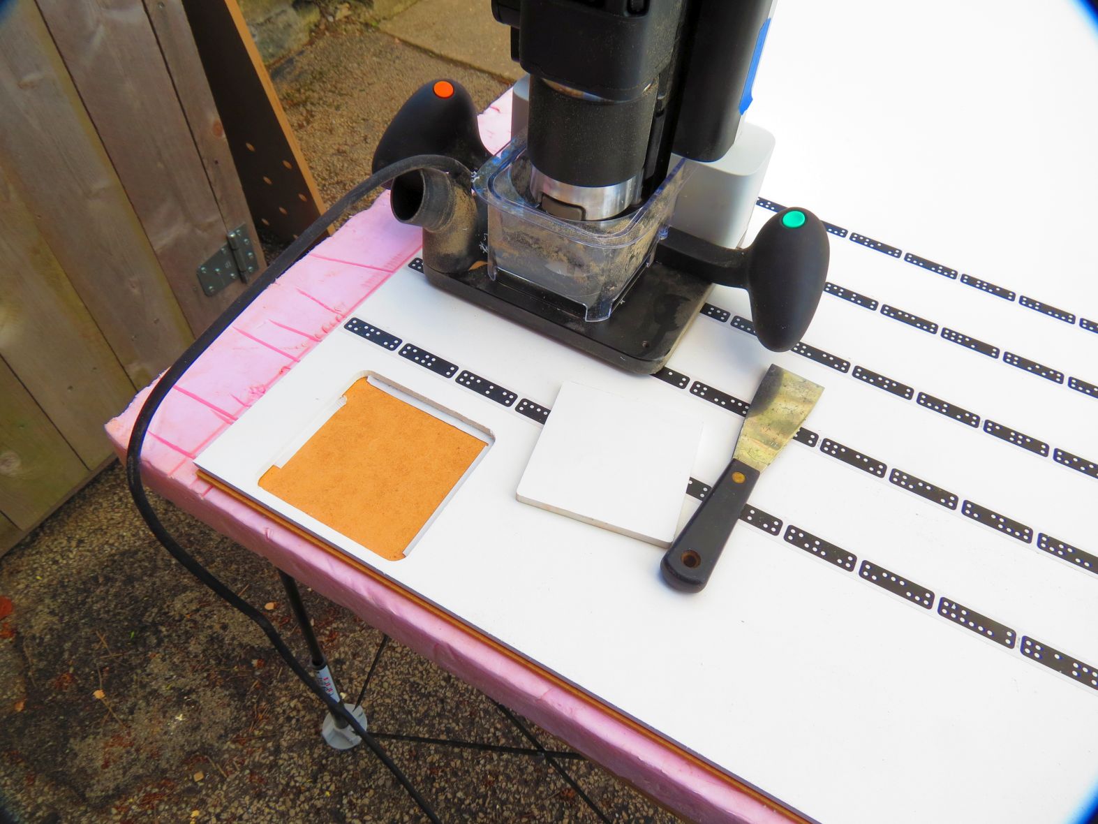

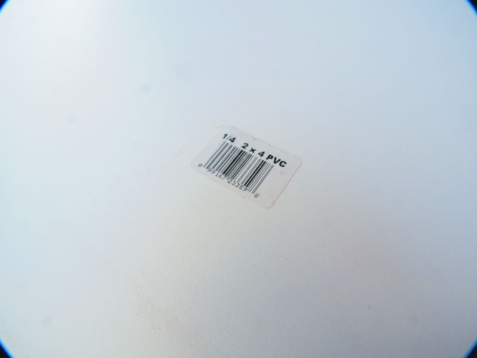

For the plugs I went with a new to me material from Home Depot. The label calls it PVC and in comes in 2' x 4' x 1/4" sheets. They have some other thicknesses but I wanted the 1/4". The 1/4" is really 1/4" so this was the reason I wanted a chance to play with it. I use to get MDF that was pretty close to right on 1/4" but the two places were I got it no longer carry and the third place has thin MDF not even close to the 1/4" they call it.

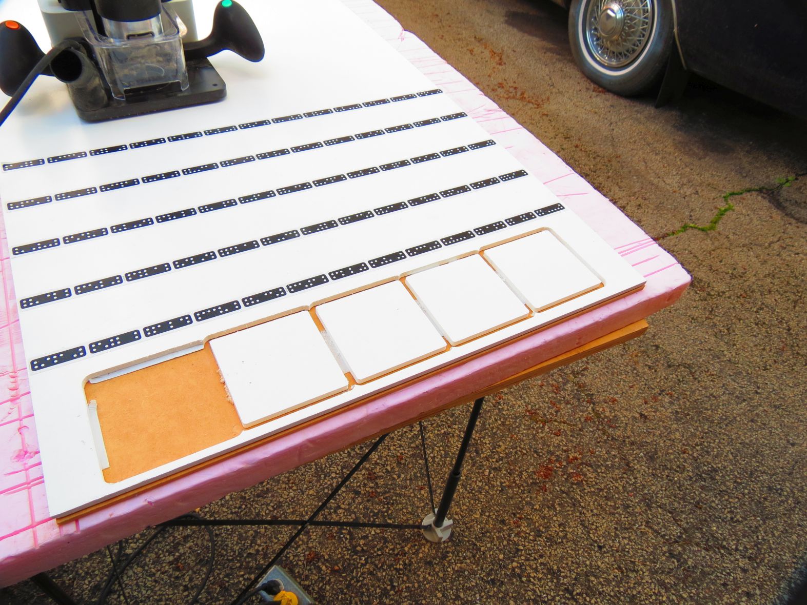

I used some double sided tape to stick it down before cutting them out. I did one and then checked to see if it fit and here is a shot of that.
Again I used just the onboard tools to do the design, not that it is all the difficult. Once I had checked the fit I then copied the piece and repeated across the width of the PVC.
This is the top as it stands now:
I will use a guided saw system to cut it out but I have a couple of things to do yet while the tape is still in place.

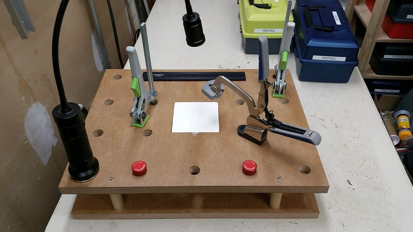

I had a little time this evening and for the most part finished the project. Yesterday I cut the top and bottom out with a guided saw system. I could have used the SO but it would have been slow and added wear to the router bit.

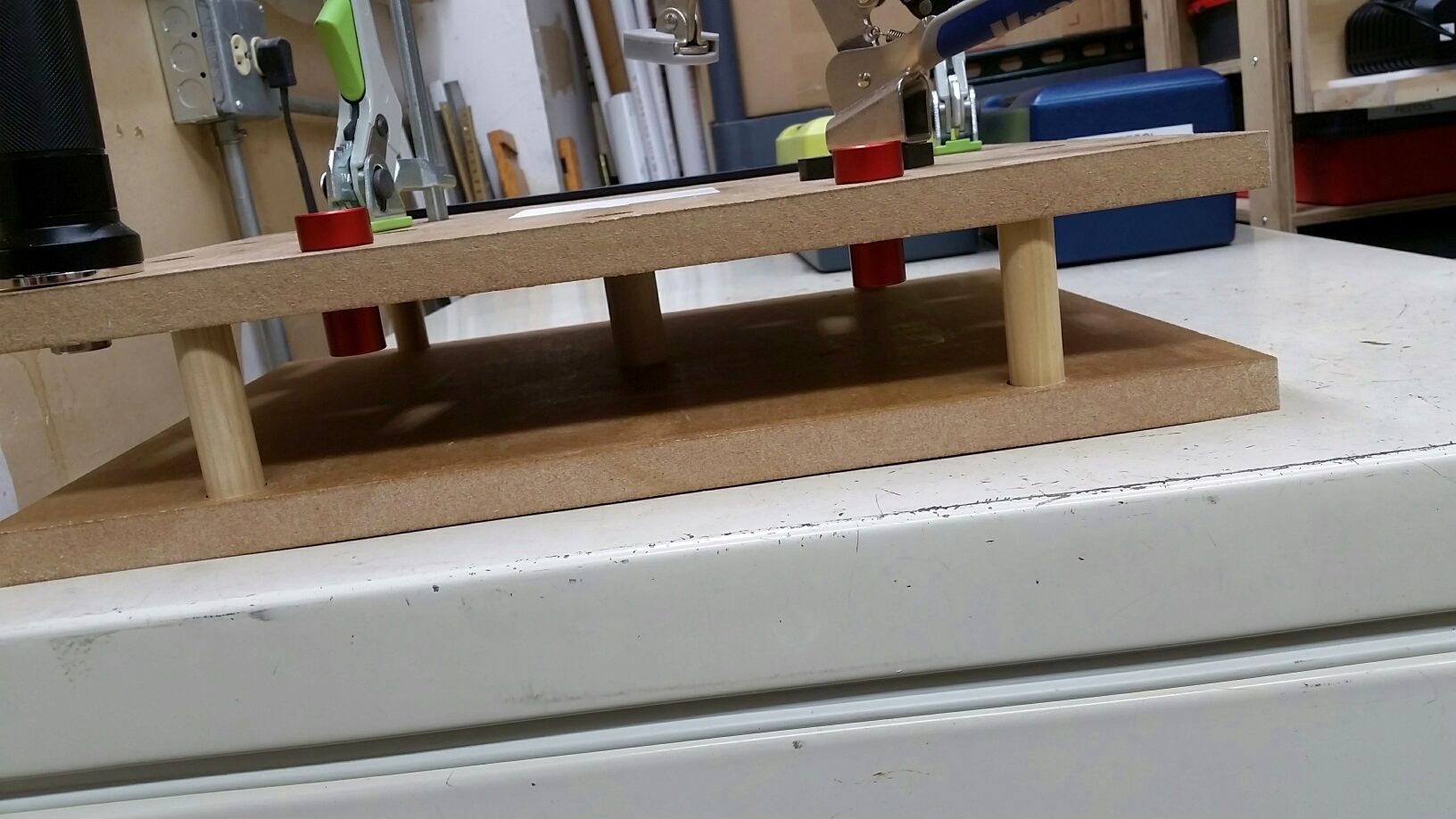

The underside of the top has 4 holes, 1/4" deep for dowels, I wasn't sure how close the top and bottom would work out and perhaps I was a bit to cautious but I made the holes oversized to make sure it would fit..... may be next time I get brave.
The bottom has the same for holes and yes I did them slightly oversized as well. It also has hole right in the middle/center of the table. This takes a dowel as well and is designed to take what ever load might occur when drilling it the center. It is not glued or other wise fastened so it can be replaced if at some point it is damaged badly by drilling into it.
The spacing between the top and bottom needs to be minimal but I wanted to be able to use festool clamps and still reach in to tighten clamps etc. So I decided on 2-3/4".
Again you will note the center of the table is the center, while it is not going to be the center of drilling while used on the drill press it's OK not to be. Another reason for this is that I can use it as table for hand drilling where being centered is an advantage.
I grabbed out a few dogs, and clamps and other 20mm hardware to show how it looks with stuff on it.
I also did a shot so you could see under the top table and how the dowels work. By using dowels it minimises the places where clamps will not work.
