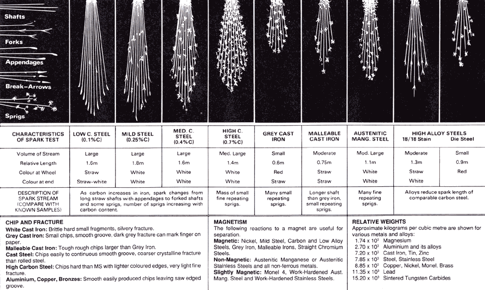

In addition to the file test I cited above, you can use a portable or grinder / spark test to visually roughly indicate the metal carbon content. Here is a chart from a post in Welding Tips and Tricks Forum. It is helpful info. There are a series of Spark Test YouTube videos out there as well. Chemical test will tell you the exact metal you are working with, and that can be necessary to know in specialized repairs.
I am just replying to the new term to you “Weldable Metals” and trying to give anyone who has welding questions some places to go for more info.
Everett
Spark Test from a Welding Tips and Tricks Forum post.png (256.94 KiB) Viewed 2614 times
