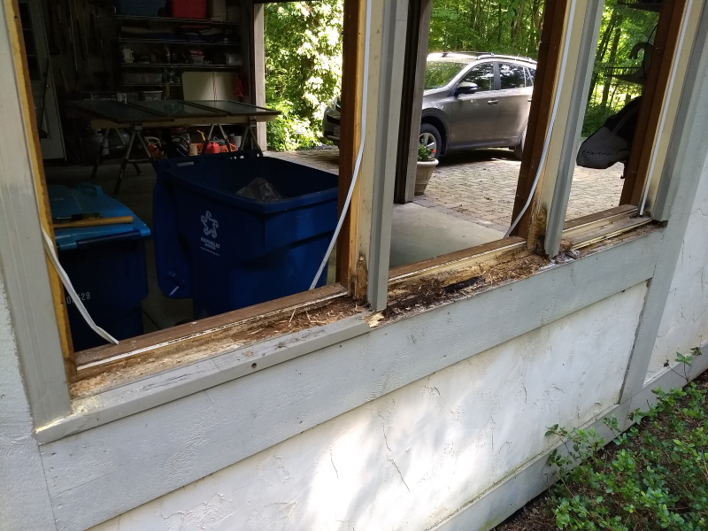

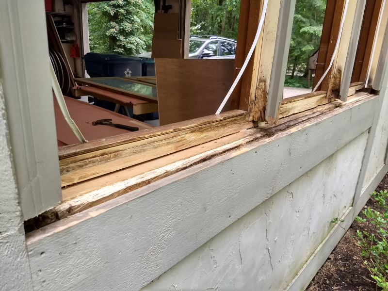

After almost 28 years, most of the double-pane windows in my house were losing their seals, and a few were fogged so badly that you could hardly see through them. The exterior wood trim was in need of new caulk & paint as well. So the first order of business was to have the windows reglazed. The window frames are wooden, and I knew that there were a few sills with rot problems. Back in 2009, I had ground out any soft spots that I could find, filled them with epoxy putty, and repainted them. It turned out that sills were all still good underneath the operating windows, where I had been able to access them for repairs. But several windows had minor rot problems underneath the stationary sashes. A bit of scraping and putty fixed most of them, and two more had enough damage to warrant epoxy filler.
But then, the window installers pulled out the sashes in the garage window (which were to be replaced with new ones), and came running to see if I had some insecticide. Yikes!
The first photo looks especially disgusting, as I had liberally doused it with insecticide before taking pictures. But yes, that is a big fat insect larvae you see amidst the rot .. and it wasn't the only one.
Rotted sill.JPG (499.94 KiB) Viewed 32079 times
Last edited by BuckeyeDennis on Mon Jun 11, 2018 10:49 am, edited 1 time in total.

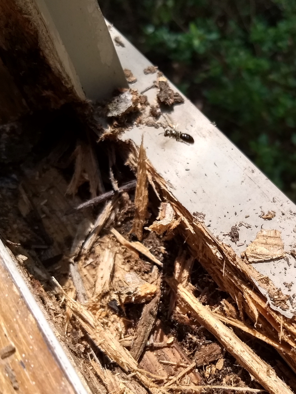

With the insects poisoned, the next step was to dig into the rot, and see just how extensive it was. At first, I wasn't optimistic that the window could be salvaged.
Debridement I.JPG (475.98 KiB) Viewed 32070 times
I attacked the rot with old hand chisels, just using hand pressure to slice out the worst of it. The sill itself was trashed, but amazingly the 2x4 running horizontally underneath the window was unscathed.
While I was chiseling out the rot, some insects kept flying up looking for home .. you can see one of them in the photo above. With Google's help, I ID'd this one as a carpenter ant. The original problem appeared to be the rot, and then the insects had chosen the rotten wood for home. But the insecticide that I used will take care of any that might try to move back in.

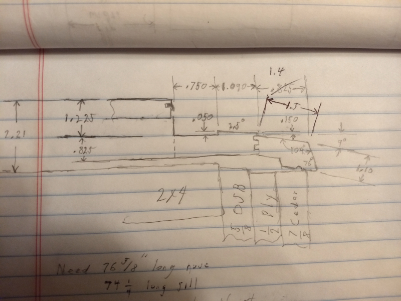

It turns out that the geometry of my window sills is quite a bit more complex than I would have imagined. The dimensioned sketch below shows the measurements that I took of the old sill. The vertical dashed line (beneath the window stop and weatherstripping) shows where I cut the old sill away. Everything to the right of that line needed to be remade.
Sill dimensions.JPG (335.96 KiB) Viewed 31989 times
I don't know if this is proper terminology, but I'll refer to the two pieces as the "sill plate" and "sill nose". The "nose" is the more steeply sloped section, shown on the right side of the glue joint.
For the replacement parts, I took a few liberties with the geometry:
a) I made the sill plate thick enough to attach to the 2x4 underneath the window,
b) I eliminated the 0.050" deep groove atop the sill plate -- the window installers said it was unnecessary, and it seemed that it would hold any water that seeped past the weather stripping on the sashes, and
c) I left the new sill nose piece a constant 1.10" thick all the way back to the glue joint.
As for the joint between the replacement sill pieces, all I really needed was something to hold them in alignment for gluing. So a spline, some biscuits, or a tongue & groove joint would have worked just fine. But for that 9 degree slope on the nose, I needed to tilt whatever cutter relative to the table, and I had all the Shopsmith shaper stuff I needed to mill a glue joint. So I figured I might as well put it to use.

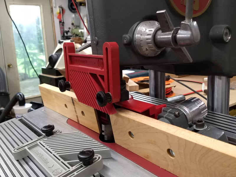

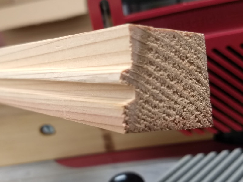

This being my first experience both with the shaper hardware and with milling a glue joint, I was basically guessing at the best way to set the infeed and outfeed fences for a glue joint. The fences were rock-solid once the adjustments were locked down, but had a bit of wiggle/play when unlocked for adjusting the depth. So I decided to set both fences co-planer, and leave just a bit of each workpiece uncut, to guide on the outfeed fence. That way, I could use a long straightedge to ensure perfect fence alignment. This worked very well for feeding the workpieces, but the glue-joint fit was less than perfect. More on that later.
The actual milling process went just swimmingly. Given the relatively low top speed of my 520 headstock, I was expecting the cut to look and feel a bit rough. But I was pleasantly surprised to find that the 520 made a very competent shaper. The cut felt, sounded, and looked nice and smooth. The featherboards kept the workpieces locked down tight, and the operation felt perfectly safe to me.

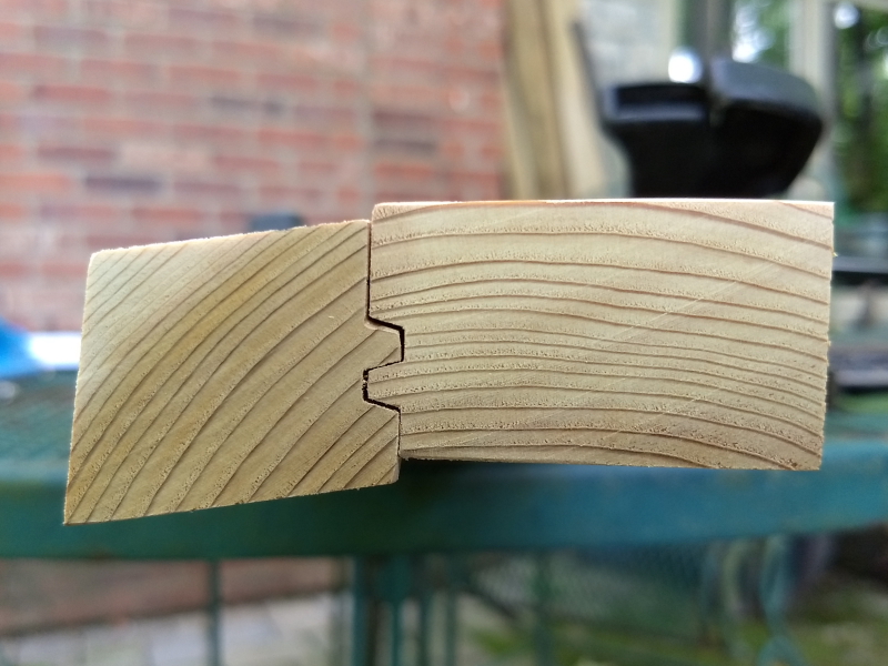

The pic below shows the result of the cut. Note that the slight imperfections on the edge of the smaller glue-joint ridge are not from the shaping operation. Those are saw marks from ripping in tablesaw mode; I intentionally left that edge untouched by the shaper cutter, to guide on the outfeed fence.
Pretty nice glue joint.JPG (306.25 KiB) Viewed 31982 times

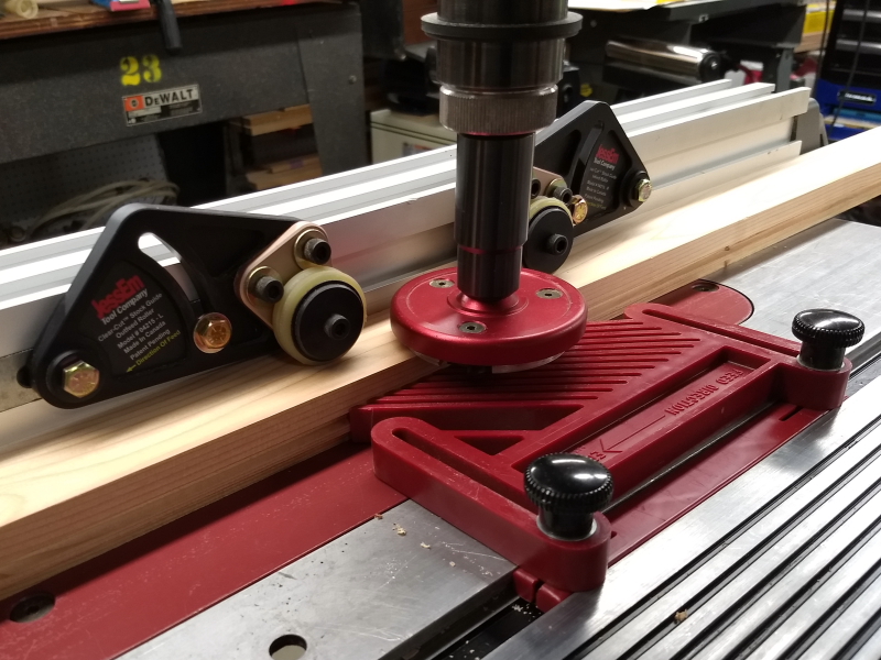

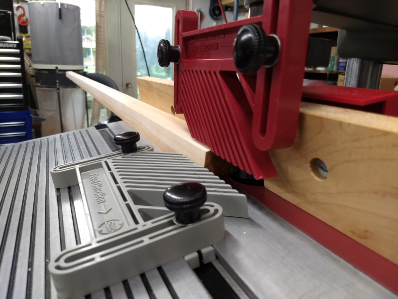

To mill the mating glue-joint profile on the window sill plate, I set the table tilt back to zero degrees, and ran the blank past the glue-joint shaper bit upside down. The workholding was all the same, but I did adjust the bit height to get the proper (0.150")reveal of the sill plate. That's actually trickier than it sounds, as the centerline of the cutter profile is in the middle of one of the diagonal segments. The only square references are the top and bottom of the cutter profile, and those are outside of the cut.
The next step was to mill that 2.5 degree bevel atop the sill plate -- again calling for a tilting table. So back to the 520 I went. The bevel feature is a bit over an inch wide. The largest flat-bottomed router bit in my collection was just 1" in diameter, so this looked like a good chance to play with my vintage Shopsmith AK-2043 rotary planer. It's basically the same as a Wagner Safe-T-Planer, except that it sports two edges per cutter, so you can quickly rotate the three cutters to get fresh edges.
The rotary planer is almost 3" in diameter, and the quill-mounted featherboard from the shaper-fence kit wouldn't clear it. So I needed an different way to hold down the workpiece for this operation. A featherboard on a tall fence extension would have worked fine, but I've never drilled my shop-made fence extension for featherboard mounting. So instead, I grabbed the Jessem Clear-Cut Stock Guides off of my router-table fence, and tried them out on the 520 fence. The wheels are angled in slightly toward the fence, so they not only hold the workpiece down, they also keep it tight to the fence when feeding. Each wheel has a one-way clutch, so they provide kickback protection as well. The featherboard in the pic below isn't really necessary, but the belt-and-suspenders approach made me feel more comfortable using a cutter this large. Note that this view is from the backside of the 520, so the feed direction as shown is from right to left.
Rotary planer.JPG (398.81 KiB) Viewed 31838 times
The Jessem guides normally mount to T-track using a T-bolt, but of course you have to use the special Shopsmith T-nuts on a 520 fence. Instead of fooling around mounting threaded studs to the SS T-nuts, I just used 1/4-20 hex bolts of the appropriate length. Referring to the guide on the left in the pic above, the left-hand bolt normally locks the fence laterally, and acts as a hinge pin for elevation adjustment. Using the SS T-nuts, that bolt does not lock the fence laterally, but it still provides the hinge function. Then when you tighten the other bolt, it locks the guide down both laterally and in elevation. This worked out fine for me.
These Jessem router guides retail for $100, vs. $250 for Jessem's tablesaw guides. Mounted directly to the 520 fence as I did, the maximum stock thickness is a bit over an inch (mine in the pic is 1.1"). But it would be easy to make a carrier that raises the guides to whatever height you may need. The Jessem router guides worked great in this application, and the bevel milling went off without a hitch.
