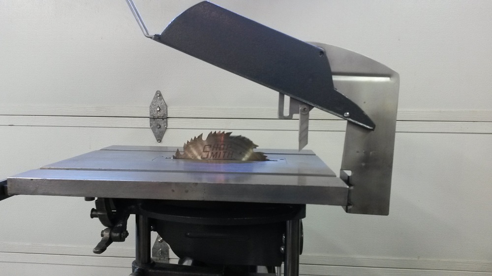

Interesting as the 10ers came with the upper guard - but not the lower, and I have fitted mine with a Mark 5 lower guard - but have never got around to installing the upper guard.

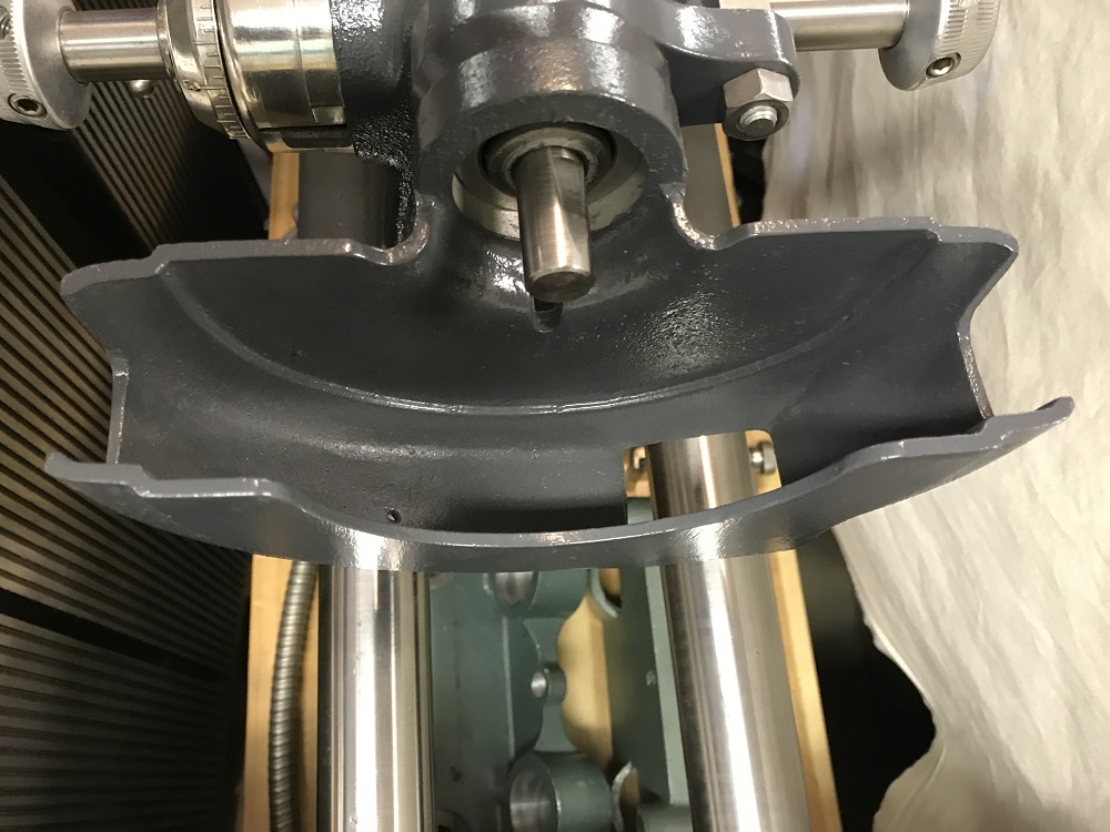

Is this the Mark 5 guards you use on you 10ER? I find these make a great set for use on the Model 10's. When setting up the blade on the Model 10 5/8" Arbor I put the machined washer on first followed by the blade than the machined spacer and nut. This gives the needed spacing for the lower guard.
The Model 10's did have a lower guard available as an accessory but they are very rare. Below is mine. Yes for anyone noticing that is the "A" & "B" SPT Brackets below along with a Flexible Shaft on the bench.

Hi Russ,chapmanruss wrote:Ron,
Sorry for the delay in responding, we were away all week camping.
Yes that looks like the one I use, but I only have the lower part. I had to remove the end plate as on mine as it made it "just" that much to wide and the blade wouldn't center in the slot. I should take 1/4" off the edge and that would fix it. Skip Campbell used to have a page on his MKCtools website to show the mod, but I can't find it now, I guess he took it off now that he is selling one of his own design.
I have seen pictures of the OEM lower guard, but as you say they are very rare, and I don't foresee ever owning one myself.chapmanruss wrote: The Model 10's did have a lower guard available as an accessory but they are very rare. Below is mine. Yes for anyone noticing that is the "A" & "B" SPT Brackets below along with a Flexible Shaft on the bench.
I have seen various DIY guards posted on the web. At some point I want to try making one from an old pot.
