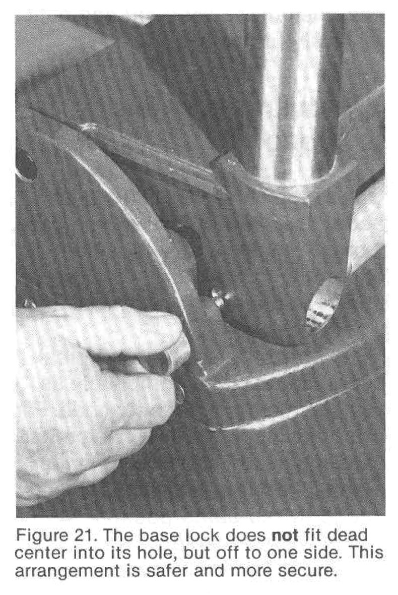

Is the base lock knob fully retracted?
- Shopsmith_500_Summary_Manual_Figure 21.jpg (284.61 KiB) Viewed 6073 times

I hate to point out the obvious, but I forgot to remove the extension table once. The machine would only raise a little.

agleason wrote:I hate to point out the obvious, but I forgot to remove the extension table once. The machine would only raise a little.
This was my first (only) thought as well. If there is anything installed where you would mount an extension table - remove it.

I am guilty of that one as well.agleason wrote:I hate to point out the obvious, but I forgot to remove the extension table once. The machine would only raise a little.
