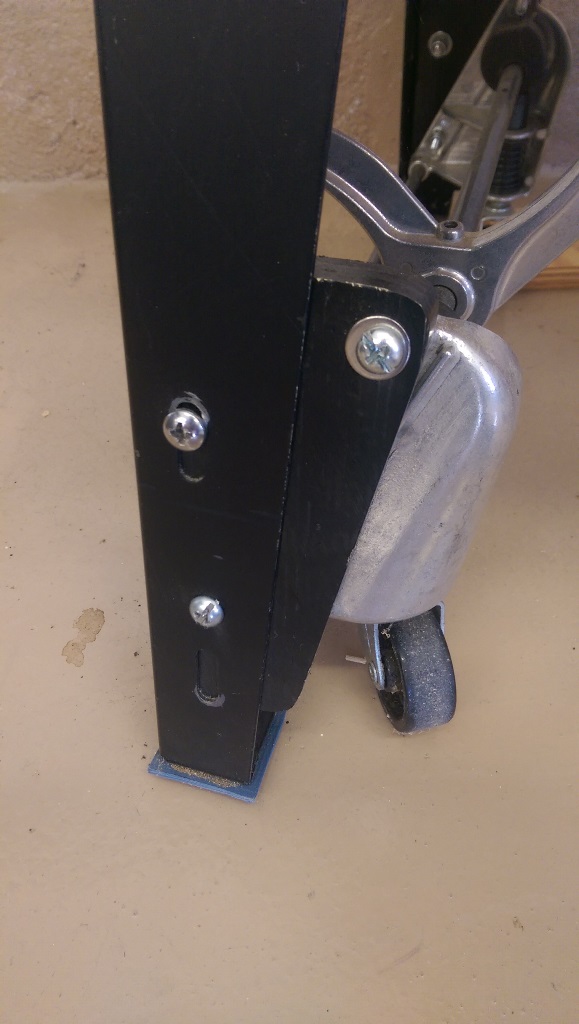

Mounting hardware (spacers. screw lengths).

As Ron said it is the mounting hardware I think. I have never seen a set but I made the required mounting adapters from 1/2" (I think) Baltic birch. It was all done by trial and error since I have never seen the real thing but they work perfectly. The scroll saw legs are at a different angle than all the other SS stands/legs. Actually it is the bolt holes I guess due to the thiness of the legs. They will bolt up but the castor stems are not vertical to the floor so they don't rotate properly.
If you want more pictures just let me know.

Problem Solved: While wondering around in Home Depot this past week I ran into a display cabinet that was full of all sorts of wheels and casters. It wasn't long until I had four 2" double lock casters in my shopping cart. For less than $8, I now have a rolling scroll saw.
With the casters, the work surface is about 1" - 1 1/2" higher than it was but I can deal with that. When scrolling, I sit on an adjustable height stool.
