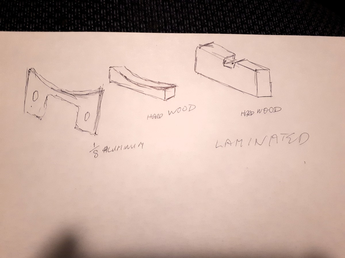

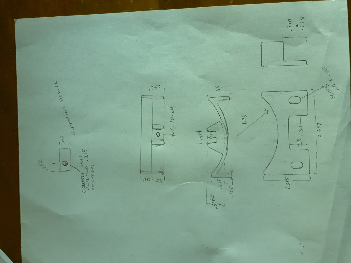

Note, the person who needs the part, not Tom, first posted about it back in May on the Facebook Shopsmith Owners Group. At that time I removed mine and made tracings of all the faces with dimensions and sent them to him with pictures of the part and also a sketch of how to make a simplified version from aluminum plate and wood. Maybe an hour to make. This week he posted on the Facebook group again, I think he hopes someone will make it for him so he won't have to do it himself. :rolleyes:
