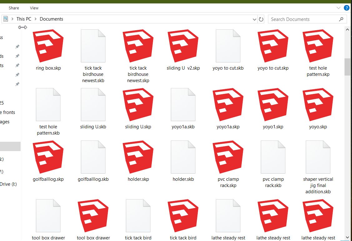

But on to the situation at hand. You go to the area where your files are stored and depending on how you have it displayed you will see something like this:
ScreenHunter 85.jpg (106.04 KiB) Viewed 8037 times

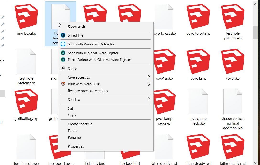

As you can see the backup files are not associated on this computer. So if I want to use that file with say sketchup I can right click on it and it brings up this:
ScreenHunter 86.jpg (98.83 KiB) Viewed 8037 times

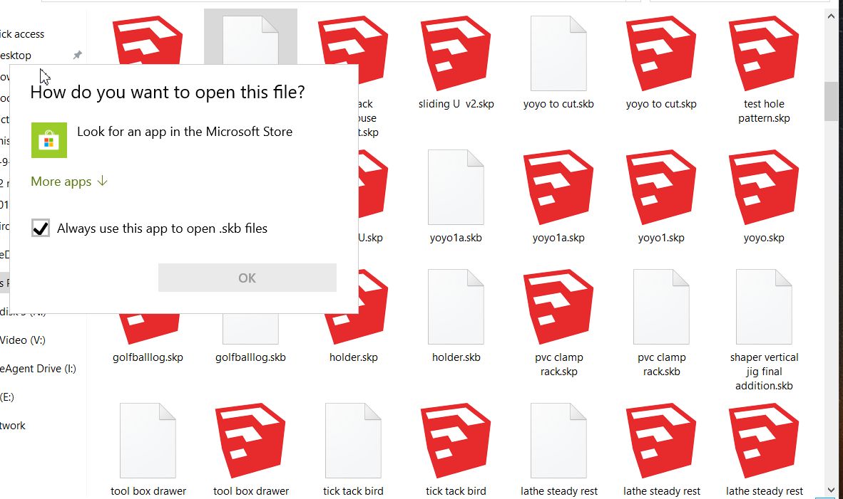

The box allows you to search for an application but since we already know what we want to use the next line down has " More apps" so clicking that brings us this:
ScreenHunter 87.jpg (100.84 KiB) Viewed 8037 times
Then on the bottom is the sketchup association that you want. Keep in mind that the check box when checked will set this as the default, if unchecked it changes nothing except for this one time.
This does not change the file but just the association of that file extension.

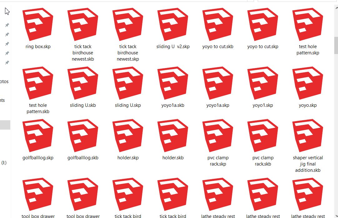

So if you check the box to change this association for all of these back up files then every time you double click the files they will open with sketchup. One little oddity is the first time you do it you have the option of using sketch up or searching for another application, if you pick sketchup then it becomes set and look at what happens to the files:
ScreenHunter 89.jpg (120.53 KiB) Viewed 8037 times
Which then makes it up to you to pick the real file rather then the backup.... perhaps a bit more confusing??? So you might not want to make that a "thing".
