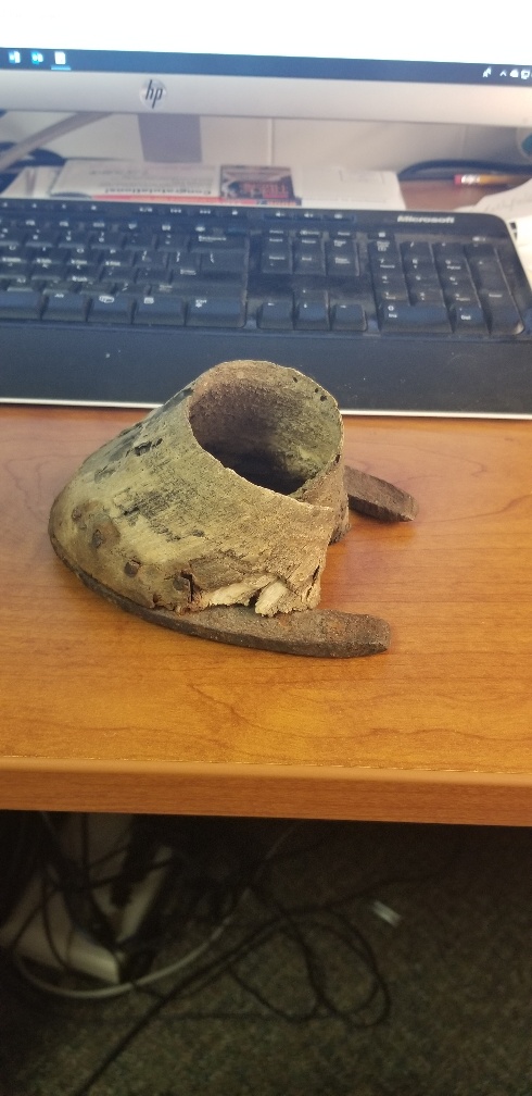

Yes, the histories can be mind boggling. I found this in my office attic when I cleaned it out 35 years ago! What was it there for? My grandparents did have a stable early on!
- hoof.jpg (152.53 KiB) Viewed 13122 times

LOL Must have been special to some one ?
We found a pair of ladies shoes from what we believe to be from 1915 and a news paper from 1915 that had a story of opening the Panama Canal. we believe the shoe to be the same age as the paper since they were together .
Nothing like a horseless shoe still on the hoof lol but still pretty neat history .
