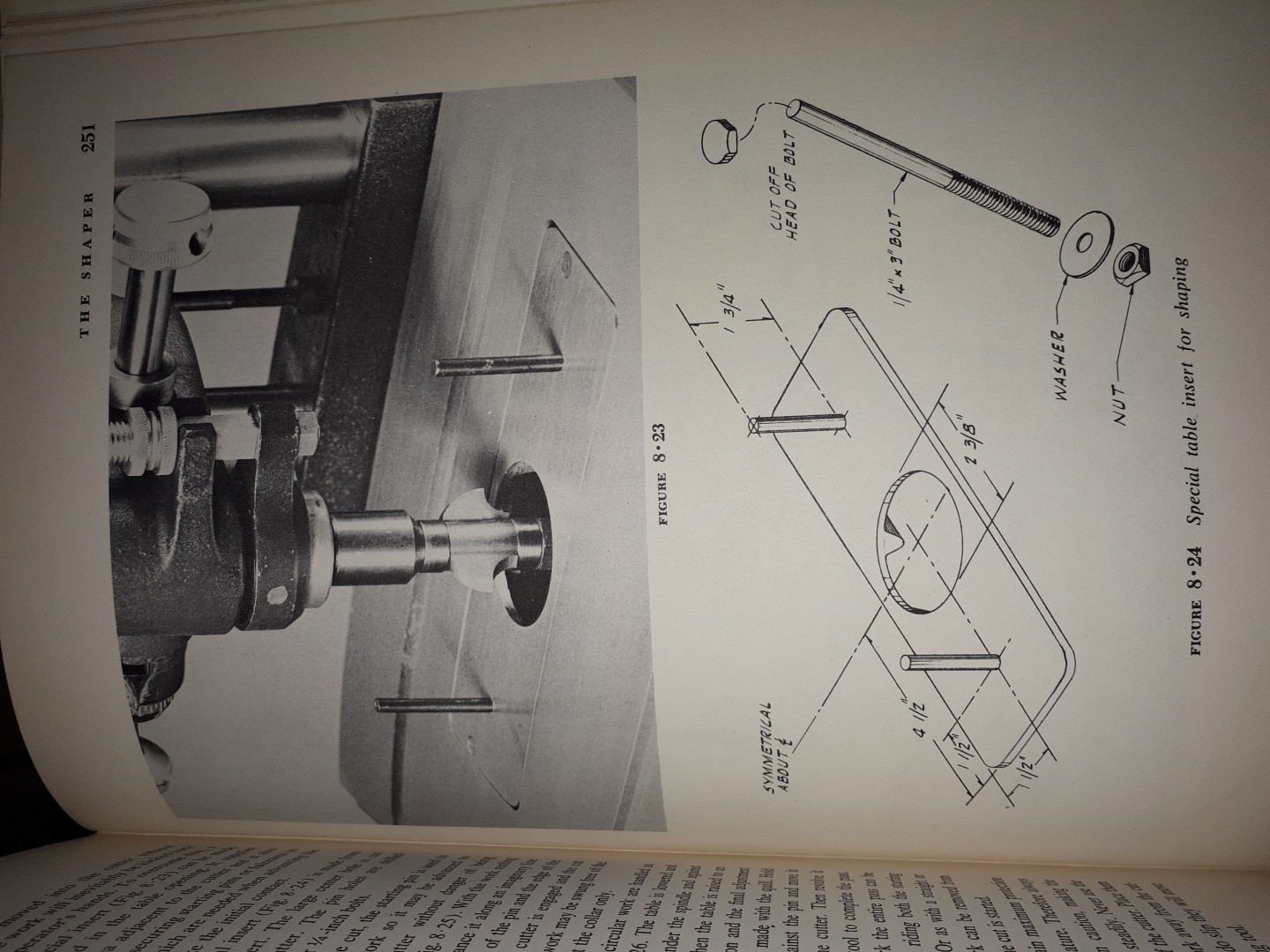

There is a drawing with dimensions for a Shaper insert in Power Tool Woodworking for Everyone.

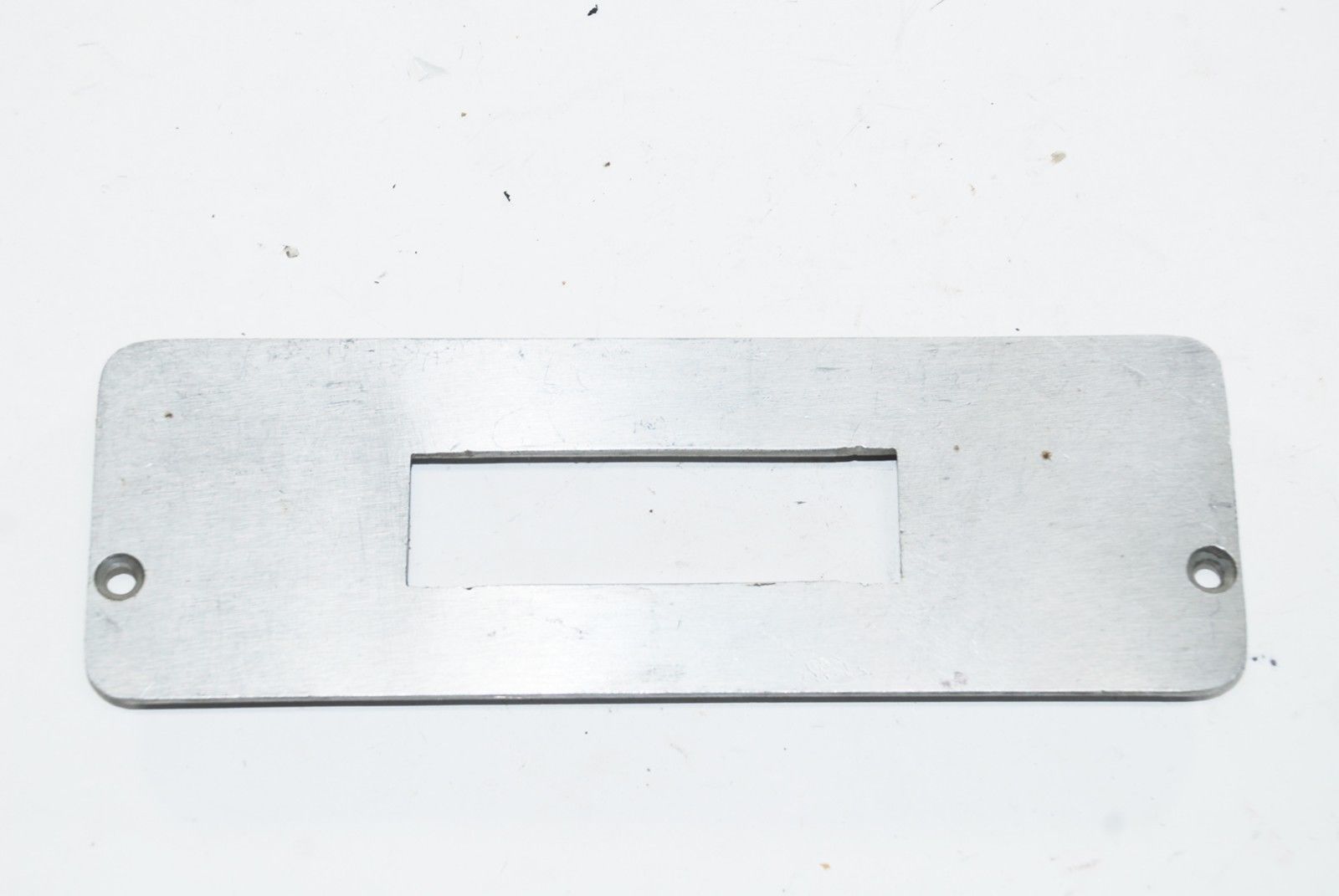

I saw this one listed on eBay. Maybe it was shop made and not from Shopsmith.
Tom
Tom
- molder insert.jpg (75.22 KiB) Viewed 16613 times
Re: 10 ER Molder Insert
Looks like the Dado insert, but with a shorter slot. Perhaps someone cut it from a blank insert. Here is a link to a different accessory catalog. it also says to use the Dado insert.e2512 wrote:I saw this one listed on eBay. Maybe it was shop made and not from Shopsmith.

Just spotted this listing on Ebay, for Mark 5 Moulder insert, similar to the picture you posted. (Over priced in my opinion)
https://www.ebay.com/itm/Shopsmith-Shop ... Sw95lbBGdp
Perhaps one of these was modified to fit the 10ER, per Skip Campbell.
http://www.mkctools.com/mkvinsert10er.htm
Sorry I don't have one to measure, but could you extrapolate the the slot length from the one in the picture you posted.

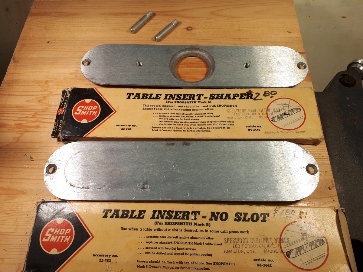

I agree with you about the three table inserts on ebay being over priced. Buying the two Shopsmith inserts new would be just under $65 and I do not know what the one in front goes to. It looks like some other tools dado insert.
As far as using an insert for moulding on the Model 10's the dado insert will work fine. It has just a bit more open space before and after the cut. No need to get or make a custom molder insert. If you insist on making one, HogWinslow1960 on eBay makes his replacement inserts out of 1/4" thick aluminum and they are very durable. He make a blank one if you want a head start.

I picked up a couple of Mark 5 inserts, one blank and one of the shaper inserts with the stepped hole, never used still in their original boxes, last year. The seller was also in Canada and I got the two of them for just under CDN$30 including shipping. Some day I'll cut them down to fit the 10ER.
