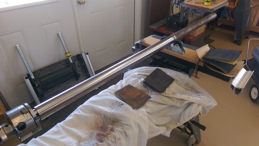

Re: A lot of general set up maintenance questions
Here is a picture of what you want your 10ER tubes to look like. These were done starting with a VERY light touch of 320 grit. Then 400 grit followed by 600 grit and then 0000 steel wool. Then Johnson's paste wax. There is no reason to get carried away with 1000 grit or higher.
- IMAG0096.jpg (193.82 KiB) Viewed 16125 times
