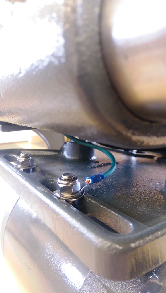

I tied mine to one of the motor mount bolts. I removed the paint from the motor mount casting and the motor frame mounting flange under the washers. Then I used an ohm meter and checked for continuity between the bolt and all parts it the SS (head stock, carriage, etc.).
- IMAG0275.jpg (157.72 KiB) Viewed 5911 times

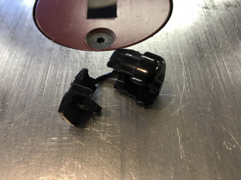

I have done this on two "Greenies" and a "Goldie" I have restored. As JPG has suggested I did attach the ground wire to the motor. John is showing a similar idea of how he did it on his beautifully restored Model 10. It is difficult to use the original strain relief on a new grounded cord. It is generally larger having three wires instead of two. I would highly recommend using a strain relief and one type is in the picture below. The hole it goes into is not totally round. It has flat sides to keep the cord from turning in the hole. See the drawing below to help understand what I mean. You will most likely need to enlarge the existing hole so match it to the strain relief you use.
