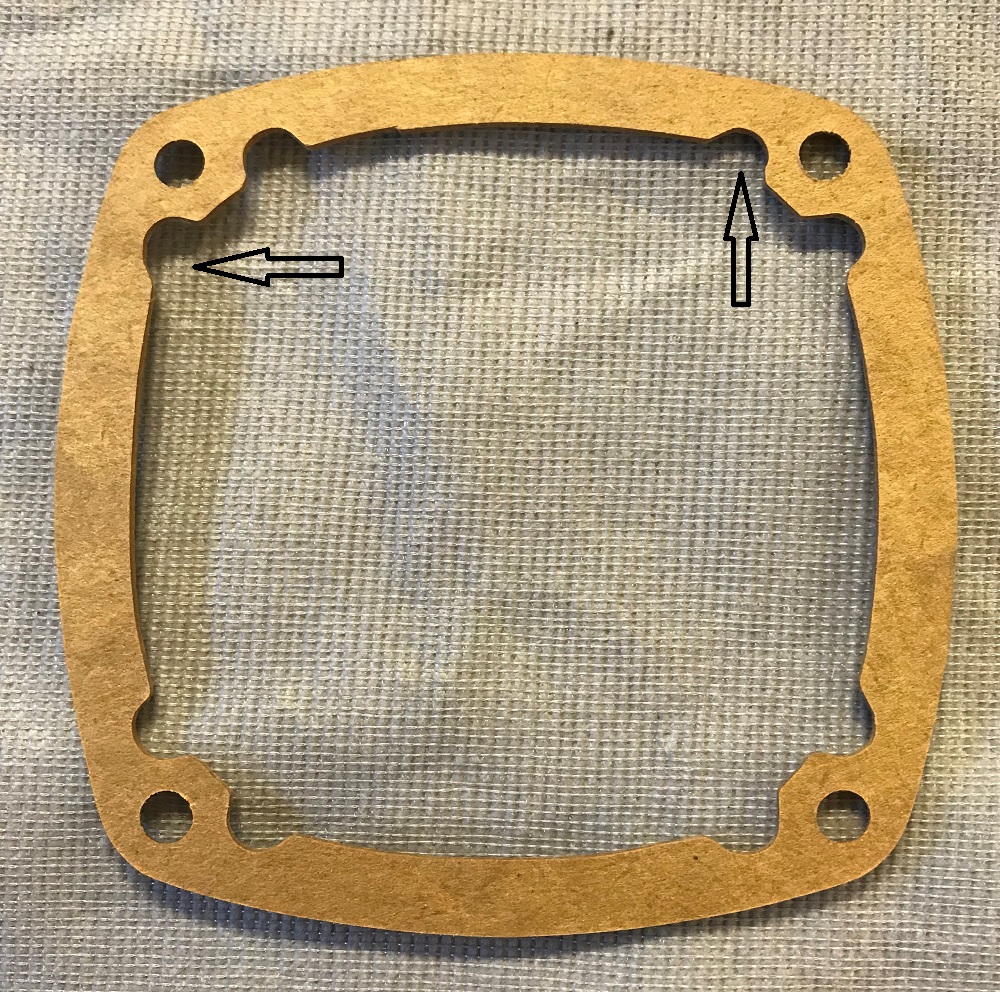

Re: 610 Jigsaw Leaking Oil
Were you able to resolve your leaking problem? If this is still of help, below is a picture of the gasket. The arrows point to indents for the air vent. These indents are all around the gasket so no matter which way you install it the vent hole is clear. Anyone making their own gasket needs to make sure there is an indent for the vent and place it properly.
Jig Saw Gasket - arrows.jpg (613.53 KiB) Viewed 5938 times
To place the vent hole in perspective, it is not merely to allow for atmospheric pressure changes, but is also to allow the internal pressure pulses when it is operating to not create the positive pressure in the crankcase that will guarantee leaks.
When it runs you should be able to feel/detect the air flowing in/out of the vent hole.
