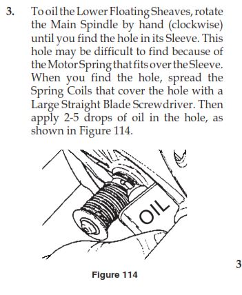

I am attempting to lubricate my newly aquired 510, particularly the floating sheave and cannot find the hole. From what I just read, it looks like oil can be applied directly to the shaft that holds the floating sheave. I would appreciate any help. Thanks.

That lube hole likes to hide beneath the spring. Try using a flat-blade screwdriver to separate the spring coils, while you're looking for it. The instructions below are from page 35 of the maintenance manual linked in post #4 above.davepk13 wrote:I am attempting to lubricate my newly aquired 510, particularly the floating sheave and cannot find the hole. From what I just read, it looks like oil can be applied directly to the shaft that holds the floating sheave. I would appreciate any help. Thanks.

I do believe that ya NEED to turn the speed up to at least "Saw" speed. That opens the motor spring, so you can FIND the oil hole. When ya find the hole, mark the location on the sheave so it's easier to find it next time. Also use 8 to 10 drops of oil.

Good point. A couple paragraphs prior to the one I copied, that maintenance manual says to run the speed all the way up to high.beeg wrote:BuckeyeDennis wrote:That lube hole likes to hide beneath the spring. Try using a flat-blade screwdriver to separate the spring coils, while you're looking for it. The instructions below are from page 35 of the maintenance manual linked in post #4 above.davepk13 wrote:I am attempting to lubricate my newly aquired 510, particularly the floating sheave and cannot find the hole. From what I just read, it looks like oil can be applied directly to the shaft that holds the floating sheave. I would appreciate any help. Thanks.

Another helpful tip I found was to mark the location of the oil hole on the sheave outside the spring to make it easier to find for future servicing.
