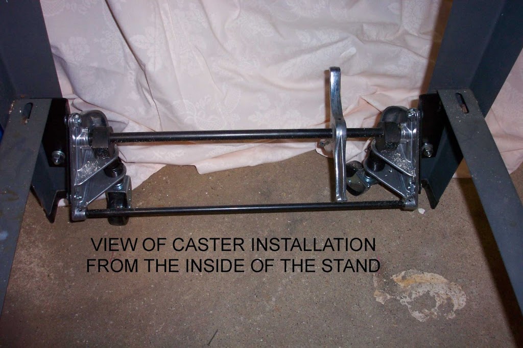

Dennis - In these pictures, the casters are mounted on the inside of the legs, but you have yours mounted with the brackets on the outside. Do you think it makes a difference one way or the other?
Posts: 3814
Re: Shopsmith Routing System
Mike907 wrote:Dennis - In these pictures, the casters are mounted on the inside of the legs, but you have yours mounted with the brackets on the outside. Do you think it makes a difference one way or the other?
I don’t think that a couple thicknesses of sheet metal would make any difference, mechanically. But mounting them on the inside probably does look a bit cleaner. IIRC, I just left mine where they were when I bought the machine.

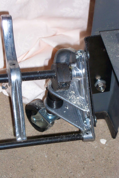

I also noticed that the photos above don’t show the black plastic spacers on the mounting bolts (between the brackets and the caster assembly) that I have on mine. If you zoom in on the pic in the link below, you can make them out. Again, I think I left mine the way that I received it, and cut the repositioned side braces to fit the resulting leg spacing.
https://www.shopsmith.com/ss_forum/wood ... 18323.html

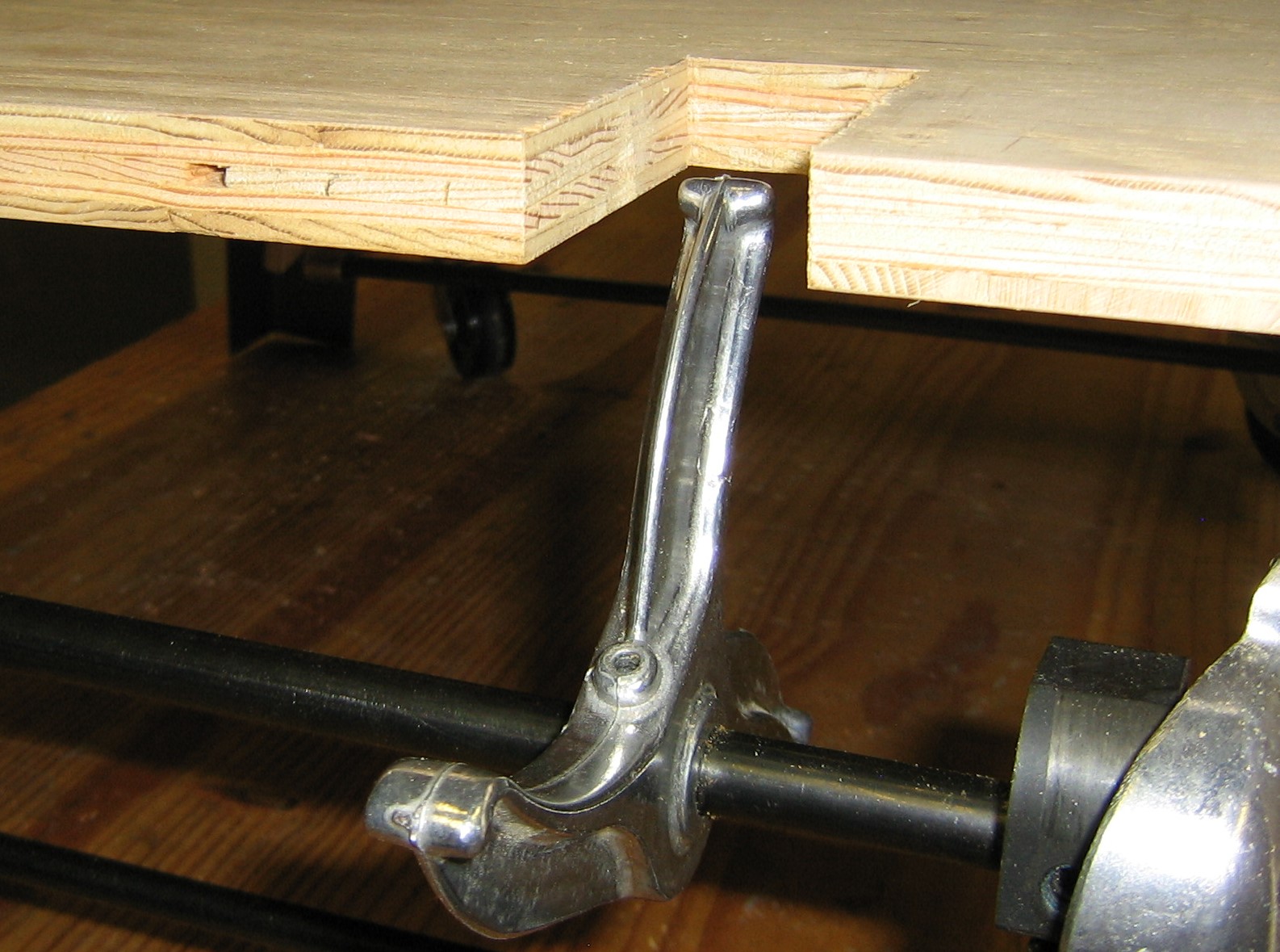

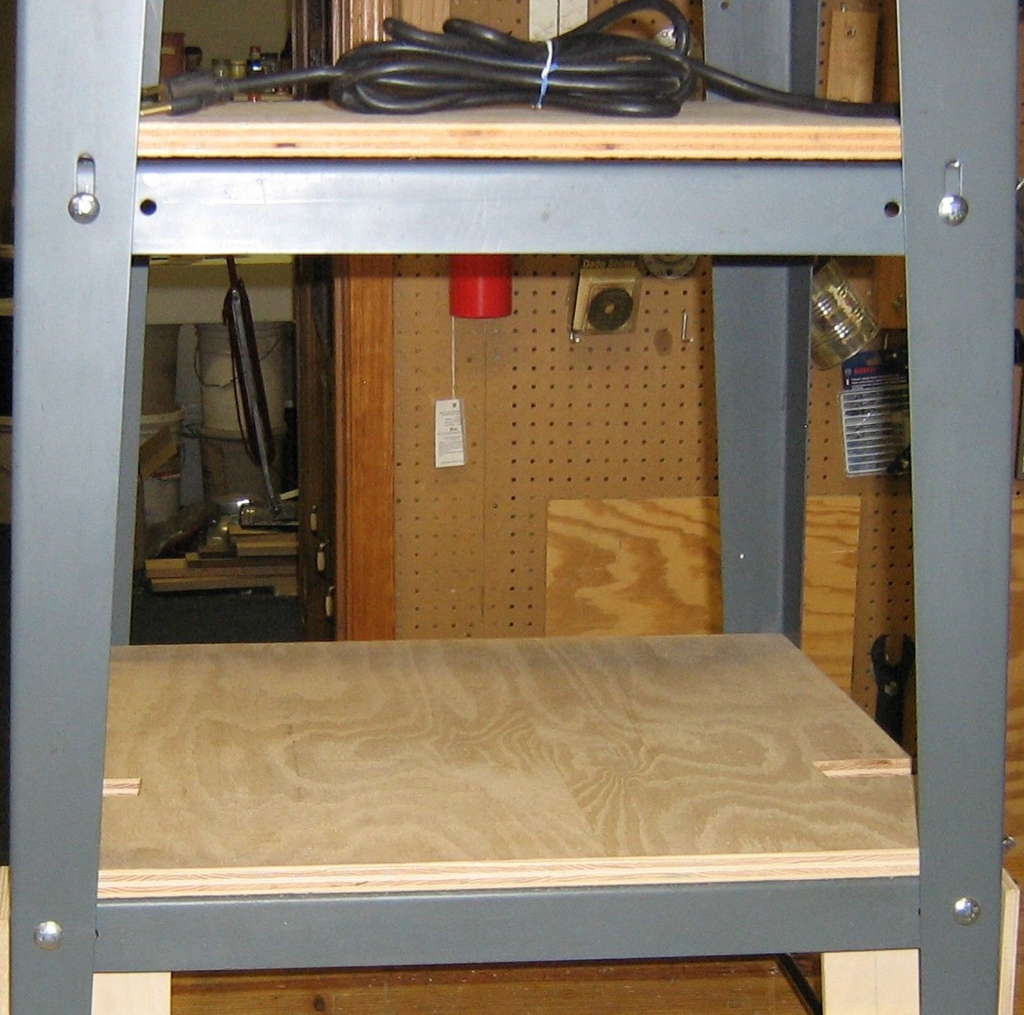

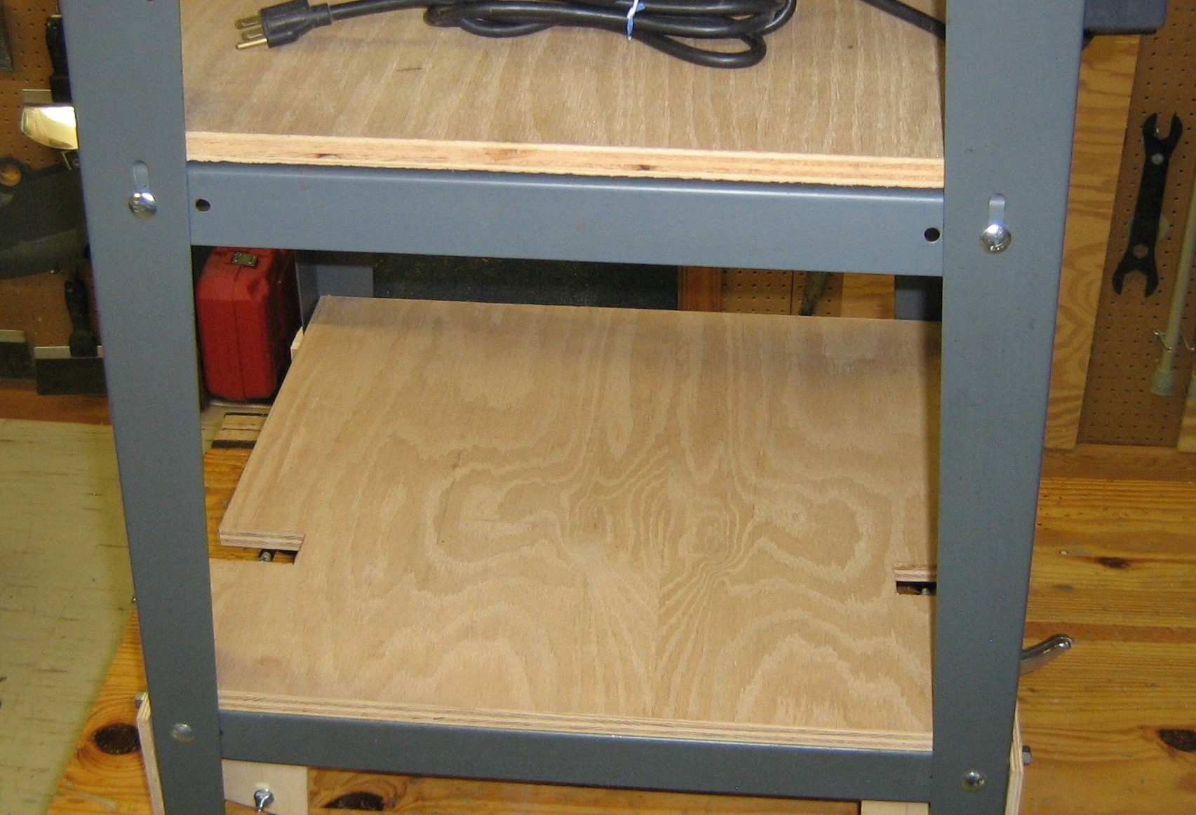

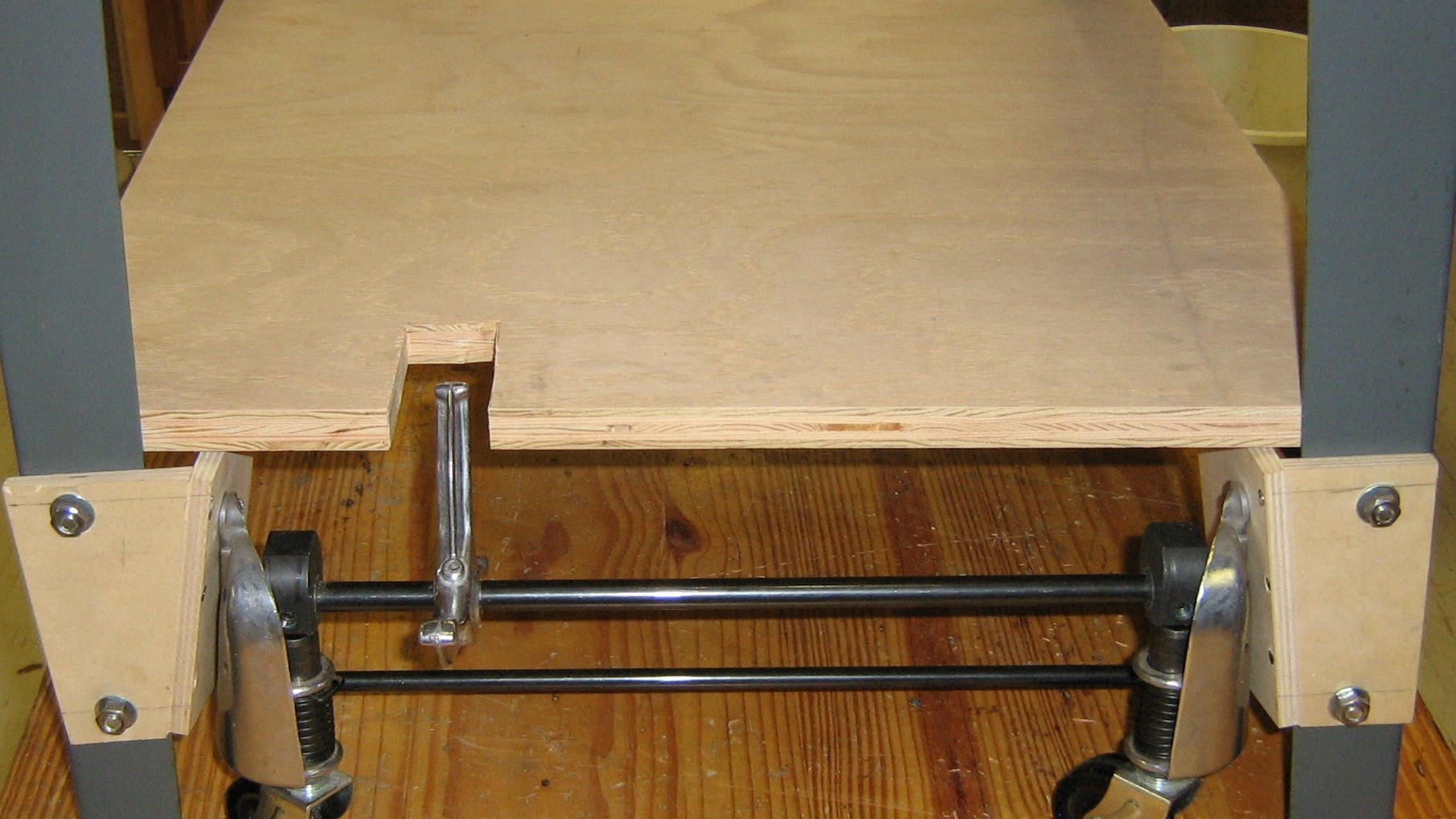

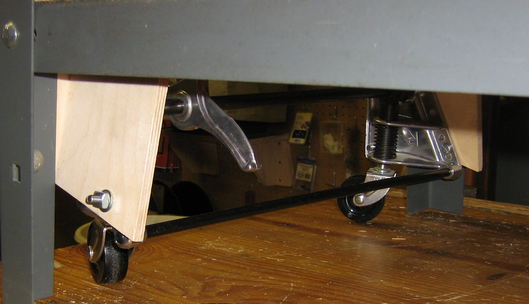

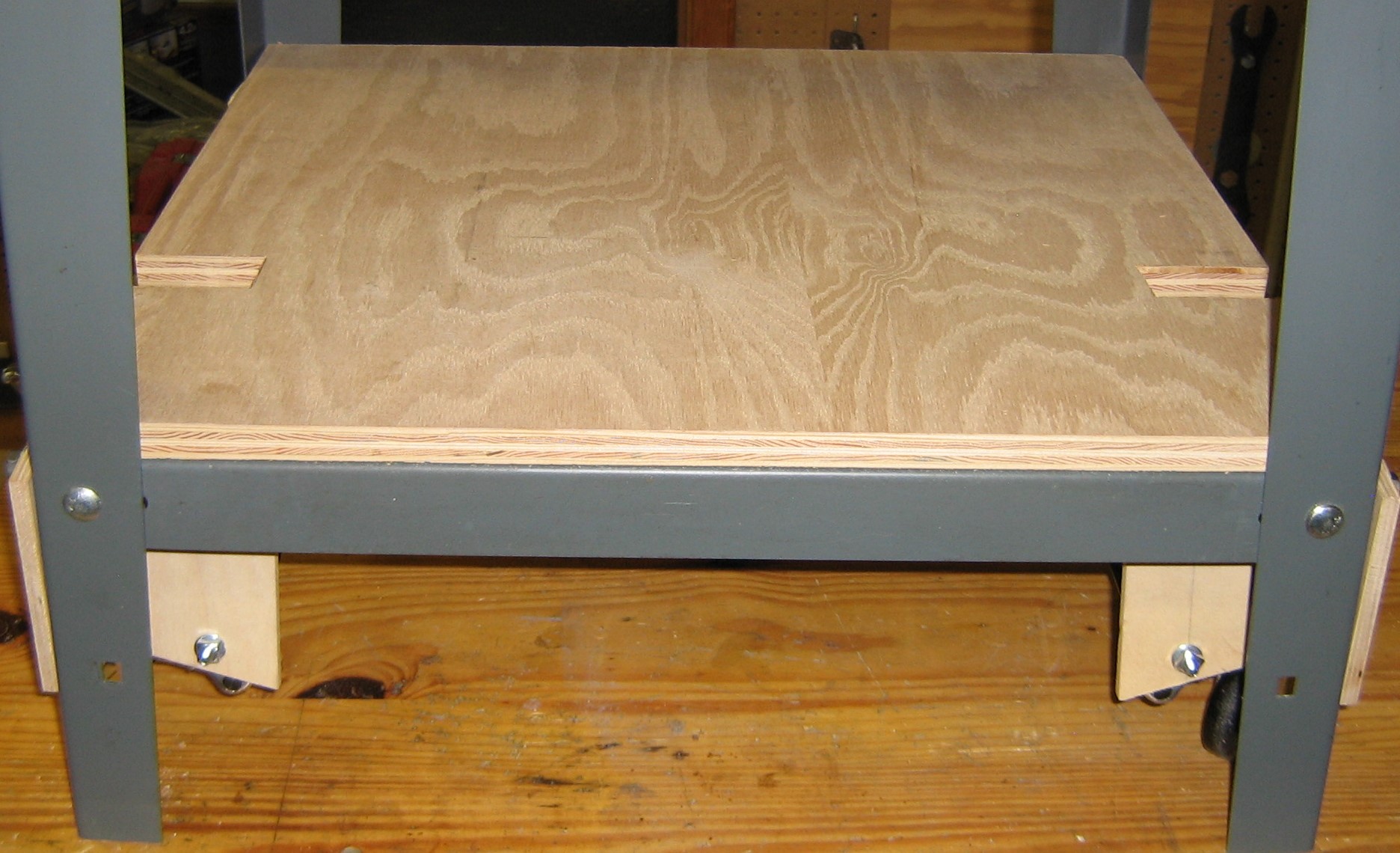

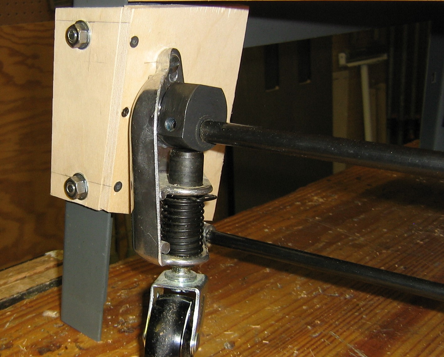

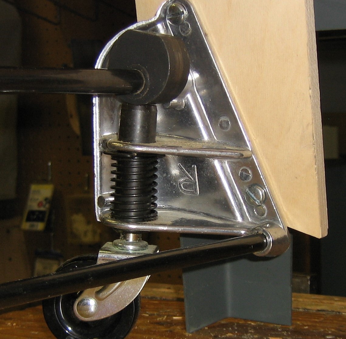

Since Shopsmith no longer sells the brackets I made my own out of wood. I also cut the lower cross brace that I removed and moved it up. This enabled me to add two shelves which solved the rigidity problem.
Bottom Shelf has relief cut for the handle.
Front view with both shelves
Casters viewed from inside bottom.
Inside view of rear caster
Outside view of rear caster.
Close up of relief cut in shelf.
Front view of bottom shelf.
Front view of both shelves.
