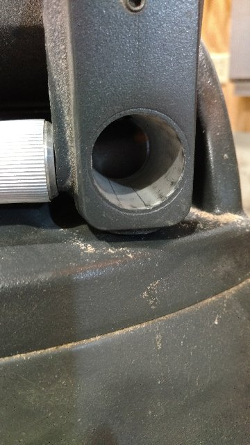

Re: Drill press won't go high enough for lock to work
Photo 1
- IMG_20180921_125931585.jpg (61.01 KiB) Viewed 13546 times

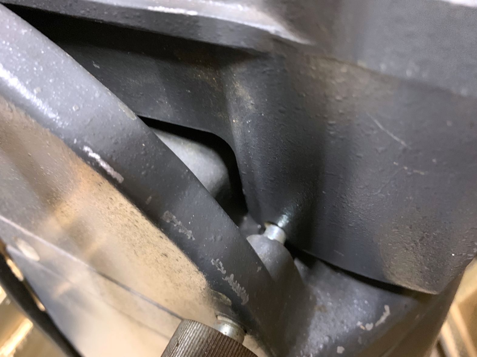

Photo 2
- IMG_20181015_121902741.jpg (67.1 KiB) Viewed 13546 times

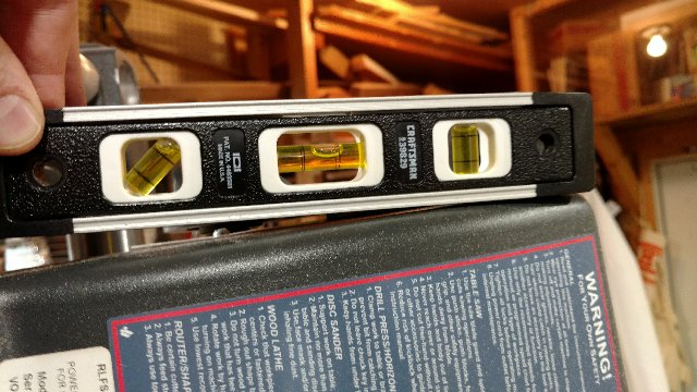

Photo 3
- IMG_20180924_135043389.jpg (51.64 KiB) Viewed 13539 times
Photo 3 appears to show the hinge fully rotated to vertical.
The mystery remains why the way tubes are not then vertical(+-).
Way/bench tubes reversed would lead to problems on the lock down(headrest) end.
The one photo from the "other" place shows the screw being where it should be if the hole is where it should be. This then would imply the locking portion is working and thus the hinge is allowing the full tilt. If this is the case then the only thing left is the assembly of the machine where the way tubes are not fully inserted and the whole end assembly is tilted. We have seen this before and there is a thread on it.
To see if this is the case we need a side view showing the way tubes and legs to see if it looks tilted. A full profile of that side of the machine would be preferable.
This could be due to the way and bench tubes being swapped or just not inserted far enough.
