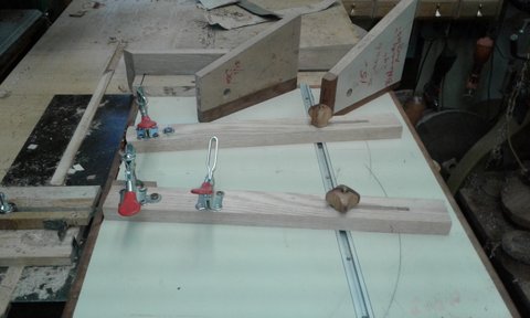

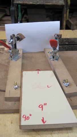

Re: segmenting jig
Bill,
Here is a picture of wedge sled.
Re: segmenting jig
Thanks for the pics. I like the idea of the "T" tracks. Saves the trouble of machining the arcs with the router.
Bill V
Bill V
