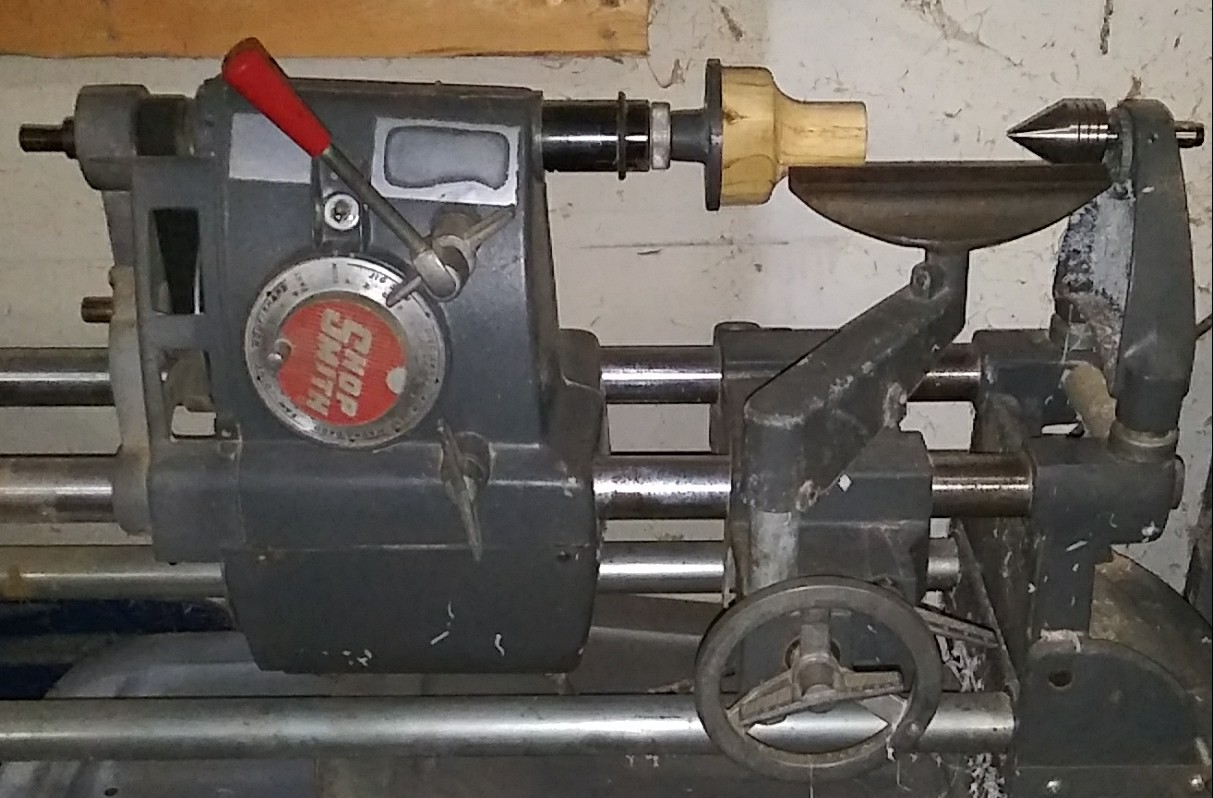

What model do i have? Finally got the picture to work

Then i am guessing its a 510 because of rails. They are steel and kinda hard to keep from rusting. What year range are the 510s?

Sometime between 1985 and 1991. 1985 is when they introduced the 510 and 1991 was when they switched to the "C" style headstock.

The rails that rpd referred to are actually the rails on the front and rear edge of the tables, that you don't have.
The 520 wasn't introduced until 1999 and only with type "C" headstock and the red safety key switch.
The way (upper) and bench (lower) tubes are the same for a 510 or a 520, and they to do tend to rust. Once you get the rust removed, Johnson Paste Waste will help keep them from re-rusting. Non-abrasive methods are best for removing the rust.
If you want to add tables, either the 510 or 520 style will work with your carriage. Be aware that there were two versions of the 510 table rails that differ in how they attach to the table. Be sure all are the same. And for adding other missing accessories, arbors for saw blades and for sanding disks for a 510/520 are longer than for a 500. Fences are specific to the 500, 510 or 520.
