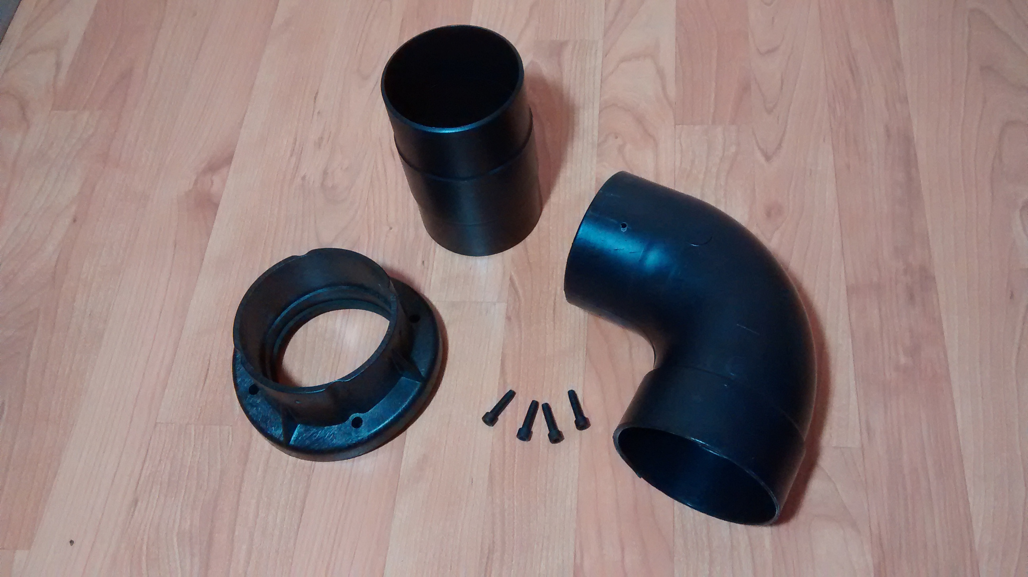

Has anyone have a picture of the 4 in adaptor for the DC3300 that was offered years ago? You removed the 2 1/2 in collector box and installed this adaptor. I have a extra vac that I would like to attach a 4 in hose to my only soul tool with a 4 in dust port. I know about the octopus that was shown on the the sawdust sessions. Not interested in that. Hoping that I could make one if possible.

I'm aware of that. But standard 4 in dust collector fittings are a tad smaller. And standard PVC pipe is to large. There was a fitting that was attached to the front using the four screws that held on the 2 1/2 in port fitting. I remember seeing a picture of it years ago. But can't remember what it looks like.

See if this picture works
- 4 inch adapter
- pic1.jpg (609.39 KiB) Viewed 20949 times
- 4 inch adapter
- pic2.jpg (460.67 KiB) Viewed 20949 times

Thanks! that's what I needed.

Glad that worked. Old picks from when I sold it on ebay.

If I remember the elbo was schedule 80 pipe.
