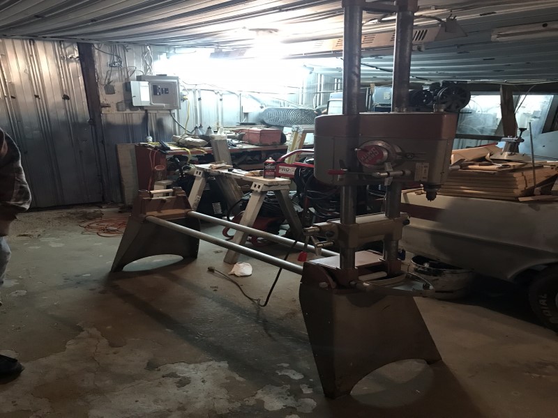

So for Christmas my wonderful girlfriend managed to surprise me with what I believe is a 1963 Mark 5 Shopsmith. It came from Kansas and was bought from the wife of the single owner, who passed away over 15 years ago. My girlfriend took her dad and uncle with her to get it, neither have had shopsmiths. It was setup in the original owners workshop with pieces scattered. They got everything they thought went with it. After looking over everything I believe it is all there. Including the original owners manual.

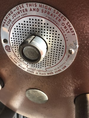

I disassembled the headstock following videos on youtube in order to inspect bearings and all the components. None of the bearings were very impressive, all were stiff and dry feeling. 2 made significant noise when spinning. So I have all new bearings on the way. It is a Poly V Drive, single bearing quill, 1 1/8HP AO Smith motor, Serial Number 374159.
So a couple of questions,
Does this add up to a '63?
Was a blade guard and casters standard equipment or accessories?

My 1963 Goldie was purchased(by me) in early 1963 sn 377425

Your Mark 5's serial number is close to the last known serial number production dates for 1961 and it would be safe to say it was made in the first quarter of 1962.
