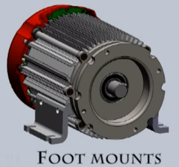

With regard to the mounting to the 10E /10ER Motor plate, there is an optional Foot Mount for the motor that would allow you to hang it directly as with the conventional motor. (See Illustration)

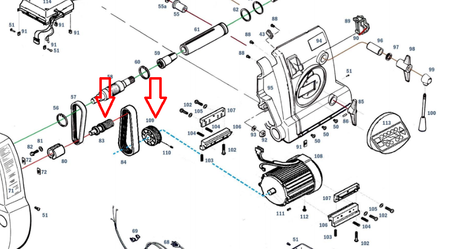

I also have added an exploded parts variation PDF of a Sample DVR Motor that is used in other applications such as some versions of the Nova lathe.
I ask those of you familiar with the Shopsmith Power Pro motor sensors to pay particular attention to items 21, 24, 25 and 26 where the sensor is mounted.
Dust tends to get into the Shopsmith in this area (RP0 and other errors), but this design has it inward facing, sealed with an adhesive gasket and cover plate.
