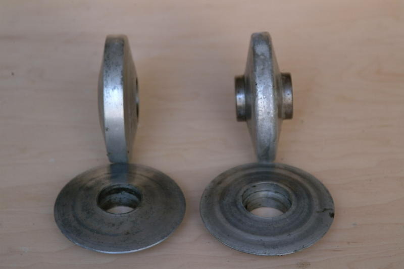

The pulley consists of three 'sheaves'. Two outer that are fixed and a center one that slides between the outer ones.
The sheave shown has the 'stop' that the 0-5 version has. Perhaps you have parts from both versions. IIUC only the numbered plate and the sheaves differ.
I have no idea how the crank screw got damaged.
Re: You should have warned me...
Your floating (sliding) sheave would appear to be the later style.amboyna wrote:I'm a little lost. Is this the sliding sheave?JPG wrote:A word of caution re the 0-8 speed changer. I would simply refrain from going above 5. Check the sliding sheave. It should NOT have the step at the bore. The step prevents adjusting until the belt rubbed on the shaft.
Never ever adjust the speed and allow the springs on the control screw to become fully compressed. Doing so causes the breakage mentioned above.
The previous owner did crank it to 8 where it scarred the crank shaft threads.
See photo 2.
early on the left, later on the right.

The sheave shown is the one that came off the 0-8 version. So a normal 0-8 version does not have that part that sticks out past the pulley edge?JPG wrote:The pulley consists of three 'sheaves'. Two outer that are fixed and a center one that slides between the outer ones.
Just saw your photo. Never seen the one on the left before. Sounds like someone might of done some parts swapping.
The outer sheave has scrapings that match where the crank threads were bunged up. They cranked it all the way!!!

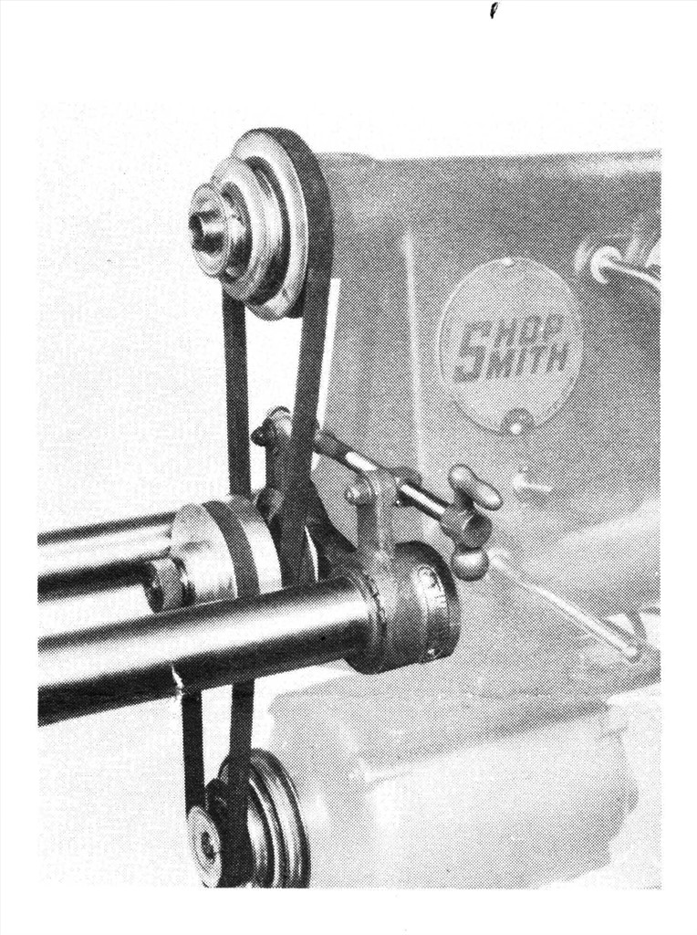

I have two different speed changer manuals. One shows the crank assembled on the pulley side of the main body. If cranked too far the pulley will hit the crank screw. The other manual shows the crank screw on the head stock side of the main body thus avoiding the interference.JPG wrote:The pulley consists of three 'sheaves'. Two outer that are fixed and a center one that slides between the outer ones.

On the other hand, it it is on the headstock side the crank handle can interfere with the headstock lock lever.
With the crank mounted to the left of the ears I haven't had it hit the pulley, perhaps that is specific to the 0-8 model , mine are both 0-5.
rpd wrote:On the other hand, it it is on the headstock side the crank handle can interfere with the headstock lock lever.
Which might be another reason they went with 0-5.

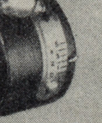

The first detail is from Speed Changer 1 showing the scale goes to five:
The second detail is from Speed Changer 2 showing the scale goes to 8:
- 08.jpg (26.47 KiB) Viewed 14180 times

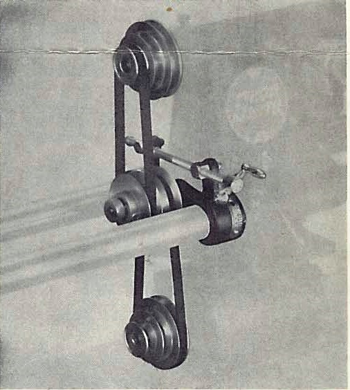

What is strange is the fact that the page I pulled the 0-8 scale from has a speed chart that goes to 5. I wonder if they were already in the process of changing the scale.
- SpeedChanger_Magna_01.jpg (198.32 KiB) Viewed 14173 times
