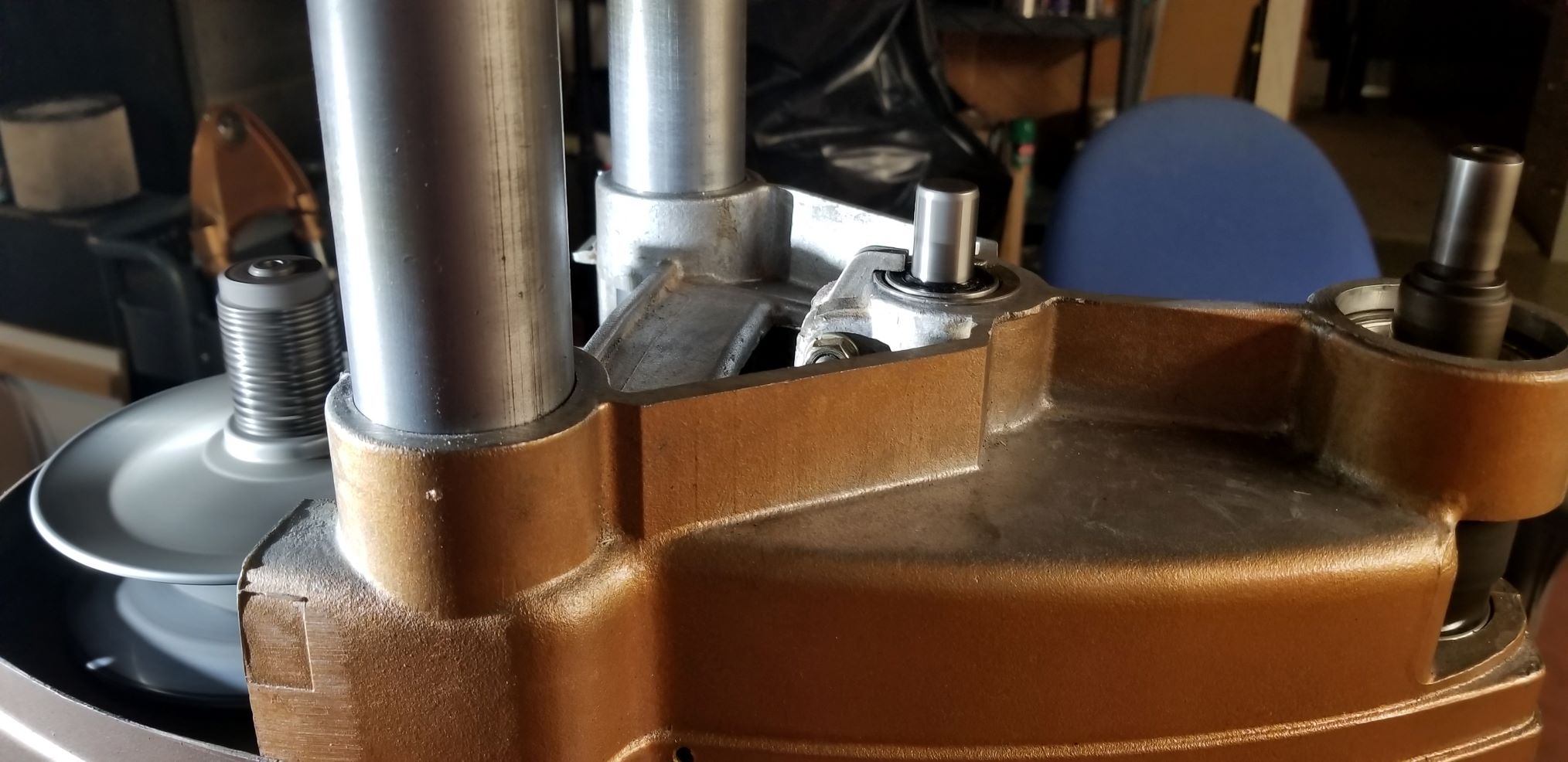

As Dusty said replace the ring on the Idler shaft for the sheave stop. I see your Idler shaft has the bearing retainers but they are not keeping the bearing flush with the headstock casting. That is pulling the Gilmer Belt against the inside of the headstock casting. This is also affecting the speed control with the idler shaft being further out of the casting. Try reversing the retainers to see if they will hold the idler bearing and the eccentric flush with the casting. Do not over tighten the clamping bolt or you could break the casting.

Those retaining clips only work one way.(the narrow end towards the belt).

Couldn't wait until tonight and put things in order last night. Works better when one puts ALL the parts back, go figure.
Having that ring made all the difference. belt no longer rubs, the eccentric thingy fits flush with the case. good to go.

With so many parts in the headstock and the changes it has gone through it is easy to miss a part here or reverse a part there. Glad you were able to get it back together correctly and it runs smooth for you. I agree there is a certain satisfaction and sense of accomplishment in restoring these older Shopsmiths. Now you have plenty of time to make sawdust with a well running machine. You have a beautiful machine you can be proud of.
