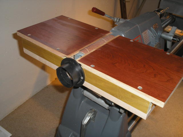

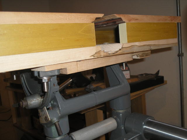

I had an old 500 tie-bar & trunnion. I took 5 inches out of it and used J-B Weld to put it back together. After painting it gray, it looked pretty nice.
I continued and fashioned a box on top the trunnions. The very top of the box utilizes some old cherry cabinet-door panels which I found in a neighbor's trash. The tapers came in very handy as you can see.
I added a Dust Port and also used the 6-inch Drum itself to make the final tweaks on the top panels.

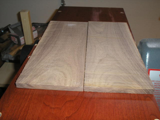

It worked GREAT! There is a bit of runout in the rubber drum (not the aluminum basis of the drum) but with the Trunnion system I could level the table just right over the length of the drum. See the pieces of walnut; one is still rough-bandsawn, and the other is after some passes across this drum & table. Dust control was GREAT, just nothing came out!
Mod Tie Bar & Panel Taper Top.jpg (36.39 KiB) Viewed 12084 times
Dust Port Side.jpg (40.04 KiB) Viewed 12429 times
Bookmatches Compared.jpg (38.75 KiB) Viewed 12004 times
