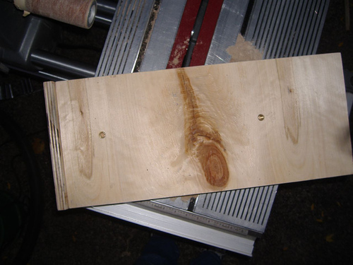

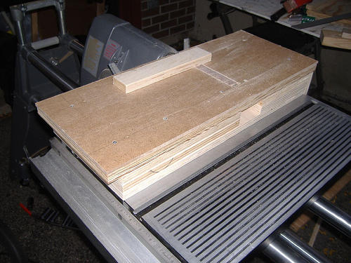

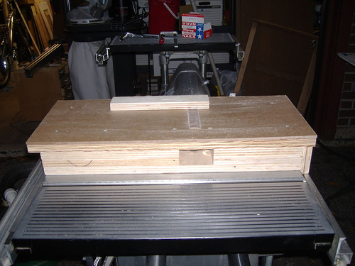

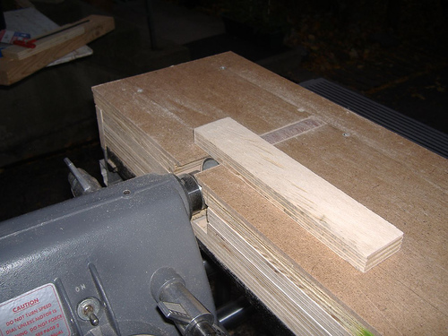

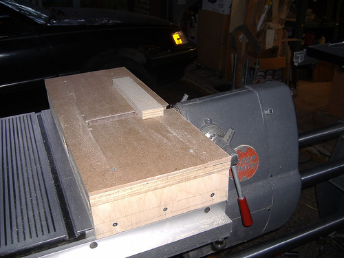

I have just made a sander this afternoon and had time to play with it. It might work like a sand flee or might not. It does how ever stay on a smaller scale and even smaller budget.
I have a list of interesting features it has, and can tell you it was a lot of fun to make and a lot of fun to use.
I have chosen to post the details at the other shopsmith site so if you are interested you will have to go there:
This link is no longer valid 12/5/08
http://ssug.org/forums/viewtopic.php?p=7999#7999
There is also a link to pictures. Please check it out, I think you will like it.
[ATTACH]501[/ATTACH]
- sand almost free.jpg (75.59 KiB) Viewed 16517 times

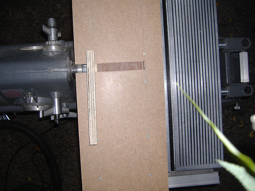

One thing I don't understand, usually the hight of the outfeed table need to be equal to the hight of the drum and the infeed table sets the depth of sanding. This design does not seem to do this.reible wrote:I have just made a sander this afternoon and had time to play with it. It might work like a sand flee or might not. It does how ever stay on a smaller scale and even smaller budget.

Hi Paul,paulmcohen wrote:One thing I don't understand, usually the hight of the outfeed table need to be equal to the hight of the drum and the infeed table sets the depth of sanding. This design does not seem to do this.
You are correct that the table is flat. This is more like rubbing the workpiece over a piece of sandpaper then a jointing operation that you discribe...... does that make since?

I again question the usefulness of the whole concept. If it was like a jointer then it would make some sense to me. However to have a flat with the drum slightly protruding seems to suggest to me that the finish product that will have straight line scratches and will still reflect any bumps, dips or imperfections the piece initially had.

Ed in Tampa wrote:I again question the usefulness of the whole concept. If it was like a jointer then it would make some sense to me.
I think this maybe one of those times when like with a shopsmith, some people get it and some don't. If I had only seen the machine and not watched the video and some one just tried to explain it to me I too would have not understood. The fact is I have seen this type of idea several times before and dismissed the idea because of how it was presented, that being as a substute drum sander. In fact it is quite a different tool all together.

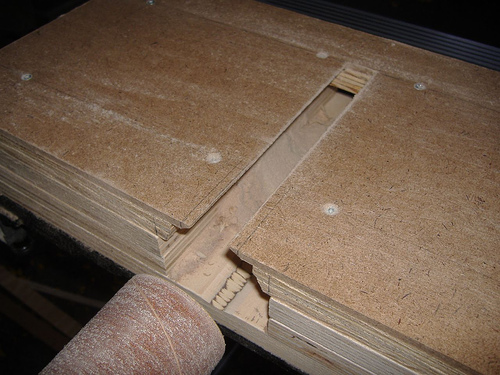

I think part of the problem is trying to picture the drum being taller then the table top. Think of it as the sand on the sandpaper lightly touching the workpiece. If you picture the actual drum being below the surface it is easier to see how it works.

Again I think you are thinking about removing lots of material... this is more like using a sanding block on the floor then a floor sander.
As for me I'm going to concentrate my money and energy toward a thickness sander and more conventional sanding.
If you already have the 6" shopsmith drum sander then there is no cost except a couple of hours in the shop doing what we all love to do, woodworking. Well if you have no scrap in the shop you might have to run out for a piece of 3/4" plywood and some 1/4" hardboard and glue and well maybe some screws... I had all that I needed in the scrap bin and the design is super simple using stacked plywood... anyway you can play with the concept for almost free.

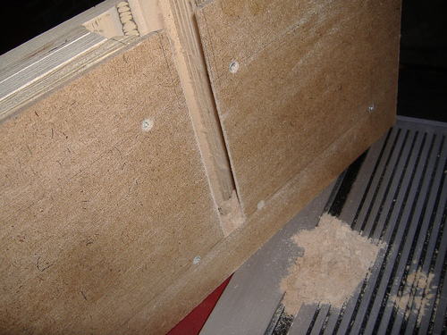

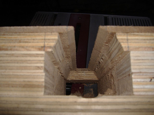

I had a few minutes today to work on the sander. I wanted to add dust collection and wanted to stay on the free side. The solutions was to borrow another shopsmith part and use it. When you see the picture you will know what it is if you have one.
Just a few comments about the dust collection, it works GREAT! I hooked it up to my shop vac and sanded for 10-15 minutes. I then got out a piece of dark wood to dump the saw dust out on to see how much was left inside. The problem with the plan was there was no sawdust... no not a spoonful, not a 1/8 teaspoon, none. Ok a couple of small flakes did fall out but it was way to small to measure.
I also wanted to hook up the oscillating sander bit to check it out. I forgot what the stroke is at max so I put a 3" drum in and measured. The number is about 3/4". So my design has plenty of room to use the 6" drum, even at the max movement.

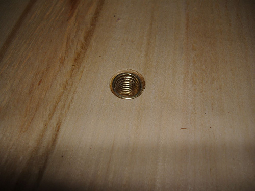

Below you will find the pictures that use to be at Flickr. The original post has been lost at the ssug.org site so this is what remains. I can answer questions if you have any but the hole idea is so simple and the pictures tell most of the story anyway.
