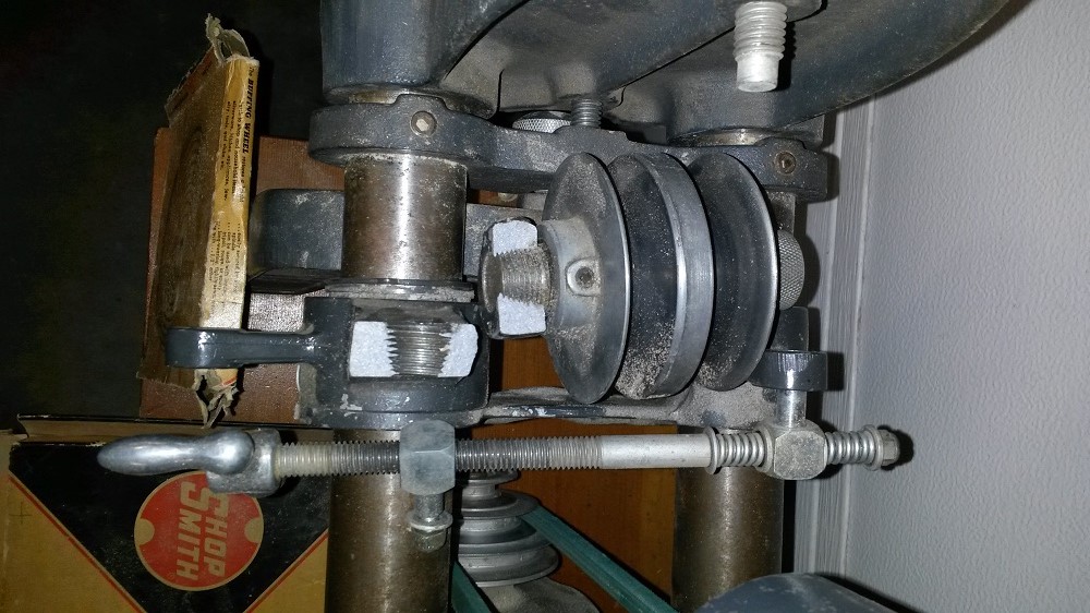

How do you remove the axle rod from the speed changer housing? It has a set screw so I assumed it was just pressed in like most of the rods on the Model 10ER itself, but it won't come out. When I look in the set screw hole, there might be threads in there?? Any help is appreciated.

Why do you want to remove it? I had mine all apart and did a repair but didn't feel a need to remove the axle. It seemed very solidly attached.

On the third page of that thread, however, Chapmanruss posted pictures of one of his that a PO had broken, and it shows that the axle is screwed into the casting.

I agree. Of the several I have refurbished I have never removed the axle.rpd wrote:Why do you want to remove it? I had mine all apart and did a repair but didn't feel a need to remove the axle. It seemed very solidly attached.

I have tried before and never did have any luck. It is on pretty tight.
The axle is threaded. If you take the allen nut out you can see the threads. And the allen probably bunged up the threads. So unthreading the post could cause damage to the aluminum.

Why do you need to take out the "axle"? It is threaded in and held with a set screw. The set screw "damages" the threads and it will be difficult if not impossible to remove without damage. The broken one I have that Ron referenced still does not want to come out of what is left of the threaded part. I would have to break the remaining casting to get it out of it. I cannot tell you how it broke as it was broken when I bought it with a 10ER. All the ones I have restored, I have taped over the axle before painting. If the axle is damaged you would be better off finding one for sale that has the main casting damaged and buying if for the Axle Support Assembly you need.

Thank you for your responses. I am repainting the body of the changer. I took your advice, left the axle in place, taped it off and everything came out fine.
