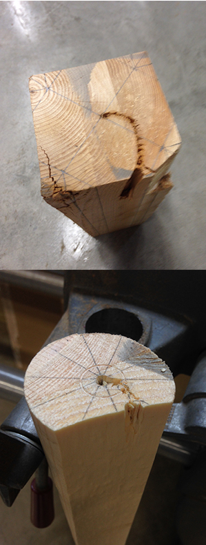

Help - The lathe on my Mark V repeatedly throws whatever I mount off the machine. The seemingly obvious answer is that alignment beterrn head and tailstock is off but I have very carefully made the alignment per the instructions in the manual and I have used other alignment techniques as well. Nothing is loose so ther is no play on either side. The wood is securely mounted but what happens is the pin on the tailstock cuts a groove out of center (which I have very carefully marked) and continues to cut its way out of the wood and then the wood goes flying. Does anyone have any experience with this problem or can offer any suggestions? I'm out of ideas. Thanks for any input you can offer..

Re: Lathe
Can you post a picture of what you mean "the pin on the tailstock cuts a groove out of center (which I have very carefully marked) and continues to cut its way out of the wood. The dead center should be seated in the stock so that the round cup is embedded in the stock. Same thing for the drive spur. The 4 wings need to be embedded in the stock.
Use a rubber mallet to drive both centers into the stock so they mark the wood very well. Then mount the centers and the stock.

Re: Lathe
Thanks to all for your comments and suggestions. I have added a picture to better illustrate what is happening. The rounded piece is pine (or similar soft wood) and was purchased as a round dowel with a 2" diameter. It split in half as it was ejected from the lathe. The square piece is made from laminated 2 x 4 cut to a 3 1/2" square. Nether piece was touched by a tool, I mounted them and turned the lathe on simply as a test, which both failed as they were thrown from the lathe. The turning speed was relatively slow (within suggested speed range) but not at the slowest speed.
The problem is always on the tailstock side. Are you still of the opinion that a live center will fix this issue?
I should add that both pieces were securely mounted. Is it possible to have the wood mounted too tightly? It spins relatively easy by hand so it wasn't binding on the tailstock side......

Re: Lathe
Again - the center pin is ONLY for centering.
The cup(ring) is what keeps the work piece mounted.
The first pix shows no indentation of the cup.
The second shows the cup indentation, but not following the path the center pin took when dismounting.
The cup is what the workpiece rotates against, NOT THE PIN.
A live tailstock center will NOT work with only the pin contacting the workpiece either.
Re: Lathe
Your problem that has been already said more than once is that you are not seating the cup center in the stock correctly. The pin is only for centering. You must have the circular cup embedded in the stock.Linmax wrote:Thanks to all for your comments and suggestions. I have added a picture to better illustrate what is happening. The rounded piece is pine (or similar soft wood) and was purchased as a round dowel with a 2" diameter. It split in half as it was ejected from the lathe. The square piece is made from laminated 2 x 4 cut to a 3 1/2" square. Nether piece was touched by a tool, I mounted them and turned the lathe on simply as a test, which both failed as they were thrown from the lathe. The turning speed was relatively slow (within suggested speed range) but not at the slowest speed.
