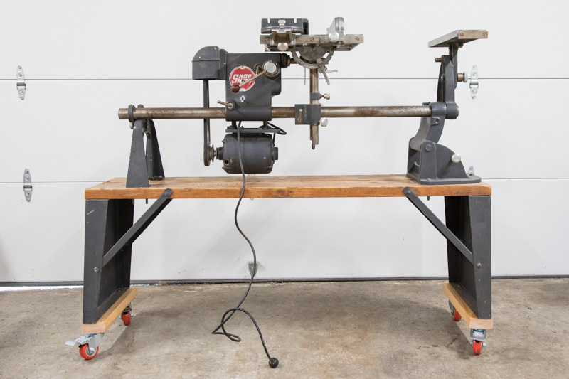

First off, I'm new to the forum, just found this over the weekend and just signed up. I have a Model 10ER that my grandpa bought new in 1951 or 1952 I suppose. He gave it to me 16 years ago, and I'm sad to say I used it only once, shortly after he gave it to me. It has sat unused since then in my garage.
I'm finally now getting interested in getting it back up and running. I know I'll have a ton of questions for you guys, but browsing over the weekend I also see that there is a ton of good info on restoration in the forum. I'm looking forward to lots of learning on this forum.
There is some rust, but it isn't too terrible. After some work, I was able to get the headstock sliding on the tubes, and ended up taking all the various parts off the tubes and plan to work on removing the rust.
But, my first question has to do with the motor and the headstock. The motor is full of sawdust and spider webs. I'm assuming I should open it up and clean it up before even attempting to switch it on. Is this a good idea? I couldn't get the pulley off the motor shaft, so I'll need to work on that. The shaft on the headstock turns, but not as easily as I'd expected. Also, it took some WD40 to get the quill moving, but it is still very tight. So I'm planning on disassembling it all and cleaning and lubing everything. But I didn't find a good example of how to do that on the forum for a 10ER. I'll keep searching but thought someone might be able to point me to good info.
And just for fun, here is a picture of the Shopsmith with some of it's accessories attached.

First welcome to the madness!
It looks in very good condition from the pix.
Actually it disassembles simpler that a Mark 5/V...
Be on the look out for stuff secured by more than one setscrew.
I would attempt a good blow out of the motor as a first step.
Determine if the shaft rotates freely before energizing. Energize very briefly the first time in case it wants to stall.(belt removed from pulley)
A gotcha can be the quill spring. Do NOT let the quill feed retract freely, but allow it to relax gradually by holding the quill feed handle so it slowly retracts.

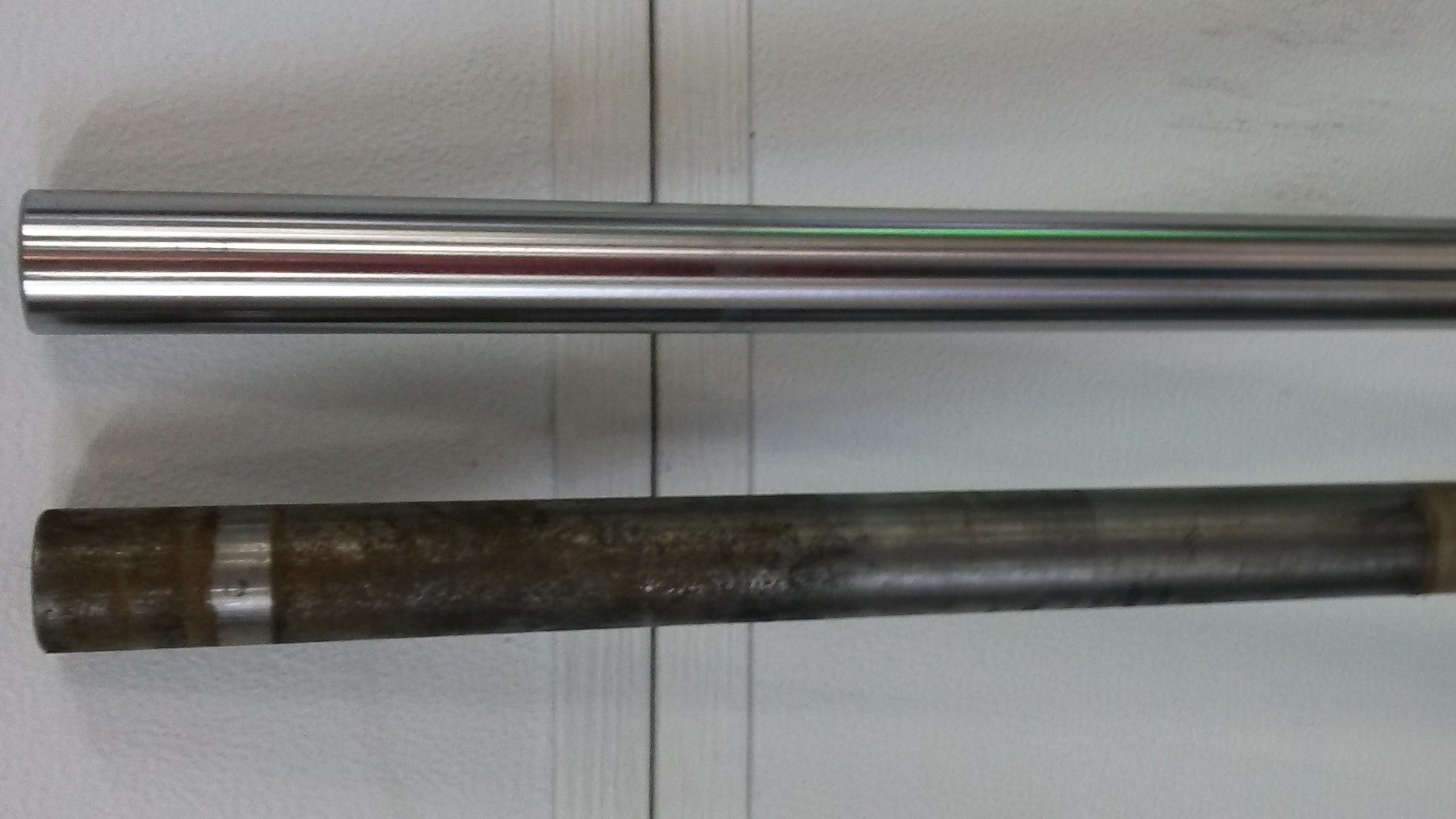

For the Way Tubes rust remover and polishing can bring back even some that look like basket cases. Here is a pair with one "cleaned" up. As for lubrication needs after cleaning and restoring follow the correction to the original Model 10 manuals attached below. When the Model 10 manuals were printed they had not discovered the advantages of using paste wax over grease and oil. Woodworking produced dust and the fewer parts using grease or oil the better.
