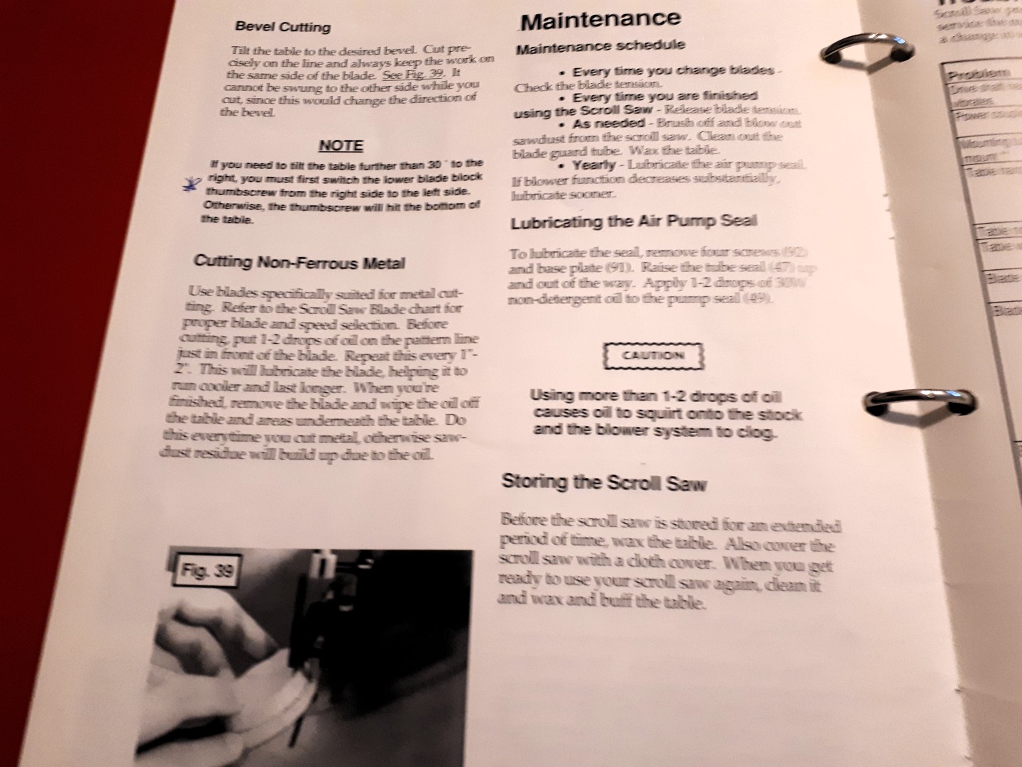

Only the 610 Jigsaw runs the yoke in an oil reservoir. Neither the older A34 jigsaw for the 10ER, nor the newer scroll saws have one.
Here is the maintenance page from the older gray Scroll Saw manual, I would imagine that the newer teal Scroll Saw would be similar.

is pump seal #49 in the link below?
https://www.shopsmith.com/ss_forum/main ... ml#p212832
rpd
Posts: 3045
Location: Victoria, B.C.
Re: Maintenance - SS scroll saw vs jig saw
Post by rpd »
jjj240 wrote:is pump seal #49 in the link below?
Yes, pretty much right in the middle of the diagram. And the part number, #502239, is the same in the newer teal model too, and looks like it was used in the jigsaw also. Haven't had my scroll saw apart, but the seal in my old A34 jigsaw is leather, They tend to dry out and get a bit stiff overtime, a few drops of light machine oil should get it supple and sealing again.
