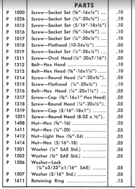

Late in reading the thread but the 10ER Washer P 1502 shown on all three lock assemblies is listed in the parts list as with specific details of what it is. 3/8" SAE Std.
MAGNA published the specs back in those days and it is sure handy when you need something you can likely find locally. The Exploded Parts Diagrams and Specific Part Descriptions are a real help to me.

Everett is showing the later manual information after the part numbers changed in November 1951. The size I listed is from an earlier Model 10E manual for part number 104-2W. Checking a 10ER manual for part 102-4W it is listed as a 3/8" washer. Either way, 5/16 or 3/8, it should fit snug on the lever shaft when against the shoulder.

Yes, I chose the later 10ER parts list as BuckeyeDennis posted a photo from that series of restored manual earlier in the thread. It made it possible to identify the washers.
