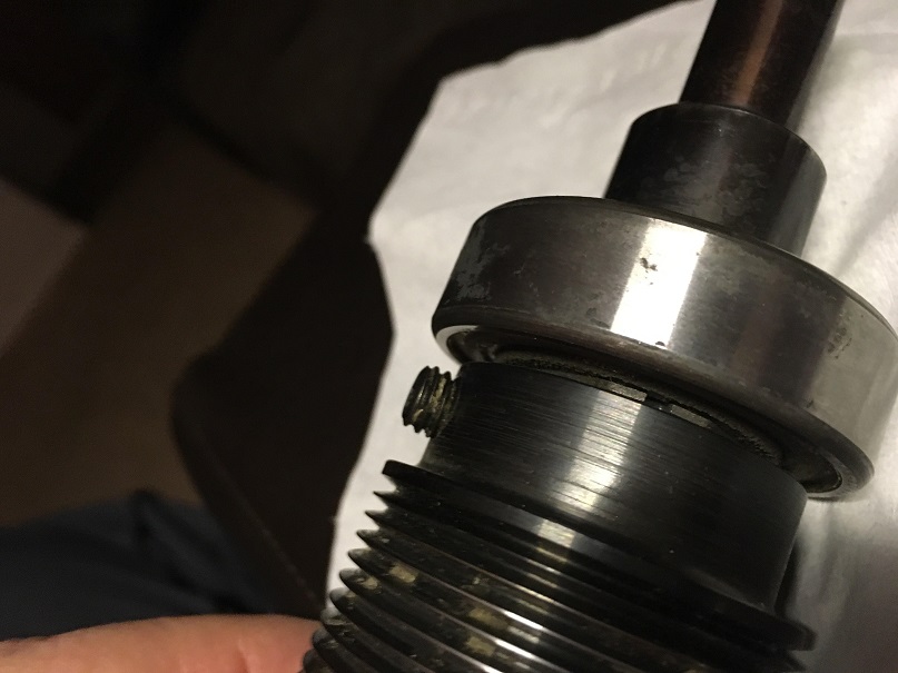

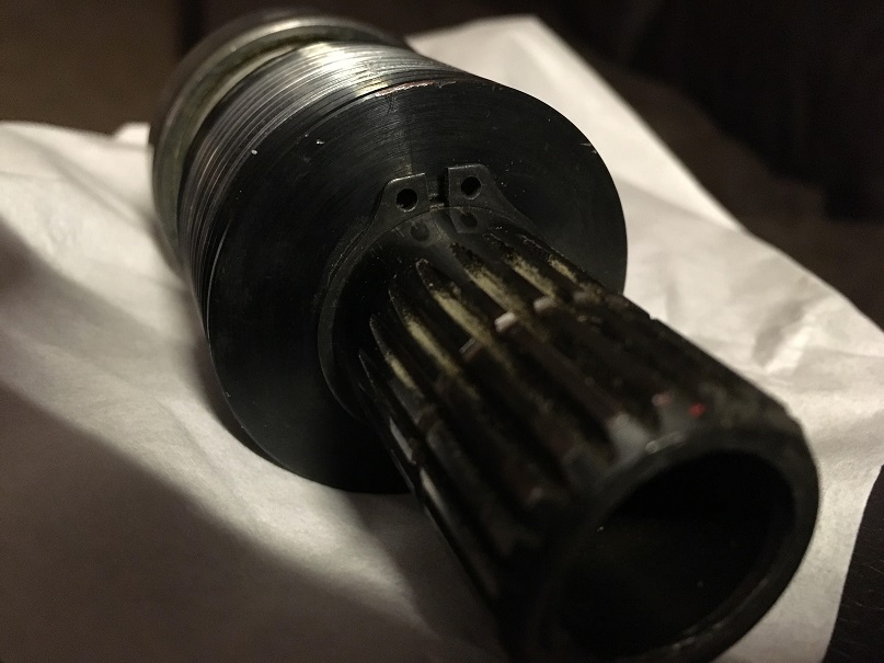

As requested
- c-clip 2.jpg (115.54 KiB) Viewed 15227 times
- c-clip 3.jpg (102.6 KiB) Viewed 15227 times

Thank You! I think I forgot about those.P89DC wrote:As requested
They do not appear on the exploded views. They are part of the entire drive sleeve assembly which is replaced as a unit.(SS does not 'think' we are capable of replacing bearings)

I am fine with replacing the bearings. It's the clutch I don't want to mess with. I had one of those apart once (and only once) and it took me a long time to get it back together and set correctly.

Shhhhhhhh! Do not tell him about the 'clutch'. Actually his may not have one.
His pix clearly shows what looks to be a 'new' poly-v drive sleeve.

I was attempting to understand just how there could be a clutch mechanism inside that assembly. And how there was some kinda clutch in my Shopsmith I never heard of. All I've every seen or used are my two and there doesn't appear to be any clutch.

Re: Rebuilding basket case, what is this?
The clutch is built into the drive sleeve of Mark 5's that use the Gilmer belts (except for the very first greenies) so that if the blade jammed it didn't shred the belt or damage other parts of the drive train. Once they went to the poly-V belt the clutch was no longer necessary as the belt can slip and serve that function.P89DC wrote:I was attempting to understand just how there could be a clutch mechanism inside that assembly. And how there was some kinda clutch in my Shopsmith I never heard of. All I've every seen or used are my two and there doesn't appear to be any clutch.

You can see what the clutch looks like in this thread. https://www.shopsmith.com/ss_forum/view ... #post32871
