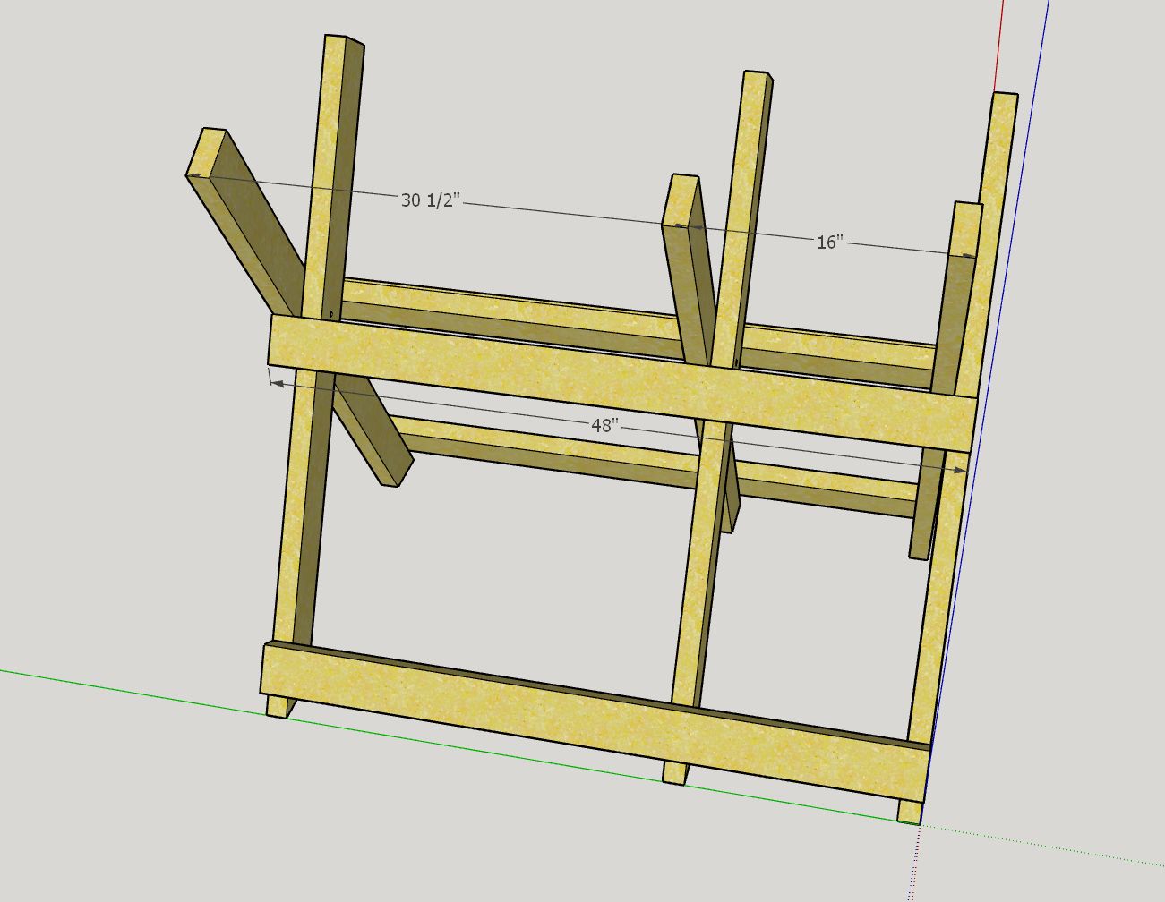

Many years ago these were a common thing around our place, and well used since we supplemented our heating with wood. They of course have all but been forgotten since I don't really need one and haven't for years. But sometimes I've thought about building one for old times sake and well it could come in useful.
I wanted to make this one fold, and I want to use some 2 x 4's which looks like a batch of 5 8 footers will do the job.
Not sure of the angles and such but I did a sketch in sketchup and that looks reasonable. I'll try and get the wood this weekend and then sometime next week cut and assemble one to see what I think.
folding saw buck.jpg (147.38 KiB) Viewed 13743 times
folding saw buck 2.jpg (104.89 KiB) Viewed 13743 times
Anyone else here build these?

We used to have one when I was a kid. We also had one at the Moose hunting camp in northern Quebec back in the 80's. I like the 16" dimension of the center X. It gives you the log length for the wood stove. The guy I hunted Moose with in Quebec had a chain saw with a 16" length of fiber glass rod (bike flag poll) attached to the handle sticking out backwards. We used that to measure the cut length.
I have a whole bunch of old wood fence to cut up for fire wood so that will be perfect.

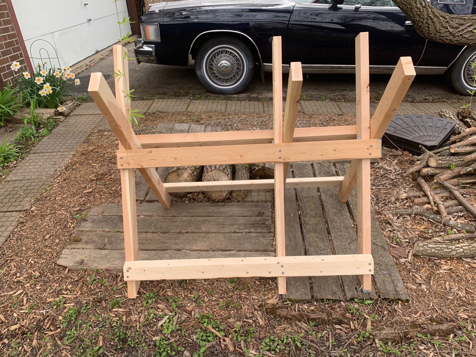

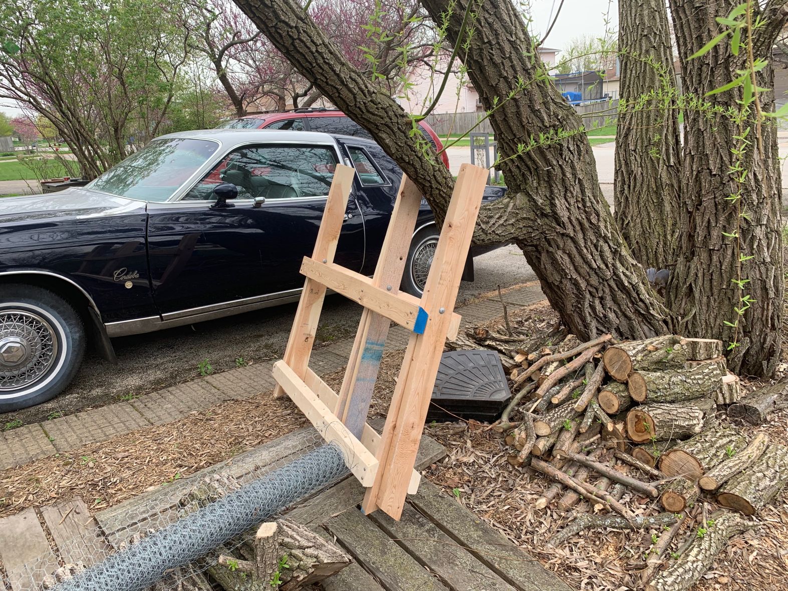

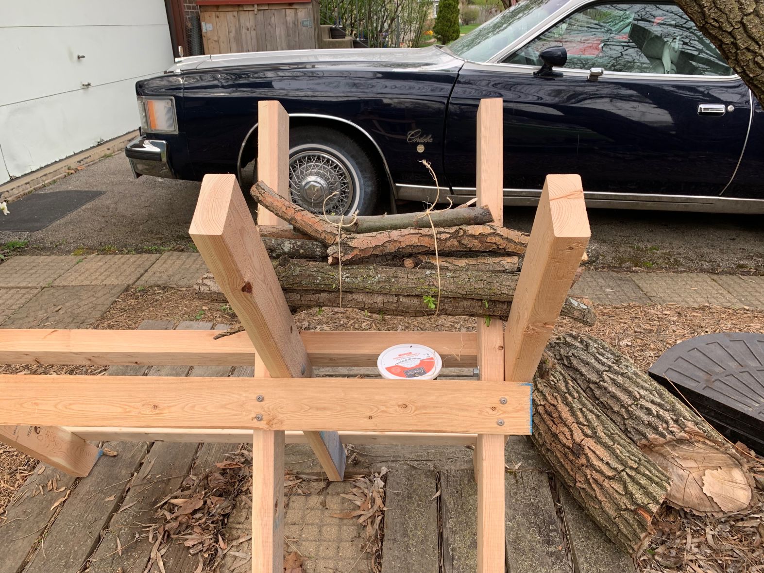

Anyway I know have a saw buck.
Mostly as the design showed but I changed a few things on the fly. The angle seems about right so I'm pretty happy with it.
And yes I know, no pictures then it didn't happen........ so the pictures:
And what my wife is looking forward to, having a place to tie up brush for collection.
