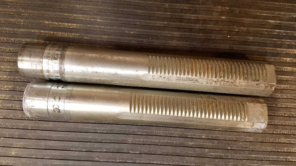

epodietz
Posts: 45
Joined: Tue Sep 28, 2010 11:52 pm
Location: Philadelphia area
Re: Lighter replacement for main table for horizontal boring
Post by epodietz »
I just bought a second tool rest post (along w/arm & tool rest) from ebay and much to my surprise it is shorter than the post I had. They don't dance well together, for my purposes at least. Anyone happen to know when or why they changed? I am wondering if I come across a third tool rest if it is likely to be different than these two...
Shopsmith tool rest posts.
Shopsmith lathe tool rest posts-lorez.jpg (152.07 KiB) Viewed 11762 times
