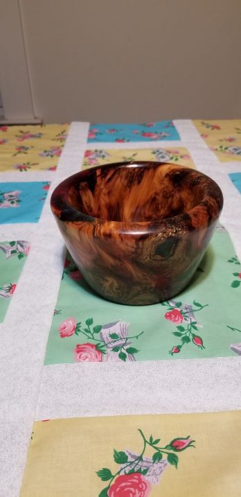

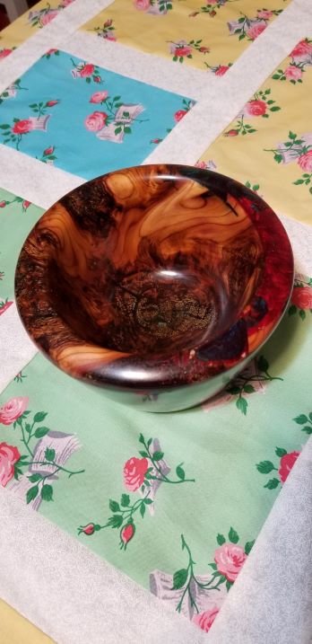

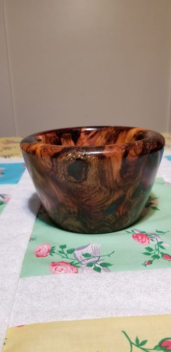

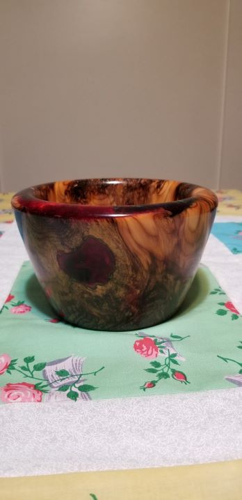

Thought I would share my latest project. I turned this bowl from a Yew root ball. I cut the bush down 18 years ago, and dug up the root ball 5 years ago. I stabilized it with Cactus Juice, plopped it into a mold, and through several pours, filled the voids with Alumilite resin of several colors. This piece was hard as stone, literally! It had sand and stone embedded in it. I destroyed at least 5 carbide inserts (have to call Cap'n Eddie and restock!)and shortened a few bowl gouges. In the end I am quite pleased. Finished with Ack's Sanding Paste (a new sanding paste that I really like) and Shine Juice.
I will release a video after I edit what has to be 20 hours of turning into a watchable length!

Gorgeous! I had to Google what Cactus Juice is since I am new to bowlturning...

That is stunning!

nice!
Posts: 3815
Re: Root Ball and resin bowl
That’s a fabulous bowl, Chris ... it looks like it’s made from nice big burl! How big is it, anyway? Amazing that it didn’t rot after 13 years in the ground.

Yew did a great job, Chris. It's gorgeous.

I never cease to be amazed by the variation in grain structure of root and crotch stock. I never turned root stock but I have turned crotch stock and either of them are VERY hard. The twisted grain makes it extremely difficult to keep the tools under control. But, Chris, you did a magnificent job.
