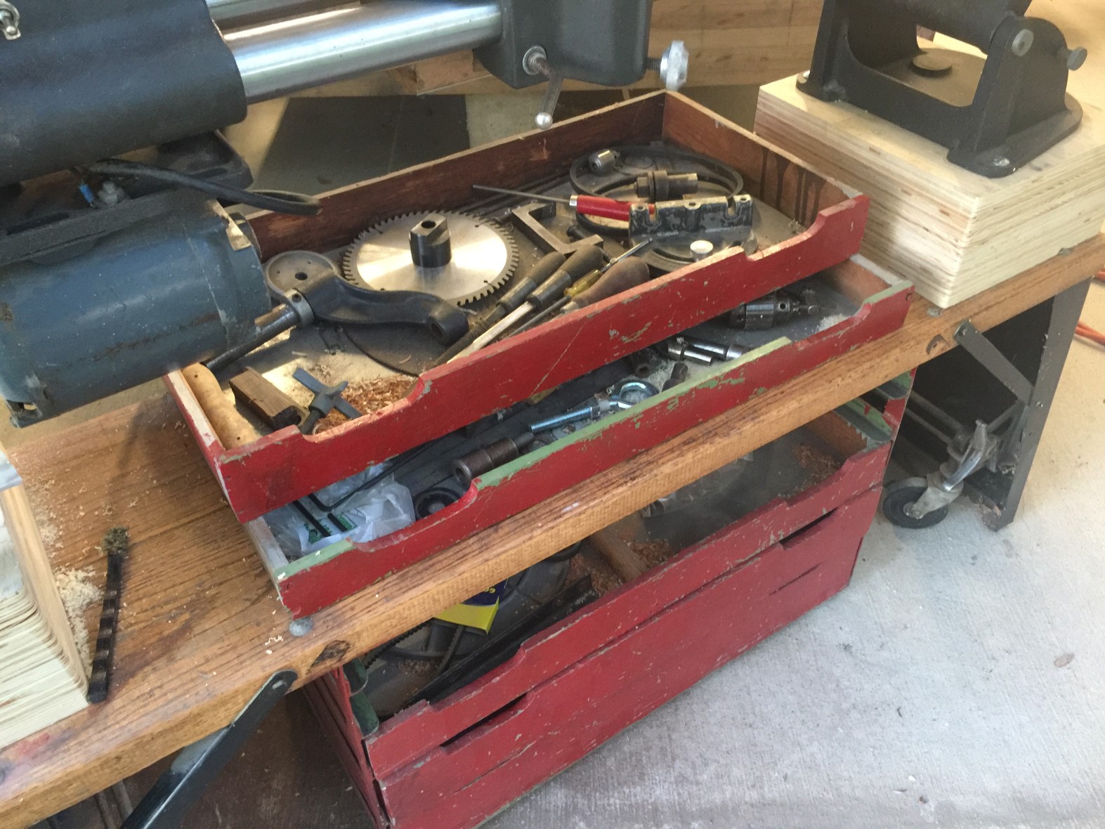

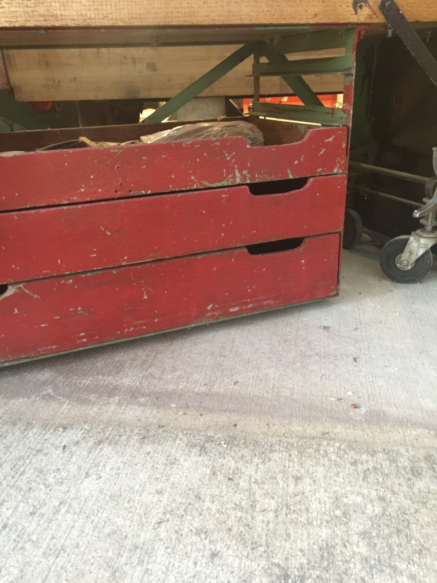

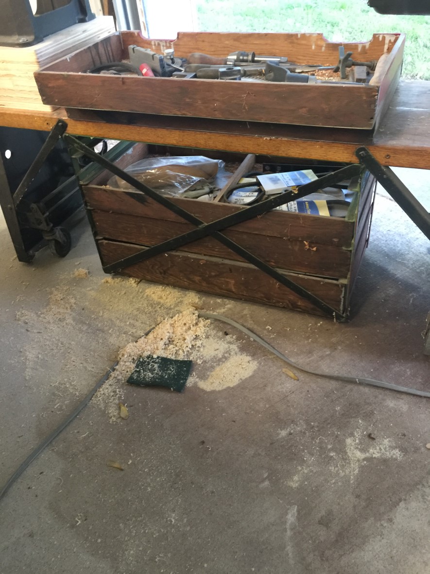

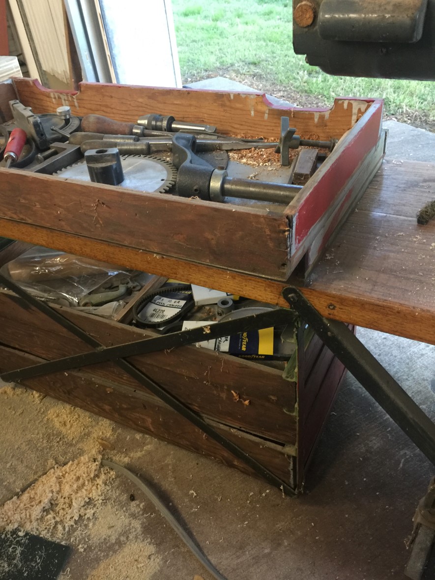

Here's a few pics of the hanging drawers on my 10ER. A PO did a good job. The drawers are 3/8 plywood w/butt joints and the bottoms are sheet metal that is nailed to the sides. The sheet metal slides good on the angle runners. Note the X brace on the back. The sheet metal on the biggest drawer on the bottom is coming loose at the back, the nails are loose. I don't know when they were built but they have held up well.
Farmer, you probably already have everything in your shops to knock this out without spending any hobby funds :D Oh, and pardon my mess :o
Cheers!

Sheet metal bottoms
Sheet metal bottoms

Drawer construction
Drawer construction

X bracing
X bracing

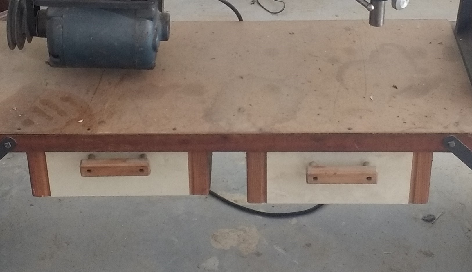

Here are the drawers on my ER.
