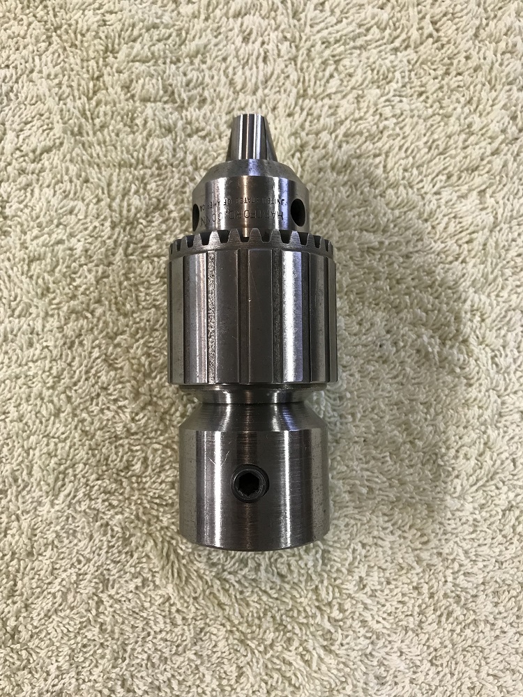

The Drill Chuck that originally came with your Shopsmith was the Jacobs 33B with the adapter shown below.
Jacobs 33B Chuck with Adapter 102-47
102-50 Jacobs Chuck with Adapter Assembly r.jpg (382.56 KiB) Viewed 19324 times

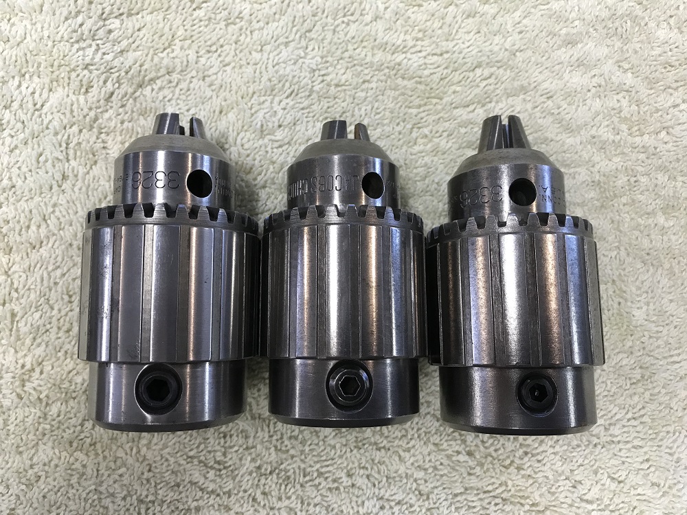

This Drill Chuck assembly was replaced by the Jacobs 3326 Chuck, with a 3/8" set screw, which attached directly to the Shopsmith's spindle without an adapter. Later with the introduction of the Mark 5 the set screw was change to a special 3/8" set screw using a 5/32" Allen Wrench and later to a 5/16" set screw. With the introduction of the Mark 5 all possible set screws were changed to ones using a 5/32" Allen Wrench. Below is the three versions of the 3326 Chuck. Note the set screws.
3326 Chucks.jpg (355.12 KiB) Viewed 19324 times
Of course any Drill Chuck made for the Shopsmith's over the years will fit. This includes the Cushman Chuck, the Jacobs Multi-craft Chucks and the current Shopsmith Chuck.

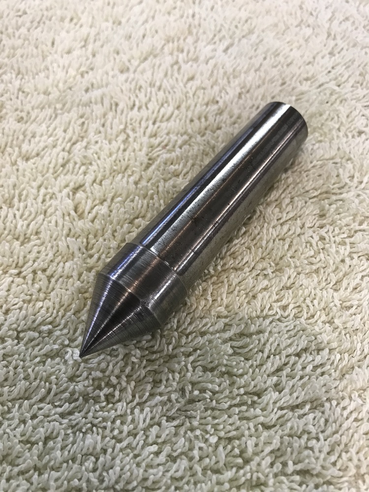

As for the Tailstock Live Center it was an optional accessory. Your 10E came with the early 60 degree Dead Center shown below. Later the cup dead center replaced it. The same is true for the Live Center, first a 60 degree version and later the cup version.
