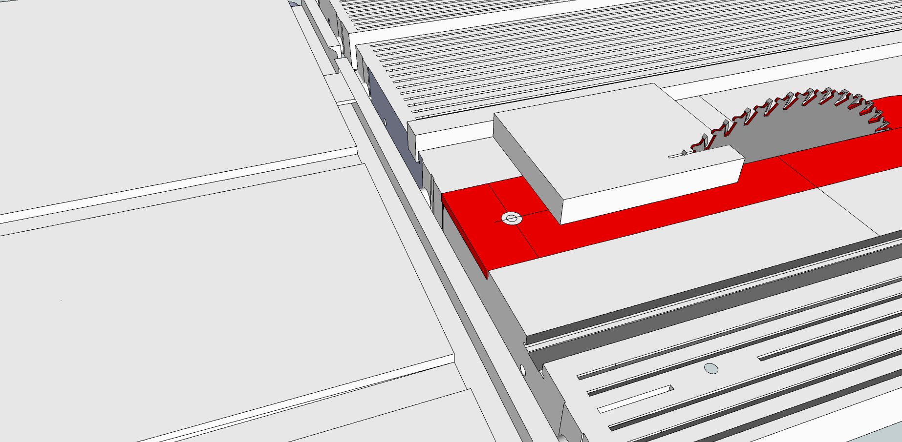

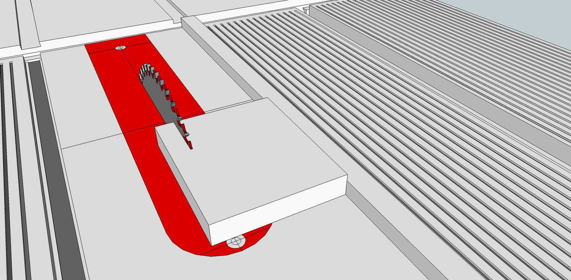

As a "Quick Check" for table to blade alignment I use a couple pieces of wood. One piece has been milled to fit snugly in the miter track. The other is ripped a short way (as shown). After ripping this, TURN OFF THE SAW and flip the just cut piece end for end and check to see that the block slides easily into the blade on the outfeed side.
Initial Cut
Initial Cut
Cal Block 1.png (139.01 KiB) Viewed 17597 times
Verification Check
Verification Check
Cal Block 2.png (95.99 KiB) Viewed 17597 times
With my set up, the left edge of the cut will be 3 1/2" from the right side of the Calc Block when the quill is fully retracted. This dimension will vary depending on how you have done your table to blade alignment and how your quill is set. When I perform a complete table alignment, I strive for this consistency.
Incidentally, that blade face will be on the center line between the two miter tracks.

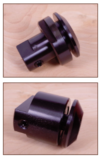

The traditional saw arbor that comes with a Mark V (500) or Mark V 505, 510, 520 or Mark 7 uses a blade with 1 1/4” hole. There is a physical difference in the 500 and the later that have to do with the size of the larger worktables and the offset each needs. You certainly can buy excellent blades from Shopsmith in this size.
They are aware that most 10” saw blades are standardized around a 5/8” size hole for other products.
They also make arbors for 5/8” holes, and once again there is a 500 version and a later version for bigger tables with a different offset. Both have the beef to help stabilize the rotating blade and make cuts cleaner.
They are:
555608 5/8" Saw Blade Arbor (for MARK 7 and MARK V Models 520,510 and 505) ... $31.99
555321 5/8" Saw Blade Arbor (for MARK V Model 500) ... $31.99
Like most I have some special 5/8” blades that I move from my Shopsmith to my Miter Saw from time to time.
Having the proper 5/8” arbor will save you when you have to have a new thin kerf blade for a special project and need to buy locally, today.
