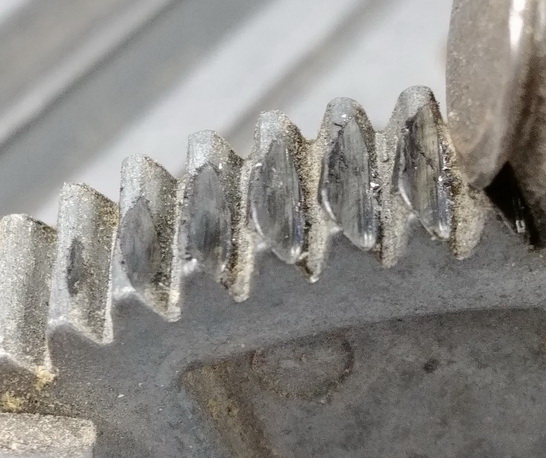

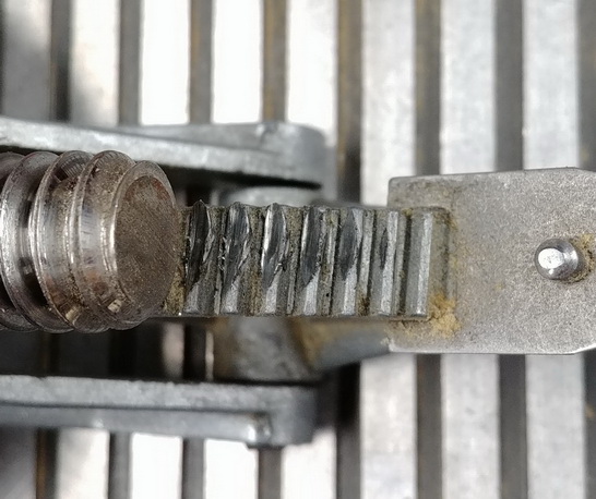

Another newbie question-- It turns out the speed control dial on my recently acquired 1989 Mark V is harder to turn than it should be. I didn't figure this out until I had the chance to try another Shopsmith some days later on which the speed adjusted noticeably more easily. Could somebody advise me if the amount of damage visible on the teeth of my quadrant assembly would explain the difficulty in adjusting the speed? The dial turns easily when the speed control is removed but presumably things are different under load.
Is this damage to the teeth likely to be the only issue or a symptom of a bigger problem?
And, to replace the quadrant (I have a spare) how do I remove the black pin that holds it to the speed controller body?

The pin that holds it together can be driven out. Just be sure to support the assembly so you don't break it.
One bit of advice. If you replace the quadrant gear, also replace the worm gear at the same time. When one wears, both wear and putting a new gear in with an old gear will most likely make it worse instead of better.

Keep in mind that there was a cause for the excessive wear on the quadrant gears. Generally poor lubrication is the problem. Check the motor and idler pulley sheeves to make sure they are properly lubricated and moving freely.
Re: quadrant assembly help
That wear(all too common) is I believe the result of too fast adjusting the speed towards slow. That is exacerbated by insufficient lubrication of the floating sheave on the motor shaft.
Needless to say, adjusting with the pulleys NOT turning is the worst case scenario.
The floating sheave MUST move outward and keep up with the control sheave moving closed to prevent that stress/wear to the teeth.
