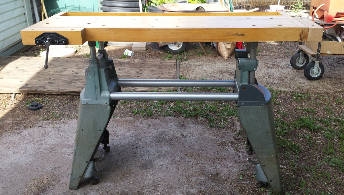

A while ago I acquired a greenie tube and leg set from my father-in-law along with his Mark VII, and I'd been musing on what to do with it. This past weekend I picked up a small carpenter's bench, and it occurred to me that the Shopsmith carriage could be useful. I'd like to see what you've built with Shopsmith parts that isn't a Shopsmith.
- New bench small.jpg (823.4 KiB) Viewed 38171 times

Steven,StevenAyres wrote:A while ago I acquired a greenie tube and leg set from my father-in-law along with his Mark VII, and I'd been musing on what to do with it. This past weekend I picked up a small carpenter's bench, and it occurred to me that the Shopsmith carriage could be useful. I'd like to see what you've built with Shopsmith parts that isn't a Shopsmith.
Cool idea...I like it. How hard is it to adjust the height? Wondering if it would be useful to install a carriage in the middle to have a crank for adjusting the height, but then the carriage might not be strong enough since you have a beefy top.

Raising the height is a matter of a little up on one side, a little more on the other, definitely not one-touch, but the table isn't as heavy as it looks. I considered the center-carriage idea with the side-table tubes, which would probably work pretty well if placed at the table's balance point. But I decided that the additional pair of tubes and carriage would eliminate most of the under-table space, and I'm thinking a set of tool drawers there will be handy.RFGuy wrote:How hard is it to adjust the height? Wondering if it would be useful to install a carriage in the middle to have a crank for adjusting the height, but then the carriage might not be strong enough since you have a beefy top.
I was also much attracted to the idea of setting it up for flipping the table vertical, which could be useful for some of the things I do. But the best way I could see to get there would be two table carriages rather than the side-table tubes, and that would significantly reduce the span between table supports.

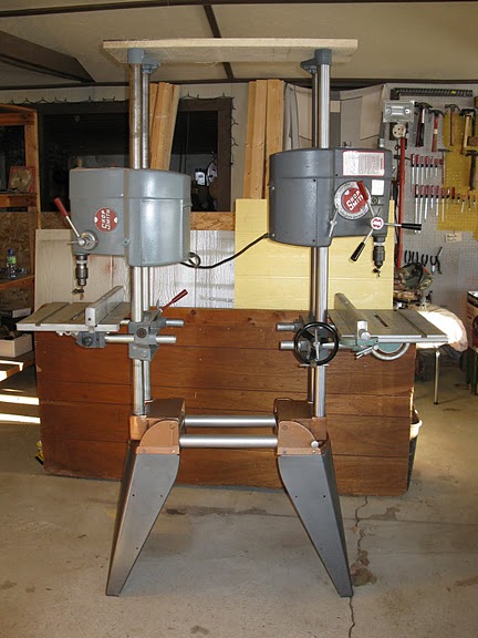

Here is a project from a number of years ago. I call it my "push-me pull-me double drill-press" (Dr. Dolittle). I've not done much of anything to it since I built it. I did put an SS caster set on it. I use it regularly, often with a different setup on each side.

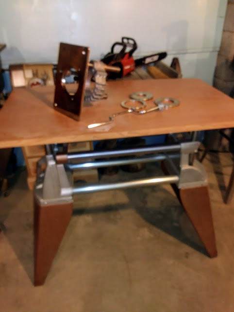

This one is a router table I'm slowly working on. I also have an SS caster set for it. I think I only have one extra set left now. I need to get back on this project and finish it up. I do have a couple of bench router tables that "function" but neither would win any prizes.

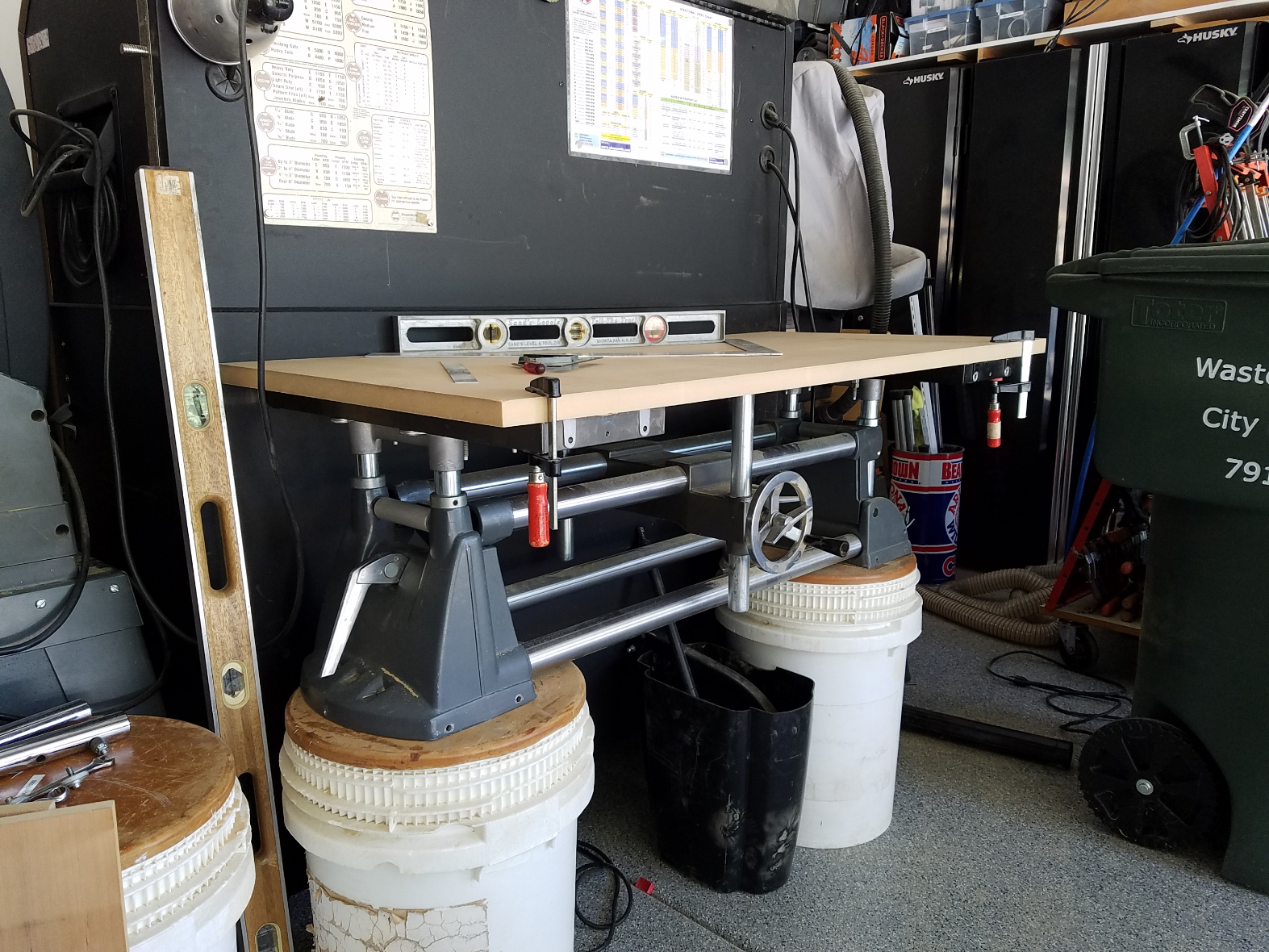

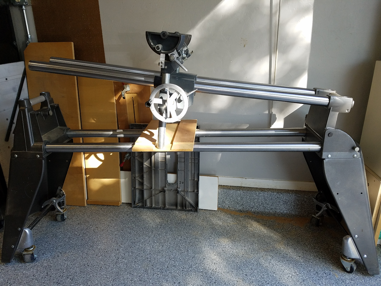

You have done just that. I now have my Shorty converted to an adjustable height work bench and the cabinet full of miscellaneous parts rebuilt as a standard configuration Mark V Model 520. Thanks for the push.dusty wrote:Steven,
I think you might have just resolved my dilemma for a work bench. I have all of the required parts with the single exception of tubes.
I've got to give this some serious consideration.

Looks good! How well does the center-lift idea work?
