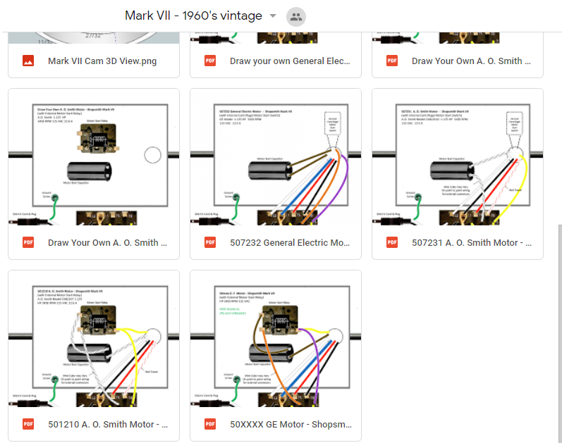

everettdavis
Posts: 2163
Location: Lubbock, TX
Re: schematic diagram
Post by everettdavis »
If by chance you need the wiring for the Mark VII opposed to the Mark V - I have those posted in the Mark VII folder under the My Google Drive link at http://www.shopsmith.com/ss_forum/viewt ... 90#p185690 as well as a fully restored Mark VII manual.
Everett
Mark VII Wiring on My Google Drive.png (176.7 KiB) Viewed 10522 times
