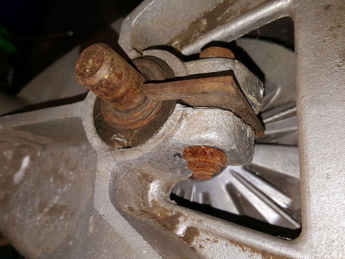

thunderbirdbat
Posts: 842
Location: Marion, Iowa
Re: Help Identifying Shopsmithh Headstock
Post by thunderbirdbat »
SaShepherd wrote:Thanks for your response. How can I tell if it is a 510 rail system vs 500? I wish I had taken pictures to post here but didn't think of it at the time.
Ok I just found a section with detailed images of the 500 table. It's definitely a 500 table system but I still don't understand the headstock having the large red switch if it is a machine from the early 80's.
Like the one my son got it probably had a problem with it and the headstock casting was replaced. It is common for the headstock casting to break if someone over-tightens the screw that holds the idler shaft in place, similar to in the picture.
