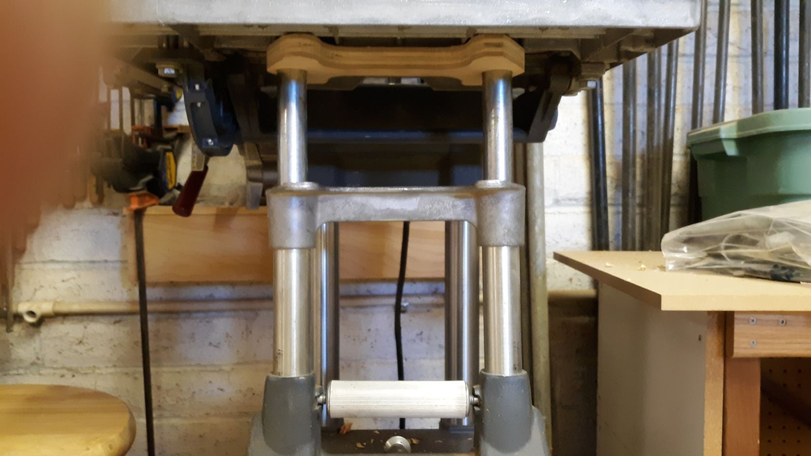

so the dedicated SS drill press is still new to me, so I am not sure what I will need in terms of table height, and I don't want to waste money on something I won't use.
I like the idea of the table support using a couple of extension tubes and wing. But it was too low for everyday use. While I never needed or wanted a support when I changed over my SS, I kinda like it.
So I added a couple of pipes that slid down the extension tubes, added a top brace, now my table support is at a good height.
With the 4 inch quill reach and my sacrifice board I always use on the table I think this will cover most of my drilling.
If not, then a rethink will be in order.
- upper stands.jpg (164.31 KiB) Viewed 31425 times
