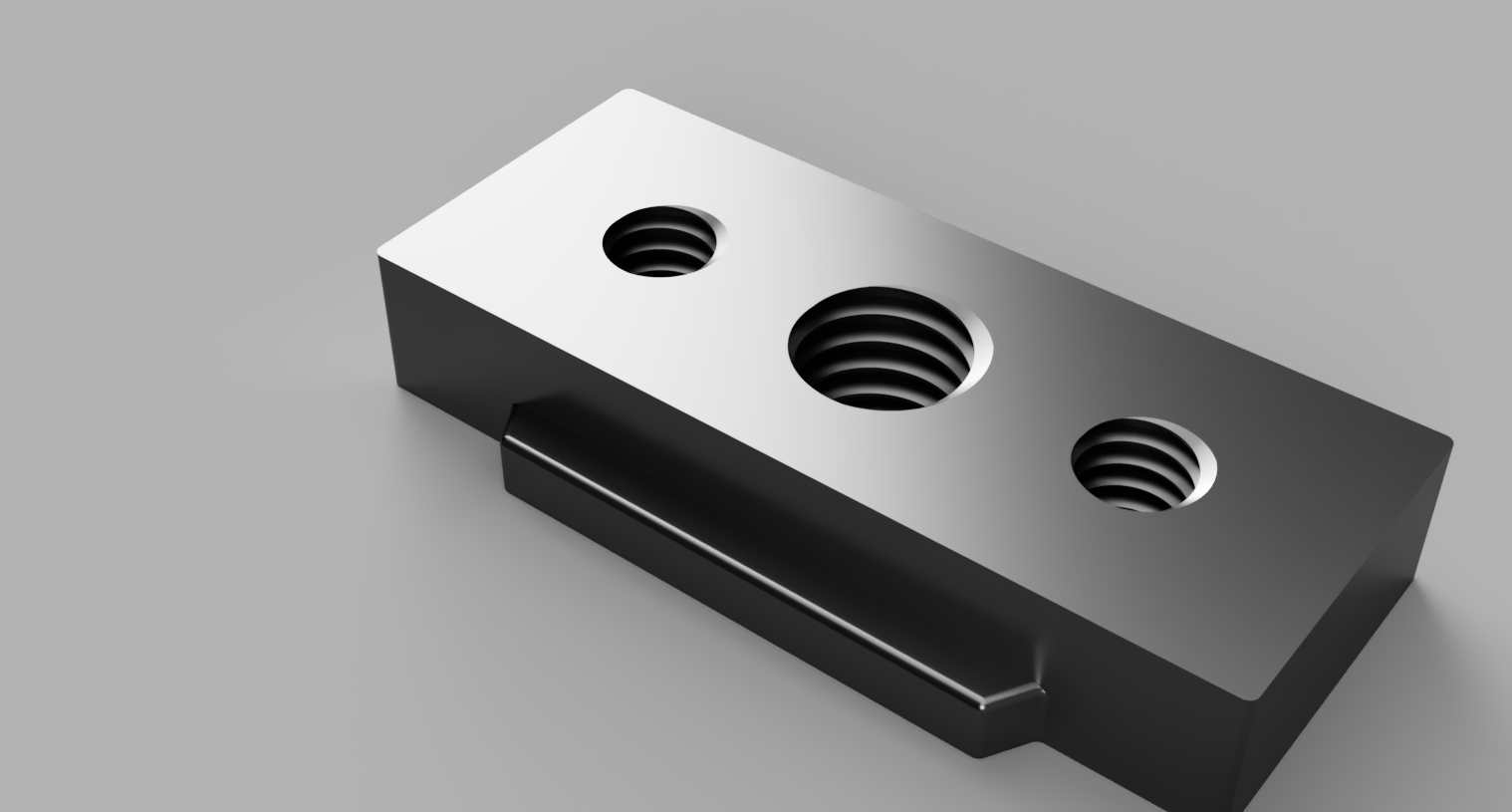

And here's a T-Nut design. Prints out great in PET with the threads! Obviously unwise to torque it down with gorilla force, but ok to snug up a fence. My Slicer says $0.13 each, so the price is right and they are practically disposable - if I strip one, I can make more. Or embed a nut in the back if that gets frustrating.
https://a360.co/2FRkkzA

Wow, pretty cool. Waiting for you to 3D print an entire Mark 7 Power Pro....
