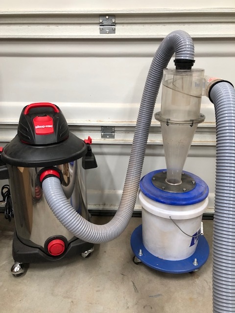

Personally, I haven't been able to afford a "nice" dust collector yet for my shop. When I do, I want to mount it outside and protect it from the elements (to keep noise out of the shop and save much needed floor space). I have a Shopsmith DC3300, but it is under powered and only gets down to 1um filtering with the large dust hood, but it still leaks some dust. My interim (bandaid) solution is to use a good quality Shopvac vacuum (6.5 peak HP) connected to a ClearVue CV-06 Mini cyclone instead. At the Shopvac inlet, I get 6000ft/min air speed. The cyclone cuts this down (restrictive), but I still get 4000ft/min at the end of a 12' long 2 1/4" vacuum hose that connects to my Shopsmith. If you read Bill Pentz' dissertation (http://billpentz.com/woodworking/cyclone/index.cfm) on dust collection, you know that 4000ft/min is the range that is expected to carry large shavings and dust from the jointer, planer or table saw down the hose and back to the cyclone (so they don't clog or settle out in the ductwork). To keep exhaust dust to a minimum, I run HEPA bags and HEPA filters on my Shopvac. Using this setup, I record no rise in ambient level dust in my shop using my Dylos (see pic below) air quality meter while jointing or planing (which means it is working well). Table saw does release some dust due to problems with the guard design, but using a ZCI insert it is minimal for me. For most operations in my shop I can keep dust counts under 100-200ppm for <0.5um particle size while working.
I mention my setup, because it might be a good enough (and cheap) solution to get you by for now until you figure out what to do. These are small enough that they can easily fit under a bench, or be stacked to take up minimal floor space. My setup cost only $200 if you count the vacuum and cyclone, less if you already have a Shopvac. As an alternative I have heard good things about the HF DC. You can get it on sale for $160, but you do need to add a Wynn HEPA cartridge filter to it (about $200 I think), but you also need to add a cyclone like a Super Dust Deputy or some other 4" size cyclone. So, even though the HF DC is cheap, to get a good functioning dust collector out of it, you are looking at close to $1k to properly set it up. Without a good quality (<1um filter rating, preferrably <0.3um) filter on the exhaust all you are doing is recirculating dust in the air and making air quality worse for yourself. Another option is bypass the hood/filter and vent the exhaust directly outside (will create a pressure differential in your house and lose any heated/cooled air though).
The downside of my temporary ShopVac setup is that it is not meant for continuous duty. ShopVac motors are tiny and the blower is designed for suction, not airflow. If the ShopVac inlet (or exhaust) gets too restricted or blocked off, or you want to turn and/or sand your woodturning for hours on end, then my setup will burn up (literally). Only a true dust collector is meant for continuous duty use for woodworking. Again, my setup is TEMPORARY, but is saving me lots of money right now so that I can save up for my dream dust collector system that will be mounted outside of my small shop.
Keep in mind large (high CFM) dust collectors exist to move large amounts of air down the ductwork which is lossy. Your shop is probably too small to consider ducting, so directly connecting to each tool is probably good enough (hence lower airflow blower is "ok" with adequate filter). Whether it is a vacuum or a dust collector, as long as you get close to 4000ft/min at each tool, then that is all that matters (provided the exhaust filter doesn't release all the dust back in the air). Bottomline it is hard to justify a large DC in a small shop (in my opinion)...even though I want one.

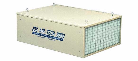

For me, for now, I can live with a Shopvac, but it requires running a HEPA bag and HEPA filter on it AND a cyclone in front of it so it doesn't quickly clog up, i.e. airflow stays high. Downside to it, is I really can't let it run for say an hour while sanding a woodturning. Shopvacs are made to turn on, for maybe 5 minutes and turn off. They will overheat and thermal limit, whereas a dedicated DC is meant for continuous duty. Some day, when I can afford it, I will get a large cyclone DC and mount it outside my shop. It will be overkill for my Shopsmith and needs, BUT it will be needed somewhat to maintain the required airflow over the length of duct, especially the verticals that I intend to install. It is a "want" and a "nice to have", but I can't afford it at this time. My DC3300 was insufficient for me, but the Shopvac+cyclone has made a world of difference in my shop, but it has limitations.
Sorry for all of that, but just wanted to make sure that I clarified a few points from my previous thread. Now, to answer your new question. Yes, you will need some alternative air cleaner in addition to the DC. In an ideal world if you have good dust capture at every tool and a good dust collector with excellent exhaust filter, then you would NEVER need an air cleaner. We do NOT live in an ideal world. I have a JDS Airtech 2000 hanging from my ceiling. There are lots of other brands out there, Jet, Powermatic, etc., etc. These go for around $300 or more. Basically just a good quality filter(s) with a squirrel cage blower in it to scrub the air. If you can fit one of these great, but if not an alternative and cheap solution is to go buy a $20 box fan from anywhere and get a pleated paper air filter (like you get for HVAC system). Buy a good size to fit the box fan and attach it to the inlet side of the box fan (bungee cords or however you want to attach it). Running this in the background all the time will scrub the air and can quickly get better air quality in your shop. You really can't use the Shopvac for this because it has a small air inlet which means it would take a long time to cycle the air in the shop, but you can't run a Shopvac all the time either or it's teeny tiny motor would burn up. Larger DC's can do a similar function if you leave one port open to suck in shop air to clean it, but it takes them a much longer time to cycle the air than a JDS, Jet, etc. air cleaner. Bottomline is for sanding in the shop (hand or power tool), you really need an air cleaner in addition to a DC. Unless you are running a Festool sander with a Festool vacuum, just about any variation of sanding will introduce significant dust into your shop and you can only capture so much of it with a DC. An air cleaner is a must IMHO, but presents another challenge in trying to fit it into your small shop...can you mount one on your ceiling or is the basement ceiling short?
