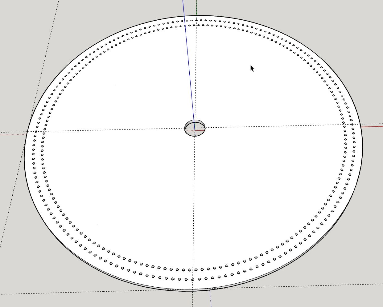

I working on a project that might seem a bit odd at first. A holey disk. It might be though of as an indexing disk but it will serve me as a step towards a drilling jig that I want to make.
It will be 10" in diameter with 360 holes, ie one for each degree of a circle. So any angle that is a whole number would be possible. Depending on how this goes I might make another disk with say divisions of 7, 11,13,14,16,17, and 19 or perhaps some sub set of that.
The center hole is 5/8" and the other holes are 1/16" arranged as 2 arrays as seen here:
ScreenHunter 159.jpg (91.48 KiB) Viewed 24986 times
I plan to use my Shaper to cut the whole thing. It is going to be a lot of effort with that many holes.
The results should be reasonable but I don't expect the accuracy to be perfect, but it doesn't need to be either.

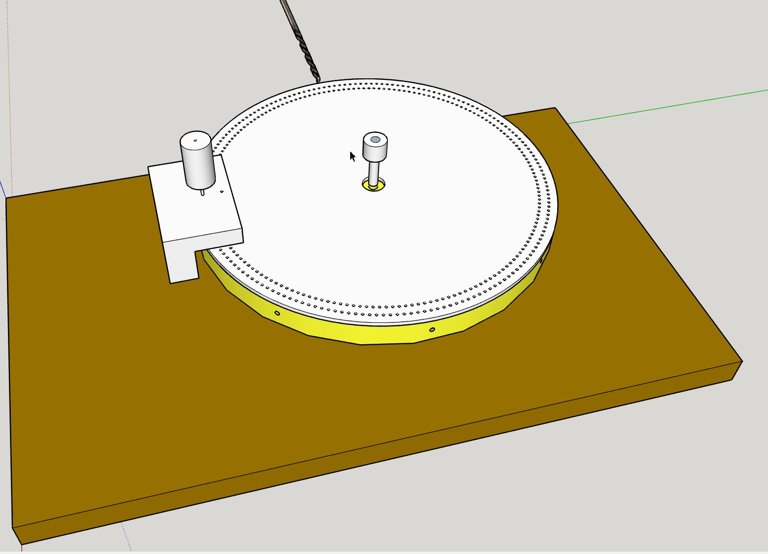

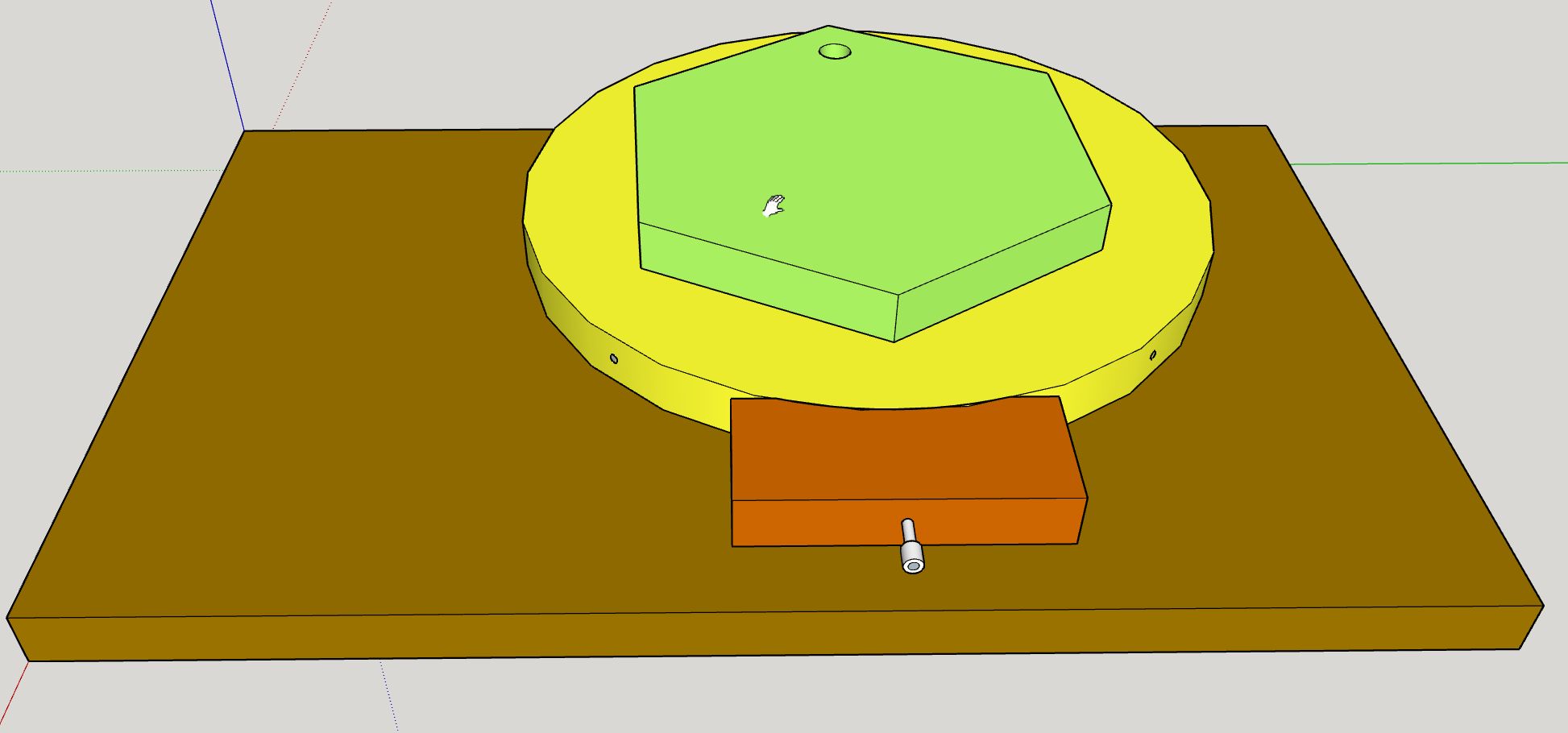

Here is a bit more information on how I want to use this. Perhaps a sketch or two might be useful. First this is disk will be used to make other fixtures hence the large number of holes. An example might start with conversion of the hole pattern for jig that could be used in a horizontal drilling operation.
The first task is using this disk to make a jig for say 8 holes. The set-up would look something like this:
ScreenHunter 161.jpg (91.19 KiB) Viewed 24859 times
The resulting jig could then be used for a vertical drilling operation as seen here:
ScreenHunter 162.jpg (71.18 KiB) Viewed 24859 times
It could also be used to generate index disks for lathe work. Hence the mention of adding a second disk with the "odd" numbers of segments like 7,11,13....

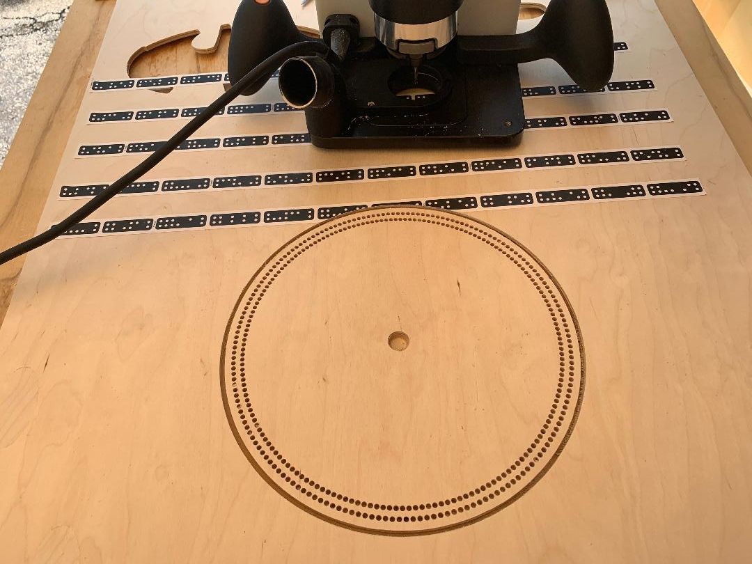

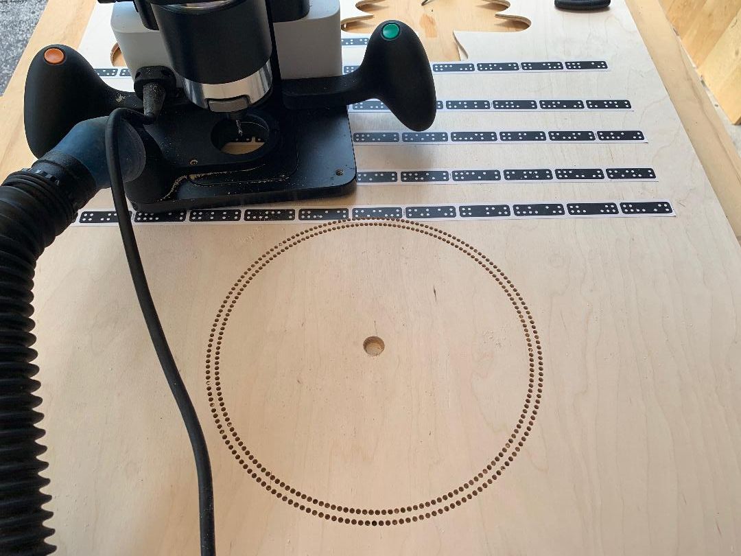

361 holes in 1 hour 4 minutes according to my stopwatch.
I had planned to use a plastic but the only piece that I had that was of the correct size turned out to be less then wonderful to work with. Can you say it melted??? I can. I played with router speed, plunge speed and after very poor results I moved on. So it's BB plywood.
The other change I made was to change to a larger hole but I did that by telling the SO I had a smaller bit and it believed me silly machine. I will not get into this other then to say it worked.
And so you know it really happened:
This is when the holes were finished and I stopped the stop watch. I still needed to make it into a disk. And yes that happened too:
This part of the project is done. Not sure when I will get back to the next project where I use this but for now I'm glad to have this part done.
