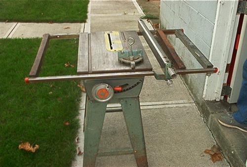

You mention the Magna Table Saw in your last post. Are you referring to the Magna Line 710 Table Saw shown in the picture below?
710 Table Saw.jpg (32.28 KiB) Viewed 36813 times
I an not positive but I believe it uses the same Miter as the Mark 5 as both were being made at the same time in the 1950's.
