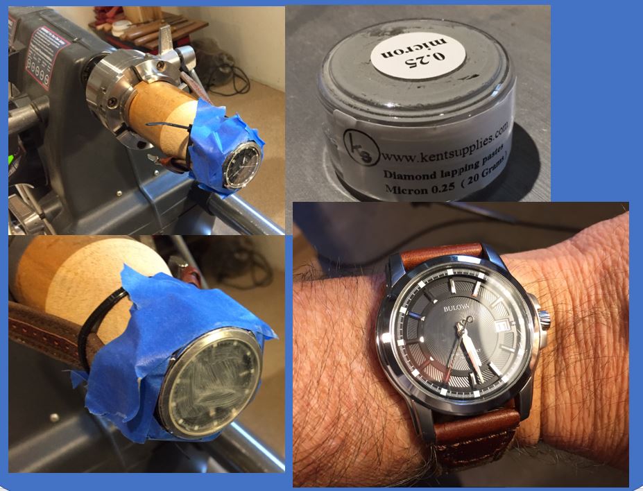

In the past month I got 3 'pawnshop e-tail' Precisionists:
(1.) as shown above with black leather strap, very nice
(2.) a Dud which won't be worth fixing
(3.) another one like (1.), but with a tobacco-infused strap and a very scuffed-up face and body.
I actually got some Diamond-paste to have full possibility of buffing the sapphire crystal; as it turns out the crystal scratches were too deep to get rid of all of them readily. Nonetheless, the metal sections polished up very nice! I used a few slow RPM settings on the Shopsmith. By keeping the (new brown) leather straps on, I was able to nicely tie the watch up to a piece of wood in my chuck:
Not too bad, now!

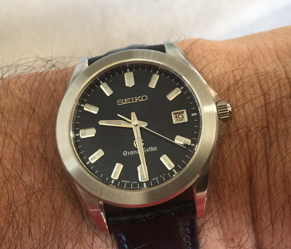

My appetite was whetted for the black-hole-like attractions of HAQ (High Accuracy Quartz) watches.
I took a gamble on an older GRAND SEIKO quartz model on the auction-site, a model never sold directly in the USA. These are high-end watches that depreciate faster than the Swiss brands, but they are doggone nice!
This one, I used a tiny patch of 600-grit sandpaper to re-apply some nice concentric brush marks on the round bezel ring (it was a nicked-up piece that was originally brushed rather than bright-polished). Right on the lathe-chuck I could see progress and was encouraged. I decided to stop a tad early, and take the watch off the chuck and put some microcrystalline wax on it. It did turn out pretty good!
