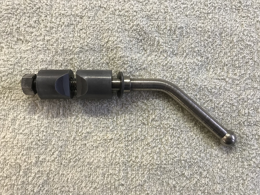

As shown in the ebay ad from karenhenks, which is actually her husband that does the Shopsmith stuff, that is the parts needed for a complete Carriage Lock Assembly. He sells a lot of Shopsmith parts. If you can be patient a cheaper one may come along or try making him an offer to see if he will take less. The picture below shows a better view of all the Carriage Lock parts which are the same as the Headstock way tube lock.

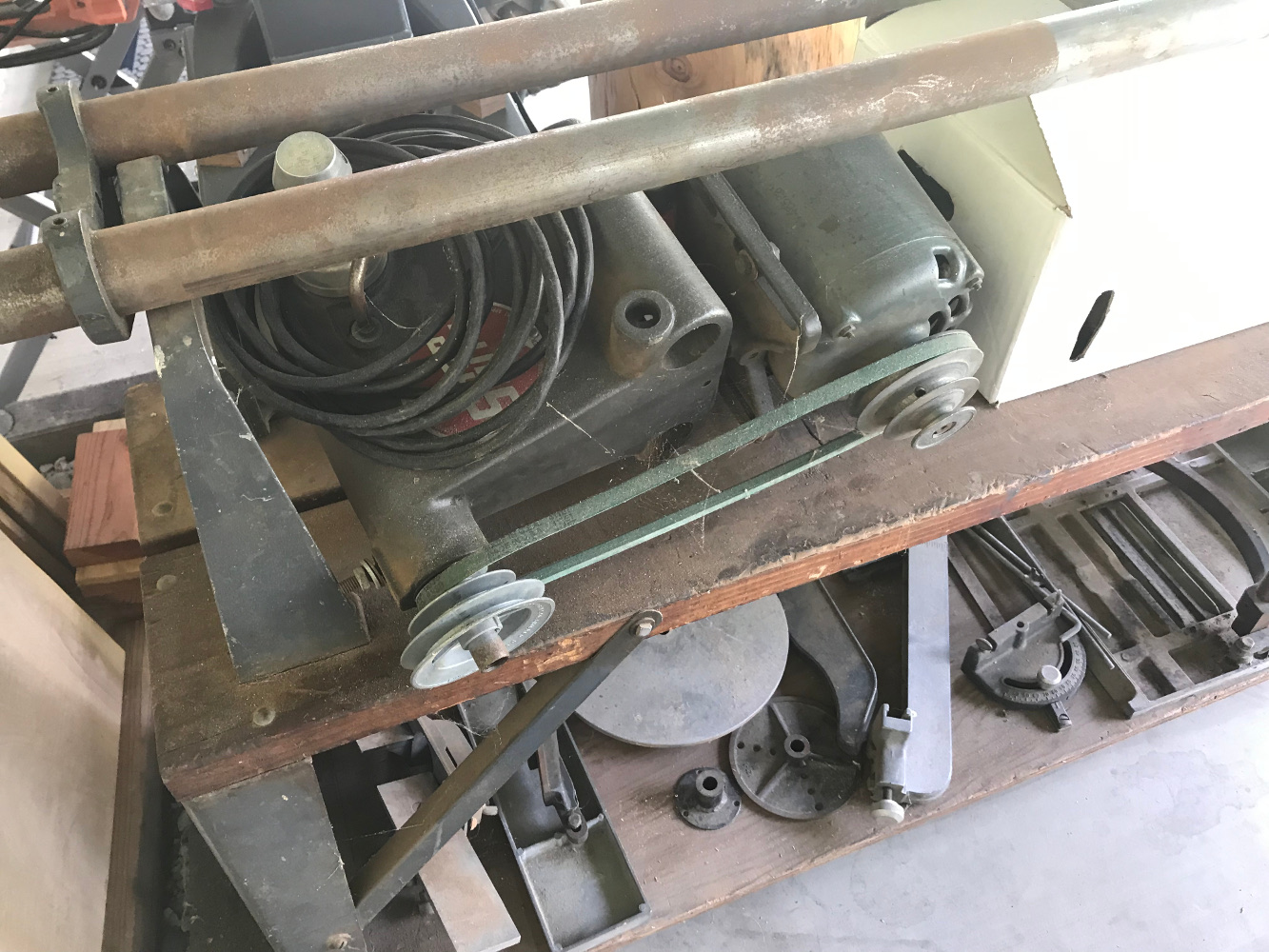

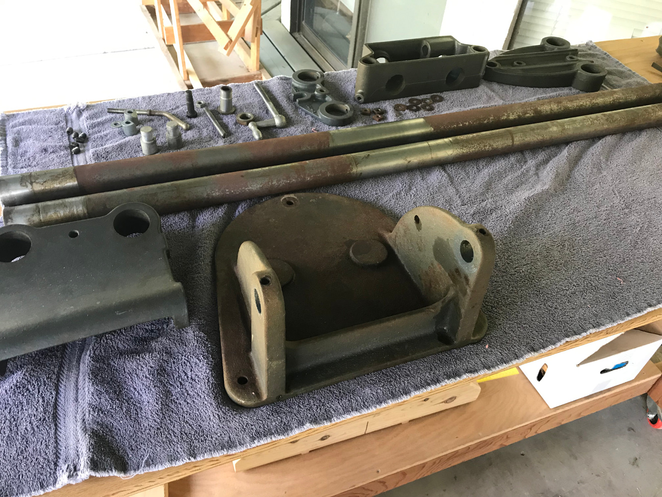

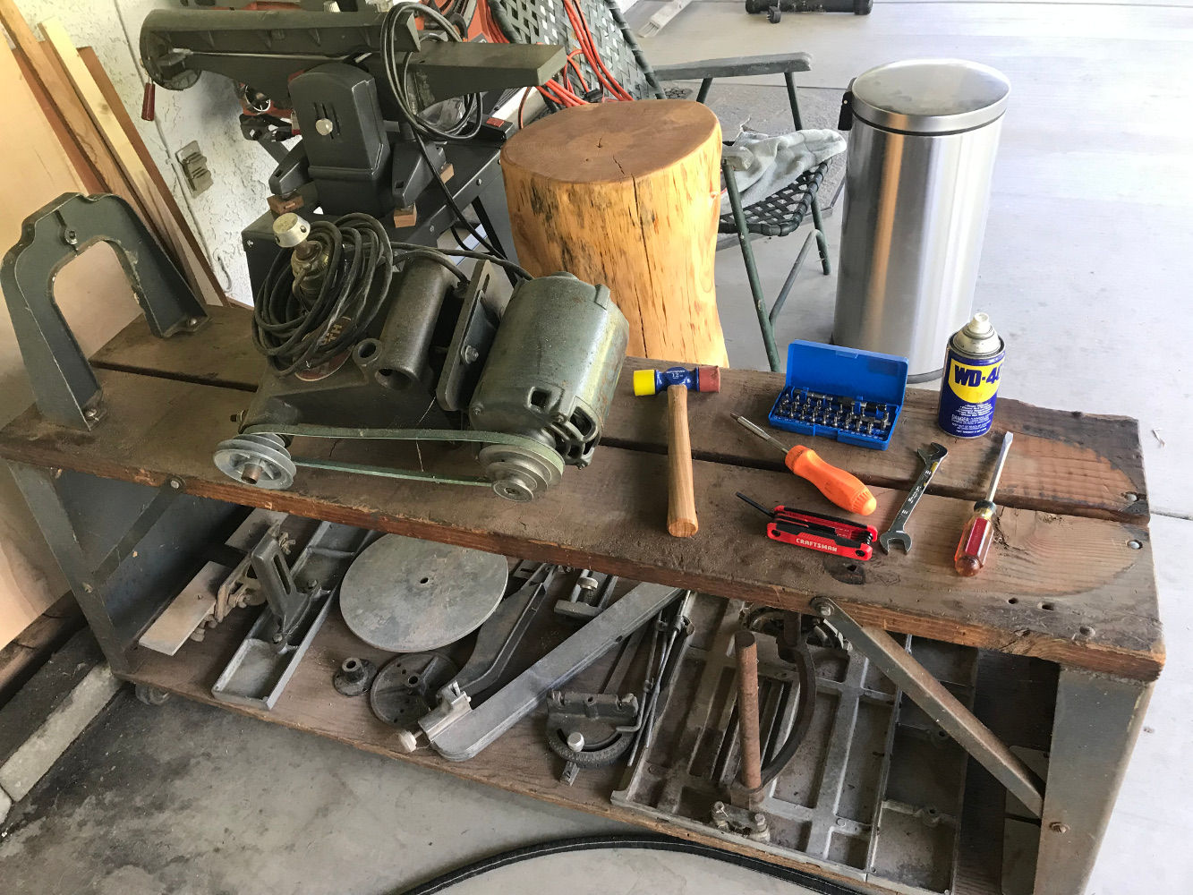

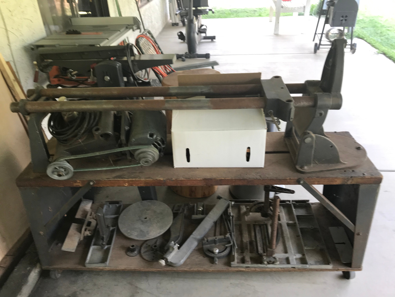

Okay! Those prior commitments are done, I've obtained a couple of replacement parts, and this is Day 1 for restoring this machine. I've never tackled a project like this before, so it's going to be a real "learn by doing" kind of deal. My initial plan is to focus first on the base, then use that experience to clean up the table and attachments, and finally dig into the headstock. Hopefully this schedule will mean most of the serious mistakes get made on the sturdier and less crucial parts.
I'm thinking I'll use this thread to document the whole gradual process. Maybe the record will be useful for somebody else later on.
Day 1 was spent disassembling the base and simply washing off the dirt and grease with soap and water. I want everything basically clean before starting on de-rusting and stripping paint. Everything came apart much more easily than I had feared or expected; a little WD40 and a few taps with the rubber mallet were perfectly sufficient. I ran out of time before I could get the headrest loose. (My schedule lets me work on a project for an hour or two a day.)
What's the deal with the square nuts? Who ever thought those were a good idea? Maybe I'll anger some purists, but I ain't putting those things back on. I'm thinking all new stainless hardware when it comes time to reassemble the base. I suppose that disqualifies me from doing an actual "restoration"... Oh well.
