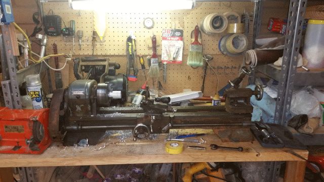

I had a friend of mine in the shop that I helped get set up with a Mark V a couple of years ago and we were making a mirror frame for his daughter and I started lamenting about "the current problem". He looked at me and said, "I will be right back". He comes back in an hour with a 60's vintage Atlas/Craftsman 6 inch mini lathe. All in boxes and a real basket case. He said "here you go, get it working and it's yours".
So I did:

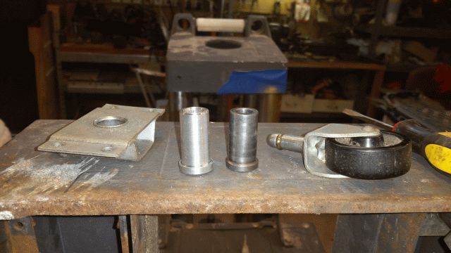

Made one in steel first successfully, but didn't like the work it took (it's been thirty five years since I have even seen a metal lathe, much less did anything with one)
Steel and cast steel side by side.

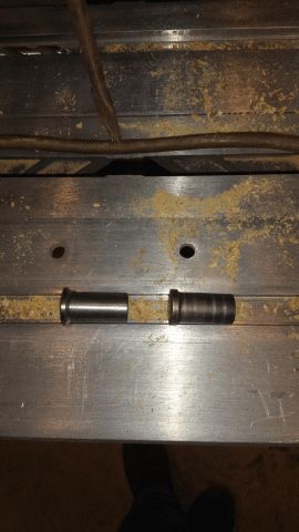

So I told JPG that I was ordering some tempered aluminum round bar stock and I would try some in aluminum for us both to try (the least I could do). I got two made today and hopefully get his other two made tomorrow. I tried the first two and they work perfectly. Time will tell if they hold up.
cast steel and aluminum side by side
