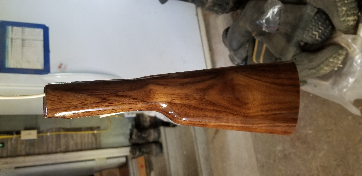

On a recent antique rifle restoration I purchased ready made gun stock for a 1906 rifle .22 cal gallery gun, I was going to make one but by the time I bought the needed bits , the but plate, the screws {sold separately} , and the hrs to do it , well buying a replica stock with the plate and screws sounded good, I mean why not share in some one else having a part in the restoration of such a historical heirloom ,this is a brotherhood just as wood working ,, the sales add said minor tuning needed , no big deal right? when it arrived it didn't really look right ,the grain was too perfect or something was off ,, it looked like the grain on the stock in the add,,nice and straight ,, however it almost looked fake ,,, after the tuning and fitting I noticed where I had to sand and made the modifications there was a large color difference , so I sanded the entire stock , I was amazed at the gran pattern under the stain , color , what ever they had used to cover the grain pattern? why would any one cover such a great piece ? its like putting make up on the Mona Lisa ?
Its all sanded and the tong oil is drying ,it looks more like it would have back in the early 1900''s .

the last coat on the stock was finished using 2500 grit wet sand paper with one coat of danish oil and three coats tong oil than it was 00 steel wool and 2 coats of paste wax applied lightly with 00 steel wool . the front edge was fit using the SS disc sander , the table tilt allowed for a perfect fit .

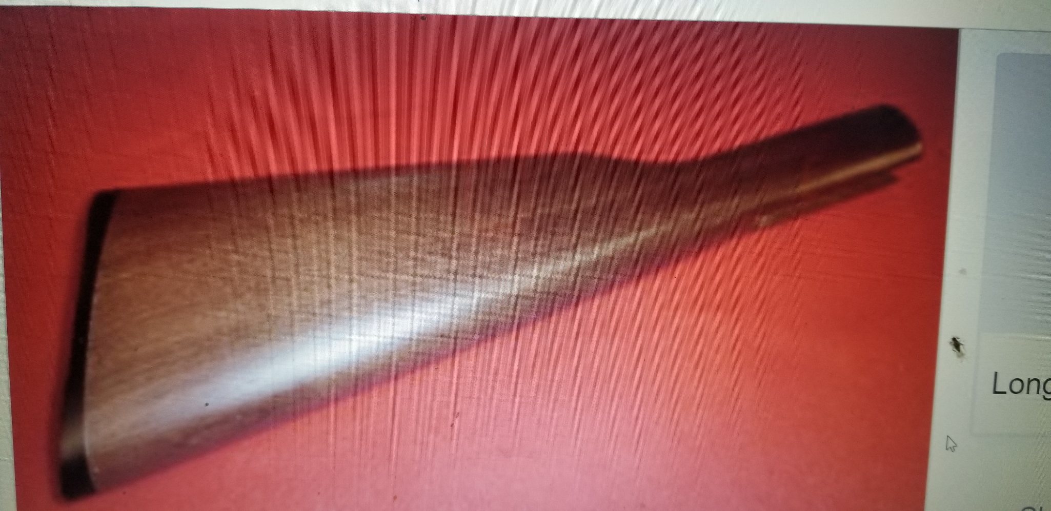

This was the picture in the add as you can see it looks very good, as is , once sanded it took on a completely new look ,
